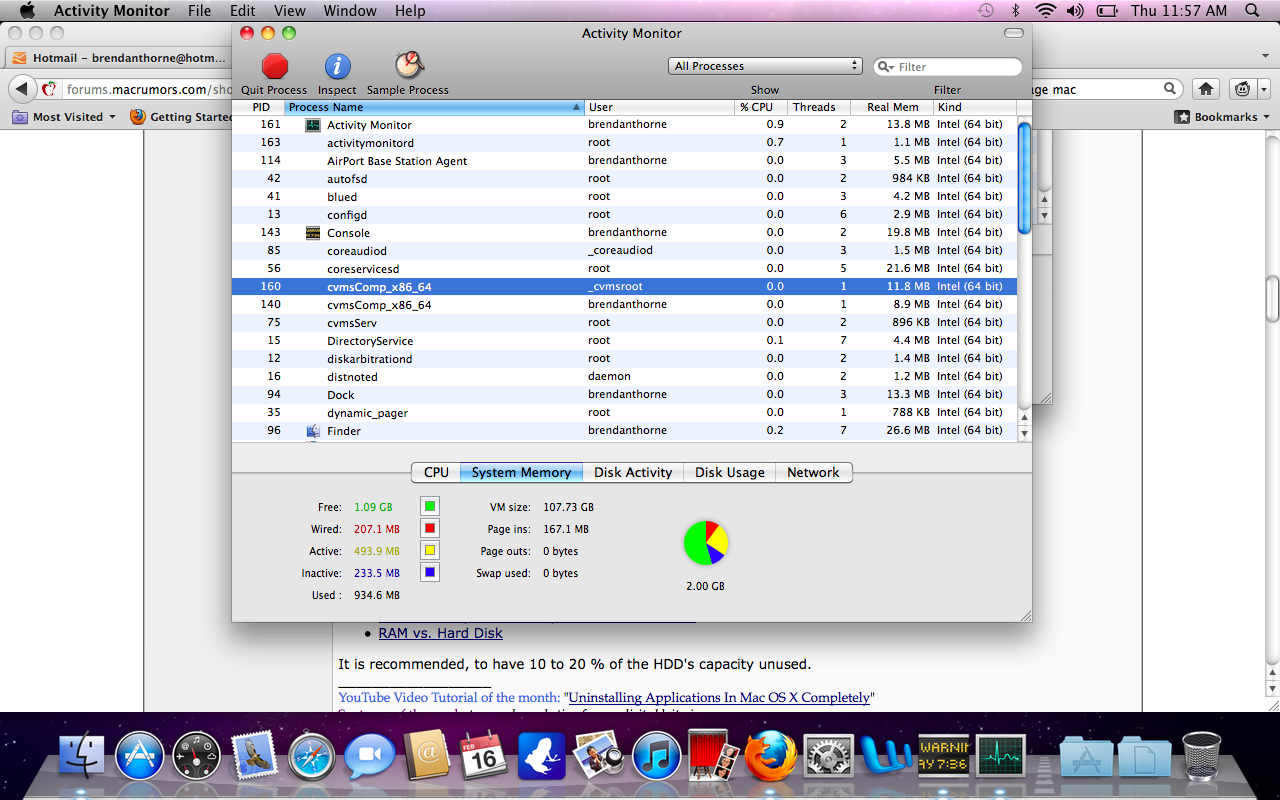

also.. here is a screen shot of activity monitor
Launch Activity Monitor and change "My Processes" at the top to "All Processes", then click on the CPU column heading once or twice, so the arrow points downward (highest values on top). Also, click on the System Memory tab at the bottom. Then take a screen shot, scroll down to see the rest of the list, take another screen shot and post them.

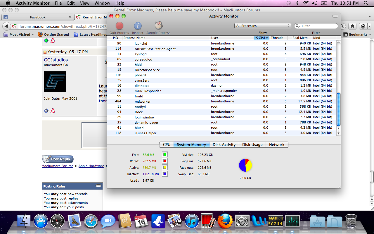

Thx for the help! Here are the shots.

Well I pretty much meet all of those requirments and it is still Kernel Error crashing on the regular and running like ****..
At this point, I'd probably do a clean install of Mac OS X. Be sure you have a current backup, even if you don't do the clean install, in case you have a failing hard drive.
Already tried that as the original solution, I guess this thing is just ****ed
The SMART is verified, as far as flash goes how would I best look into that?
I'm not saying this IS your problem, but I'm going to throw it out there. Maybe someone with experience can expand/clarify it.
I've heard that the thermal past between the cpu and heat sink can get old, dry, and crack. That causes the CPU to run warm. The Mac is smart enough to see the temperatures are high, and reduces the clock speed to prevent itself from cooking (causing slowness). If it gets too hot, the Mac shuts itself down (causing Kernel Panics).
It could also be something much less sinister. A dying ram chip, dying hard drive, etc.
I really doubt it is software related, because you did a fresh install of OS X.
That's my evidence for a hardware problem.
