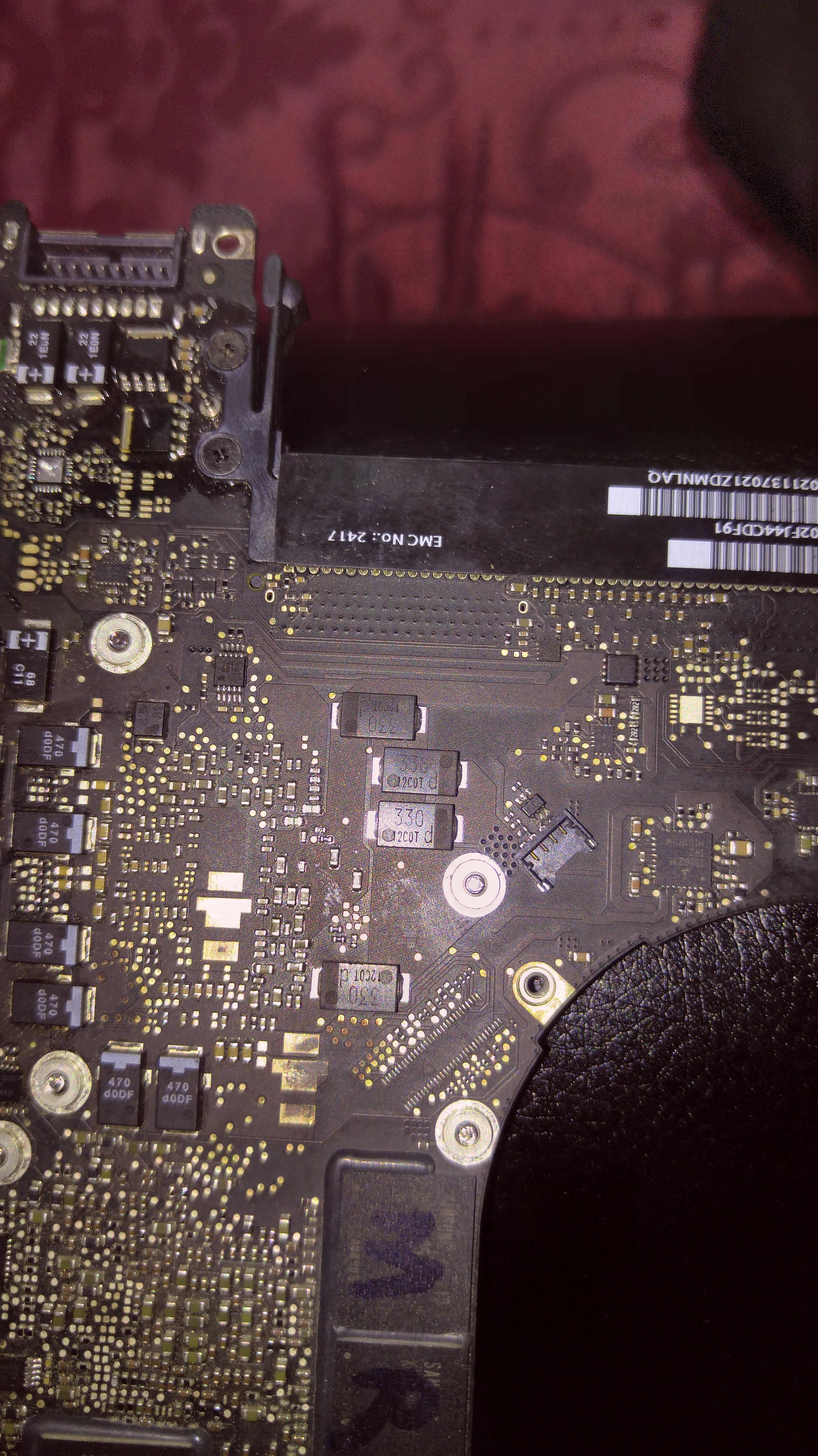

Im obligated to do that. The 2011 is just a dead motherboard that lacks other internal components (it's completely dead). Buying a cap online was my first choice, but i have to wait like 30 to 50 days to get it due to my location. The cap that i'm planning to recover from the dead motherboars is in the picture (330 uf... There's plenty of them).

I also did this once, but from a dead iMac. Your says 12C0T d I am always confused by the marking on Apple Hardware. They are different than I learned. Buy if the d is de voltage it should be a 2V Condensator. Worth a try.
After soldered the condensator to the new location use a Multimeter to check the resistance of it. It should go to 120 Ohm or so... can't remember. If it goes to 0 you have a short circuit. I had this once, its not bad but the Computer won't start.
