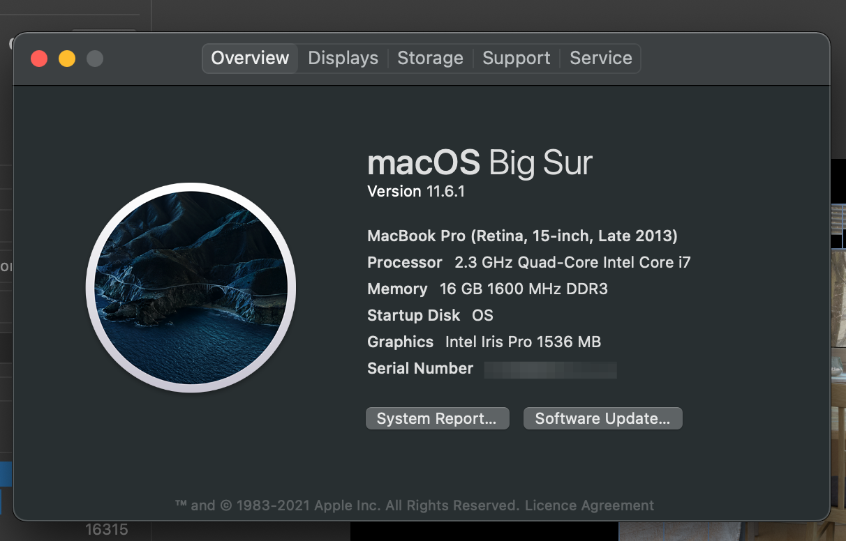

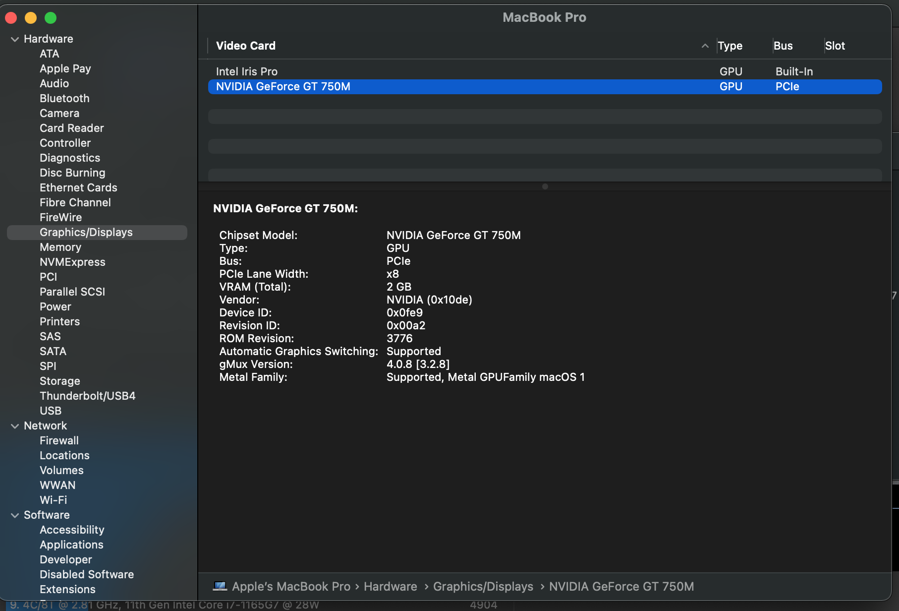

I had the same issue with the exact same panic report. I recently noticed that my Graphic card details is not showing up on 'About this mac' modal. It only shows detail about my Intel graphics card along with other system details. Also, my fan screams loud all day long and its annoying.
View attachment 1919098View attachment 1919102
I should have tried the solution mentioned by @Nhat99 above but sadly i updated from Mojave to BigSur latest one just yesterday 🤦‍♂️
Is there anything i can down without tearing out the PC?
