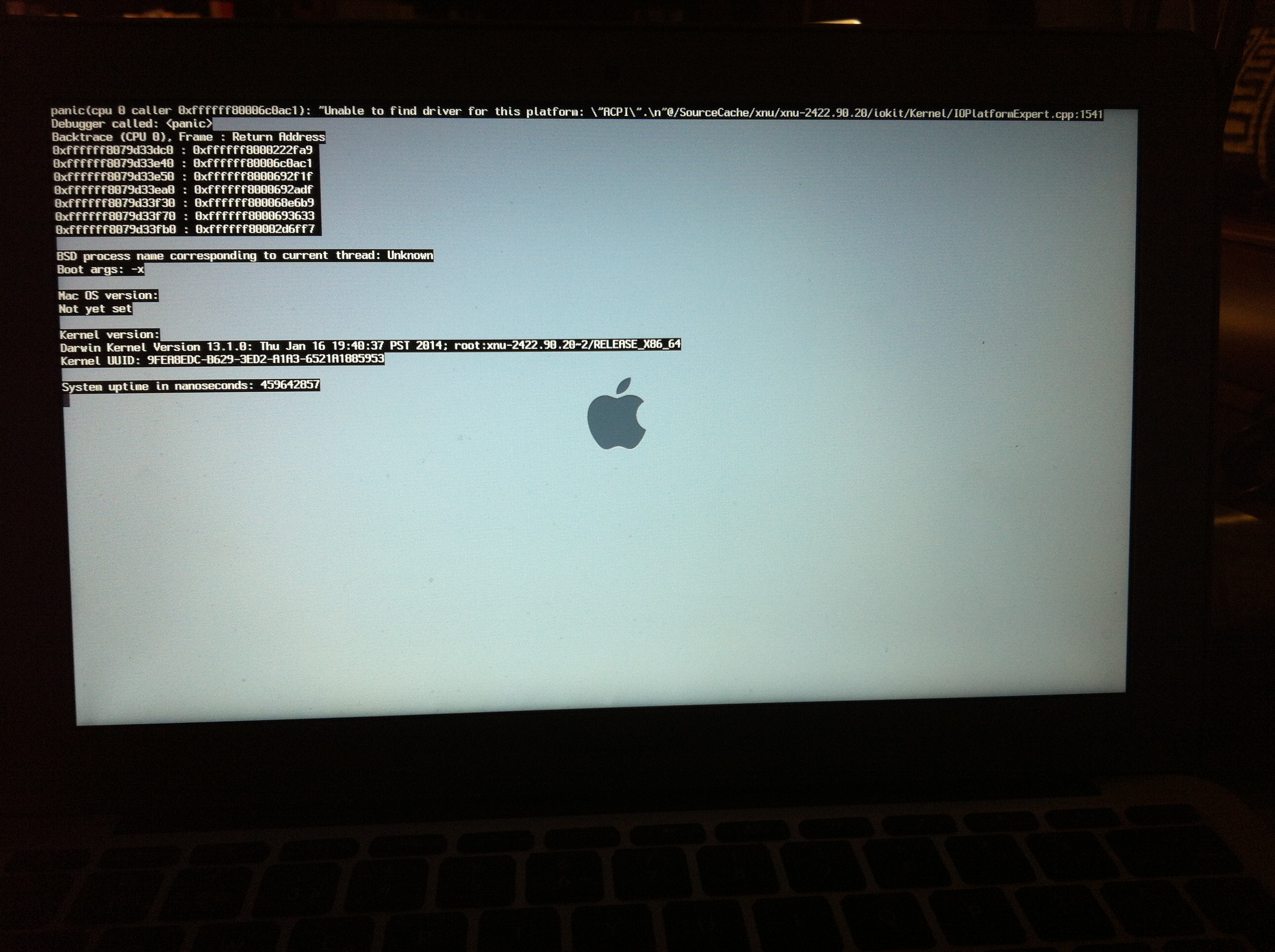

Hello,
I was updating my Macbook air with update OSX 10.9.2 and the screen went grey and I restarted it and got a Kernel panic. I restarted it and the same screen appears. I have tried (Shift key and power button) and the same screen appears. I'm basically new in this forum, and, sadly,🙁 I didn't make a backup before the update. Is there a solution for this problem? Can I recover my files? If anyone can give a step by step I will be forever in debt...
Thank you very much for your help.
Joel
The screen is this:

The message "can't find driver for this platform" means that it's missing critical drivers for your system. Boot from an external OS and rerun the update on the internal drive by downloading and running the combo installer.
Your files should all be there. Just don't do anything drastic, like formatting the drive.
If you don't already have an external OS drive, get a USB thumb drive (16GB should be more than sufficient) and install a full OS on that. It'll be slow, but it'll work.

Had this issue loads of times with end users' Macs. Best thing to do: hold Alt on startup, boot into recovery partition. Select 'Reinstall OS X'. This won't wipe the system, merely reinstall the core components.
So it's sort of like what Detrius said, except you don't have to boot from an external HDD.
