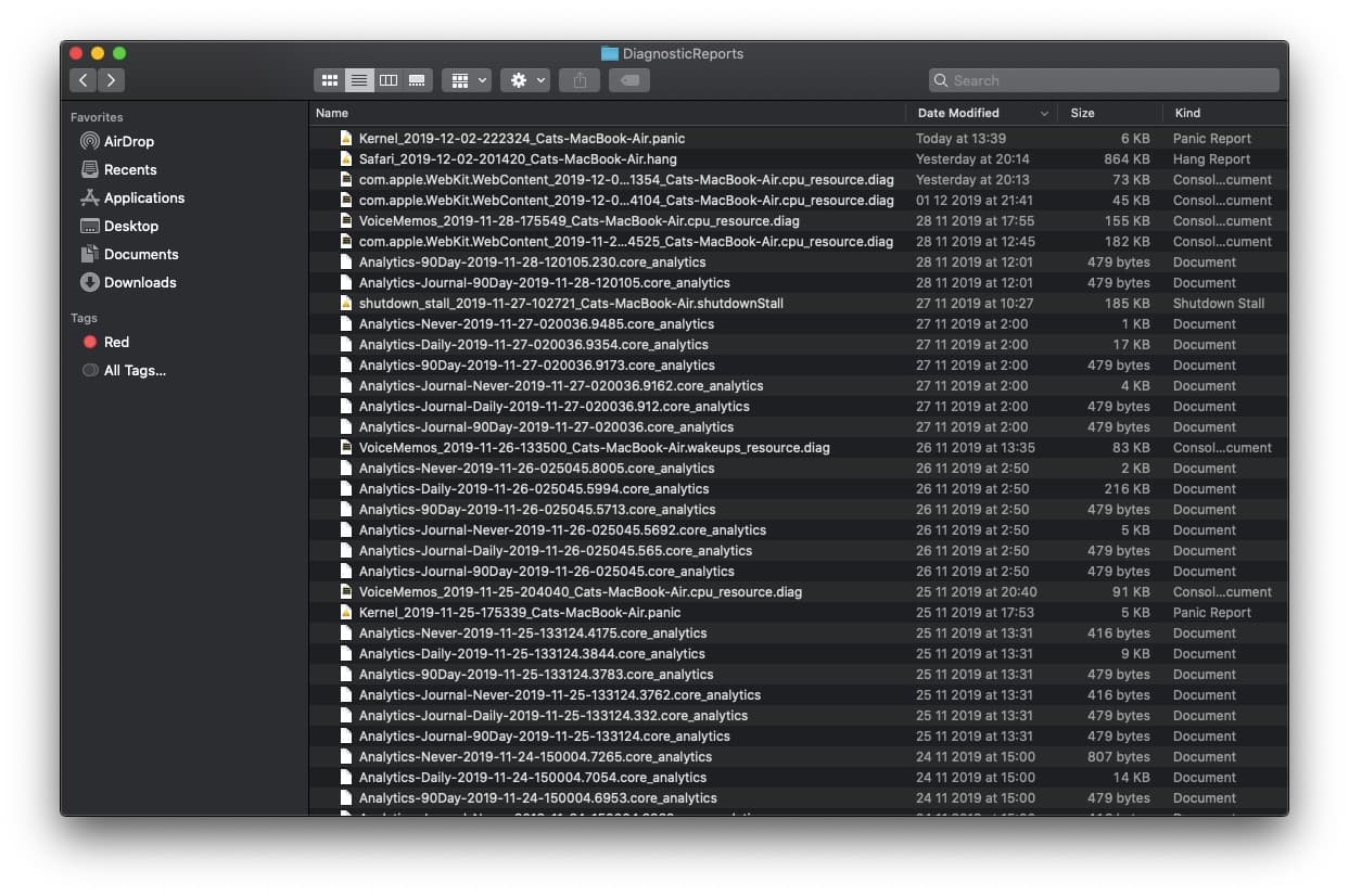

Here is a Screenshot of the folder I found relating to crashes:

The file you want to look at is the one at the top of the list you posted earlier – the image above. Its name starts with Kernel_2019_12_02... If you look in Kind column, you'll see it's listed as Panic Report.

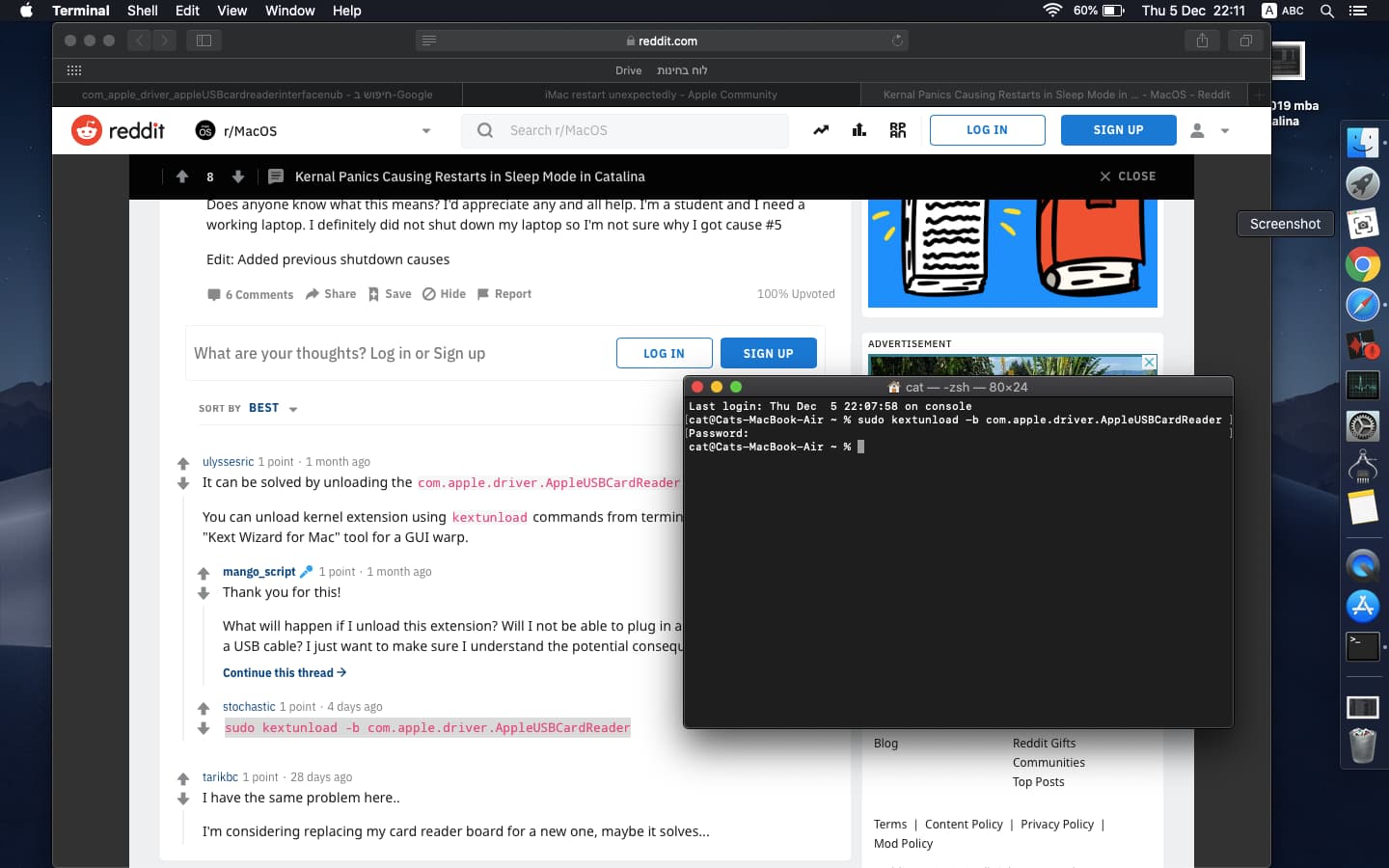

just to update this thread (in case someone ever comes across this issue), i found this reddit post ( ) and followed their directions.
I have no idea what it is that this command does, but i ran it (of course, I am assuming this command is meant to disable the card reader drivers (?), which may have caused the crash).
here is a screenshot:
of course, if anyone has more information or could offer more advice, that's appreciated.
for now, i will keep testing the mac to see if the problem has stopped.

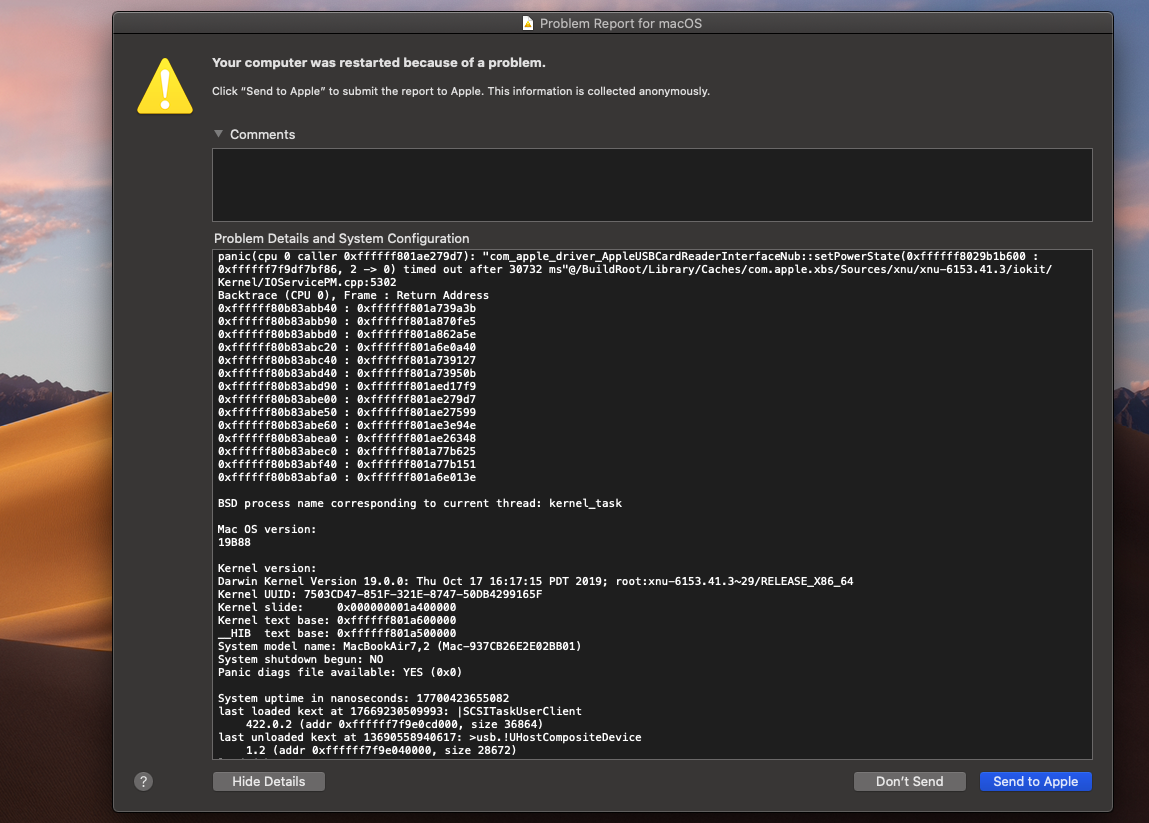

Indeed, I pasted the content of that file here:
Ah sorry. I missed it, obviously.
It seems to have failed while trying to change its power state within the USB Card Reader driver – while sleeping, per your notes above.
So, that's the culprit. Now why is another question. I can see you're on Catalina 10.15.1, so likely a bug there, or perhaps something to do with the new "protections" Apple have put in place in macOS. If the USB device you're using installed some drivers or kernel extensions, then it could be they're incompatible; but I'm guessing now.
