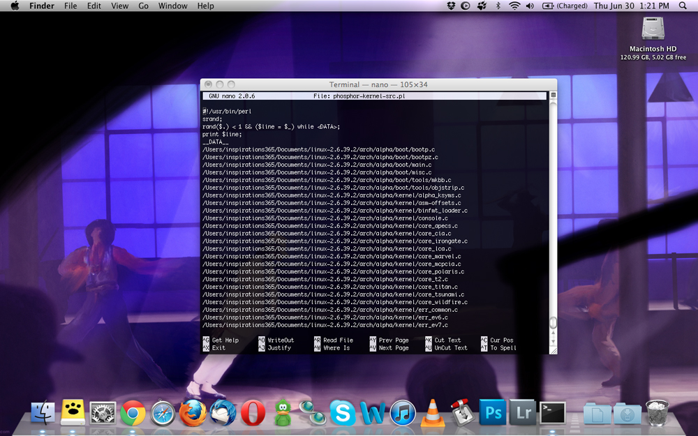

There's my script and perl files respectively.

Please post the actual text of the files.
Copy and paste the text from the files into a reply post.
Use the CODE tags as explained here:
https://forums.macrumors.com/threads/747660/
I can't run pictures, nor can I diff your pictures with the text files on my machine. And the resolution on the pictures isn't really adequate to do a visual comparison; much too jaggy, although it looks like you probably have the <DATA> in the perl file.
So assuming there really is a <DATA> in the perl file, post exactly what version of perl you're using to run this code.

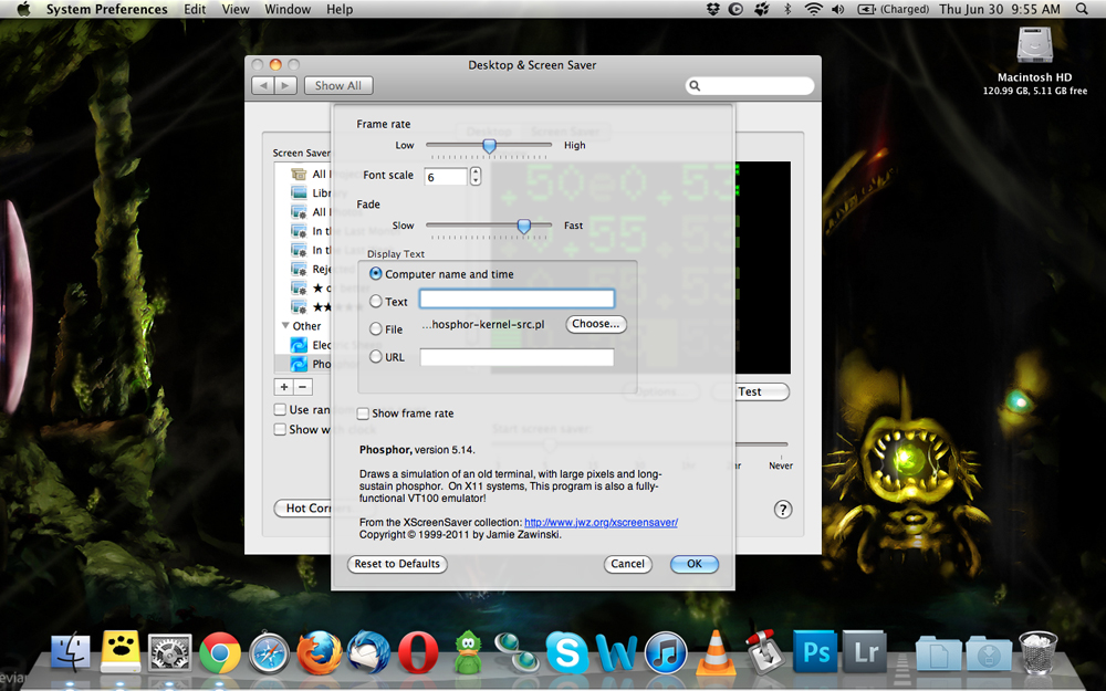

So it is in fact, working?! Okay then, what command should I put into Phosphor to get it to run the Perl now?
If you can't see, the options are
-Computer name and time
-Text (next to it is a data entry box where I put the command in last time I wanted to do this)
-File (choosing the .pl file does not produce the desired result, but it does go through *.c files
-URL
You should probably do some basic testing first.
Judging by the 4 radio-button options, the first one seems like a good start, because it has no parameters.
The "Text" one seems to be asking for some constant text to be displayed on the screensaver. That's just a guess, but it seems reasonable.
The rest I have no idea. I'd have to guess at what the Phosphor screen-saver is expecting or wanting to use. I'm willing to help with shell scripts, but downloading and running a screensaver is over the line for me.
None of the options suggests (to me) that there is an option for running a script, which is how your phosphor-kernel-src.pl script needs to be treated. Reading the pl script as a file would be wrong; you don't want to display the pl file, you want to execute it and use its output as the pathname of the file to display (a level of indirection). If there's a hook in Phosphor that runs a script, I don't see it, and can only guess what it is.
Maybe it's time for you to refer to the documentation for the screensaver.
