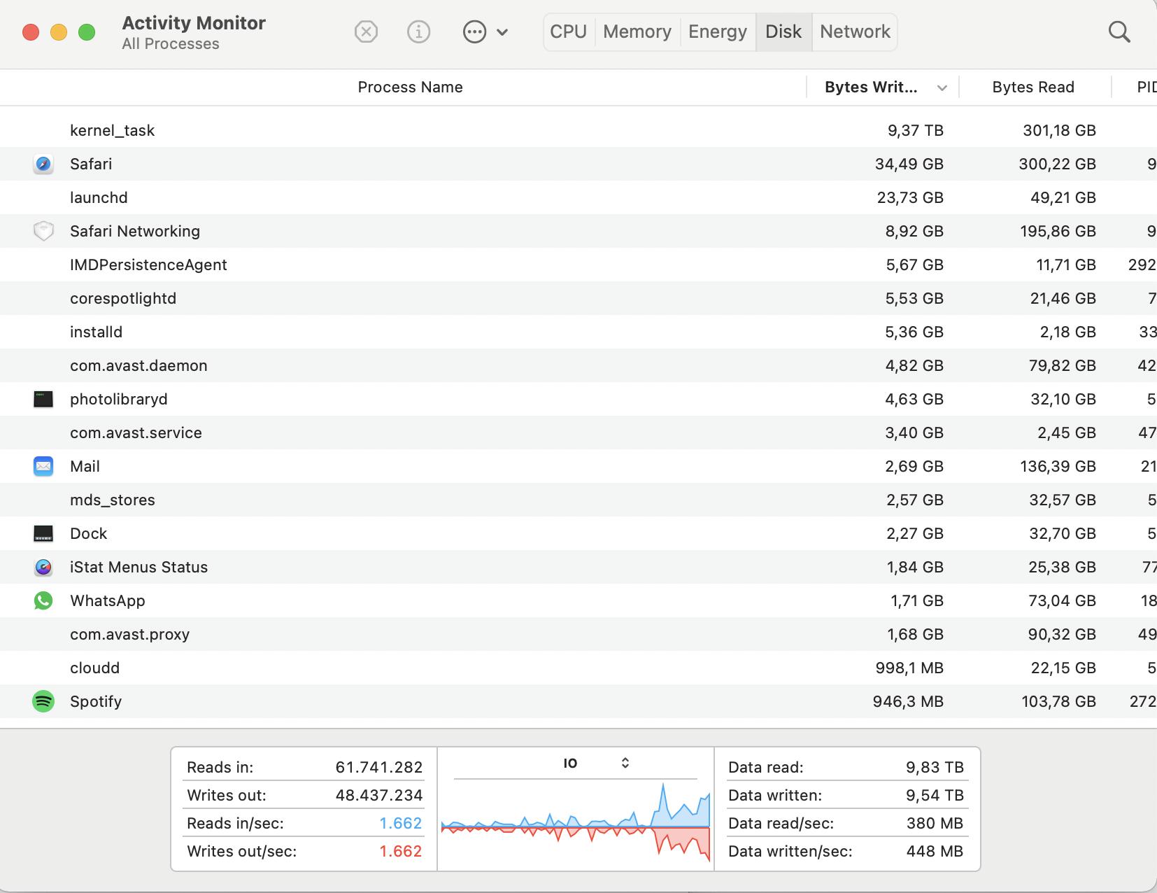

Hi guys,
Another interesting M1 misbehaviour example...
I have noticed that my kernel_task process wrote over 9 terabytes of data within a week... I have a feeling that's a bit much?! Computer spent most of the time sleeping and when on, it was only used for browsing.
Yes - I do use on average 10+ tabs if anyone wonders... It's an MBA M1 8GB machine. Also computer has been on only for a week.
I did a reboot yesterday evening and since kernel_task already wrote over 1.7 tb of data - NVRAM reset done.
Any thoughts how to address that?

That seems AWFULLY high... but not sure what would be causing it. For comparison after 3 days on mine kernel_task process has written under 10 GB

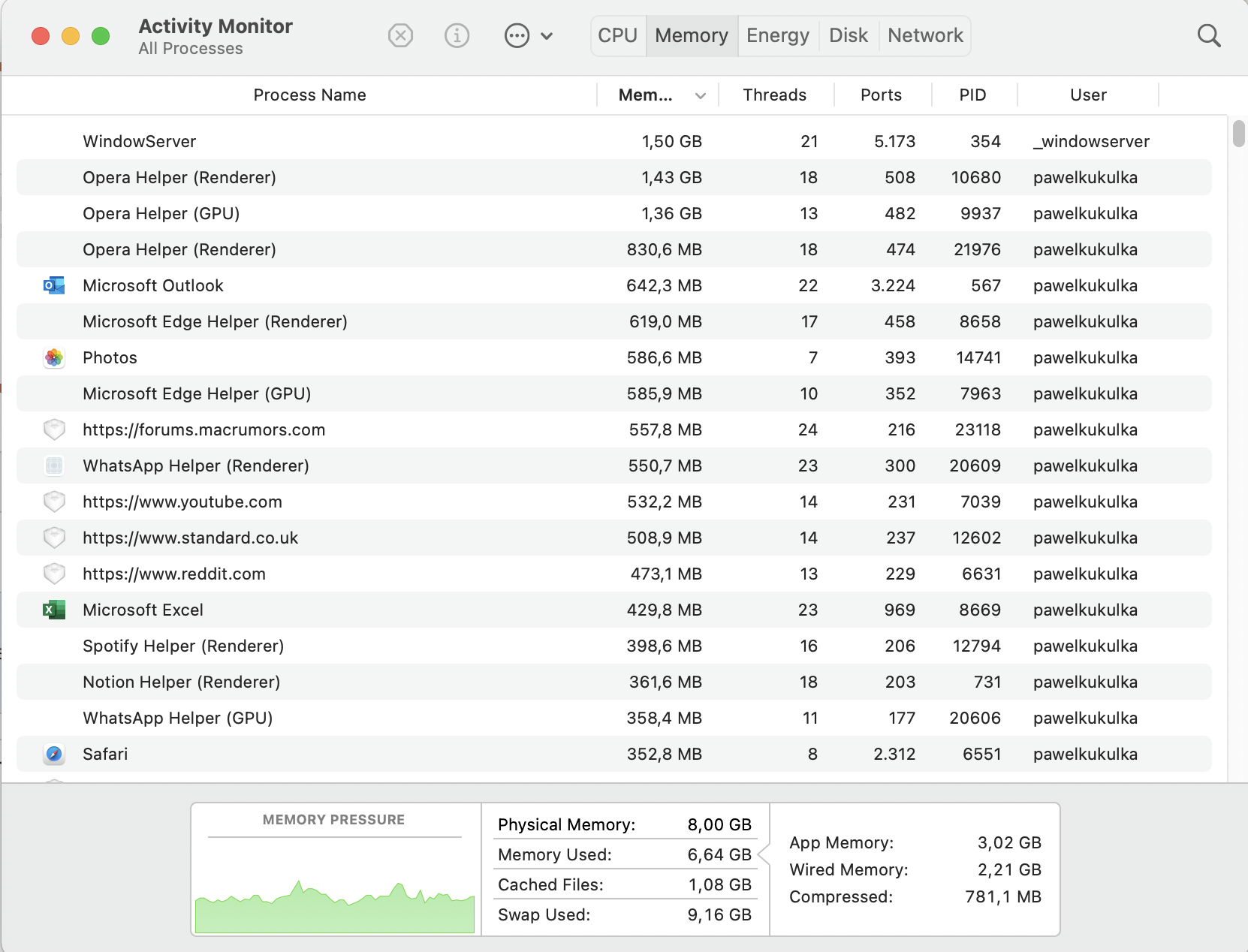

What is your memory pressure? I have a feeling this may have to do with swapping.
I am not going to lie - I do use multiple apps, but kernel runs such a big amounts of data even when only one app is on.
So far I have removed avast just to see if there is any difference. Also experimented with mail apps - no difference.
I thought it could have been faulty temperature system, but diagnostic showed nothing wrong.

9.6GB of swap used. That’s probably a big part of the problem.
This is because the computer is swapping a lot. And this is the exact reason I keep telling people to get the 16 GB model.
Out of 8 GB of ram, aproximately 6-6.5 GB is available - The rest goes to the GPU cores. With Mac Os easily using 3-4 GB after it's been running for a few hours, that basically leaves you with 2 GB for everything else, which is absolutely nothing. This then forces the computer to swap like crazy.
Even if your memory pressure is green, that is NOT an indication that everything is good memory wise. It will usually be green even when the computer is swapping like mad. My computer currently is using 30 gb of swap and memory pressure is green. But the computer is substantially slower compared to when it's barely using any swap at all. The memory pressure metric is useless for everything but showing when it spikes high temporaily.

app name? hope not lightroom
You've dumped Avast I see. Have you got Norton running? I'd try dumping that, if you have.
I also see you've got Microsoft Edge, Opera and Safari running.
Maybe you could narrow down a cause if you just tried using Safari for the moment, making sure that Edge and Opera are running nothing after you stop using them.

A single Amazon tab in Safari uses around 400MB on my MBA. If you keep a lot of tabs open, then that's a lot of swapping.

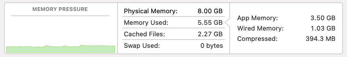

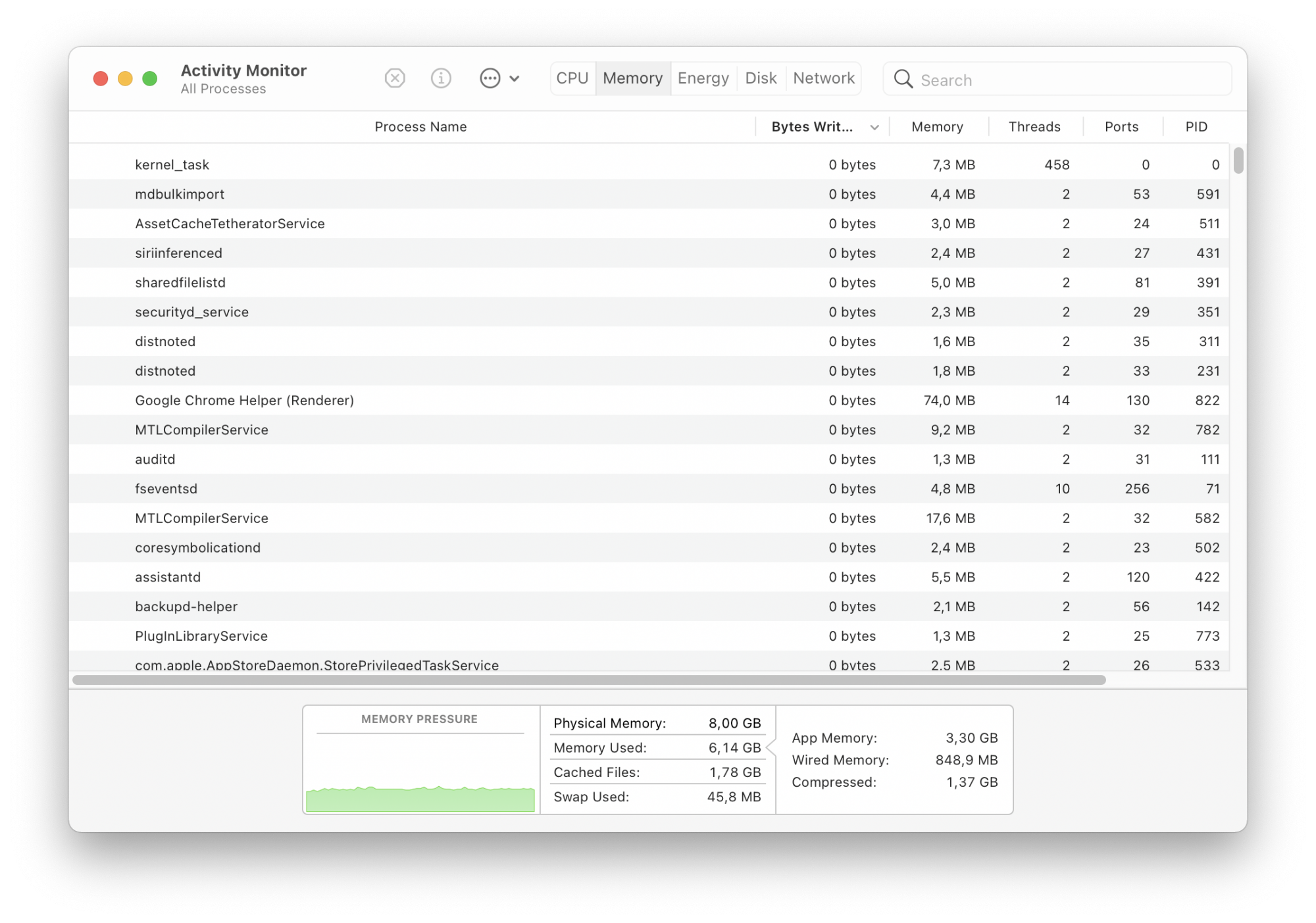

Ya, I don't like blanket comments about needing more memory. I'm a programer. Had zoom calls half the day and VM Ware Horizon connected to Windows Machines at work, Safari, Messages and a few other apps running.
Here is how much swap I was using ... ZERO
I know many of you have 97 tabs open, three streams of YouTube running simultaneously while converting your 10K song iTunes library to a higher format. But for the regular Joe who uses a laptop. 8 is plenty.
