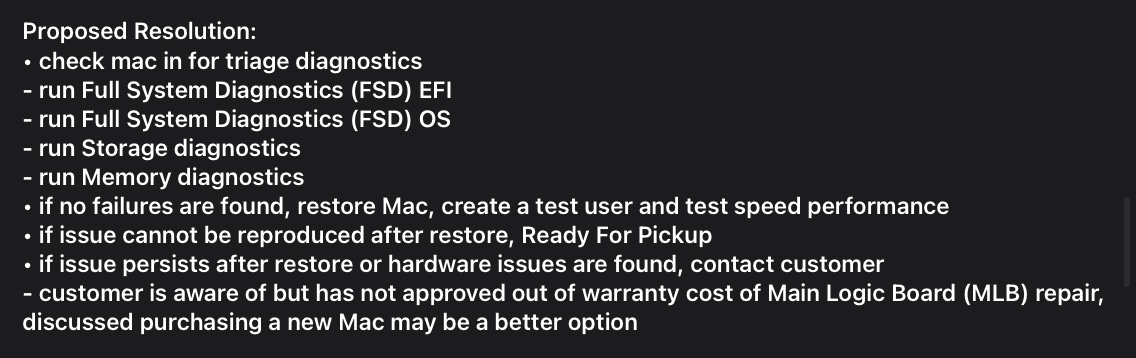

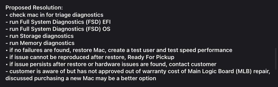

Nothing out of the ordinary. Took it into an Apple store today and left it there for testing. The Genius Bar guy suspects the logic board needs replacement, which costs $625. Oof. I looked up the part on ifixit and their 2.2 ghz board costs $350 but it’s out of stock 😬 plus $20 for thermal cleaner & paste. Yikes, I wonder how many more years it would last if I did the replacement myself.
Yeah, oof. If it were me I wouldn't rush to replace the logic board. And for $625 I'd put that toward a new Mac, if I had to. You can get an Apple-refurbished (just like new -- Apple refurbs are great) 2020 M1 MacBook Air (which would run rings around your Air) for just $850. (https://www.apple.com/shop/refurbished/mac/macbook-air)
Still, to me this really seems more like a software issue than hardware, but I'm pretty much out of ideas.
