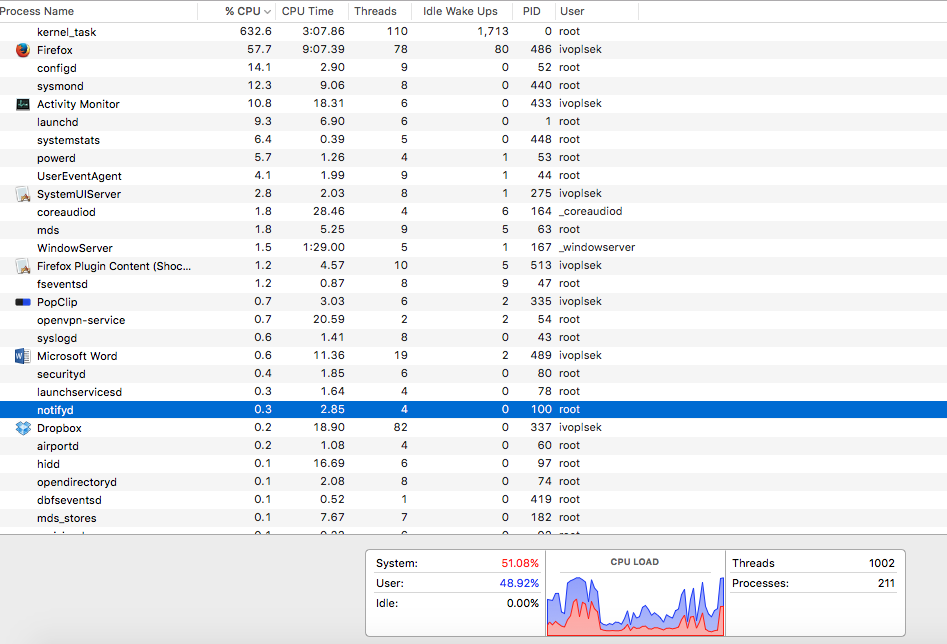

kernel_task. It can sometimes run up to 600% of CPU, sometimes 300%..fluctuates...as many as 110 threads open; uses most memory of all apps. When kernel_task is highly active, computer stalls (see activity monitor screenshot). I've noticed that this issue is most likely connected with OVERHEATING (only in the upper left-hand corner of the computer..ie. above motherboard). Placing fingers on the aluminium above the keys (ESC, F1, F2, F3) as well as left of keys TaB, CAPS Lock it feels really hot (almost a burning sensation).The same is true on the back of this area.

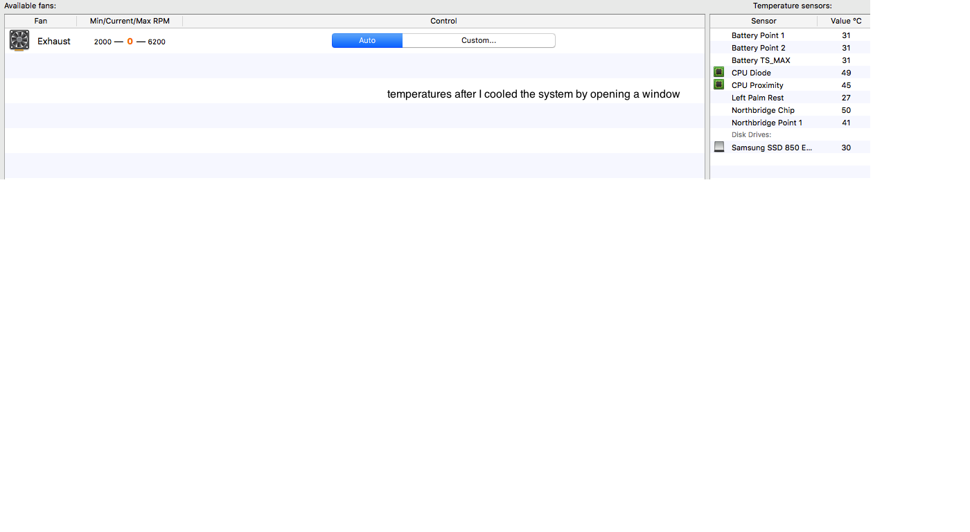

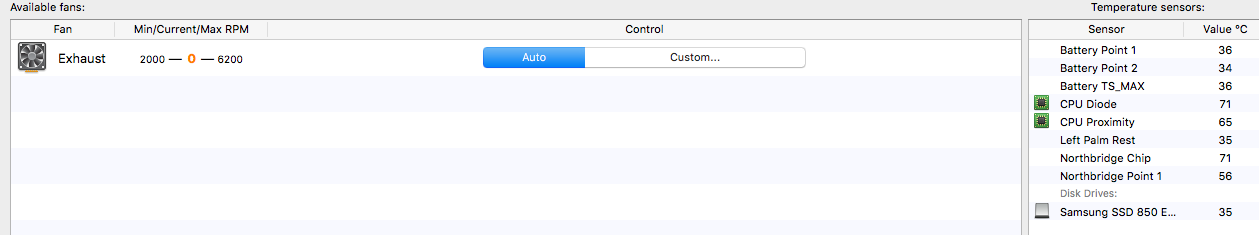

Temperature(see screenshots):
no big change in Battery point 1, Battery Point 2, Battery TS MAX, Left Palm Rest, samsung SSD.
big changes (after cooldown vs. high numbers during normal use): CPU Diode (49°C - 75 °C); CPU Proximity (45°C -68°C); Northbridge Chip (50°C -73°C); Northbridge Point (41°C -57°C).

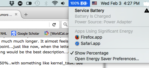

BATTERY(see screenshot):
- whether AC is on or off, overheating is an issue. But I have another problem: "SERVICE BATTERY" - is a message I get when clicking on the battery icon. Currently it's 100% charged and i get about 2 hours work from it. But it seems the battery might be failing too? (this is a message I got only after I upgraded to El Capitan, on Snow Leopad 14 days ago, there was no problem).

It sounds like a sensor issue, or a degraded coupling between the heat sink and the CPU. I am not sure why the kernel is maxing out your CPU but that is the cause of the slowdown in the system response - ay max cpu load the system is constantly busy so it can't respond to you typing or opening things etc.

Your battery probably always needed servicing, but it's only now with the new OS that it displayed that information so prominently. If it only lasts a couple of hours it's probably getting to the end of its life and if you want to keep the computer you probably should replace it. Five years is not a bad run for a lithium battery.

Yes, it is odd but once the CPU temperature is up in the 70 degrees (celsia) and I cover the back of my laptop with my hand...(i.e. in the middle the laptop from the other side) the fan kicks in, the temperature immediately sinks to 50s degrees and than there's no kernel_task prolem anymore.
