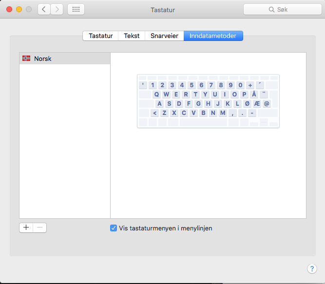

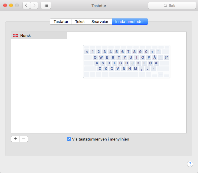

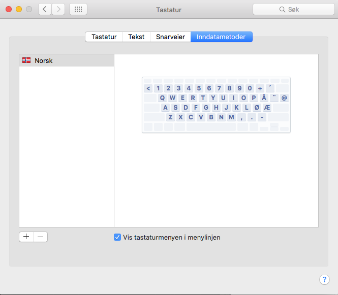

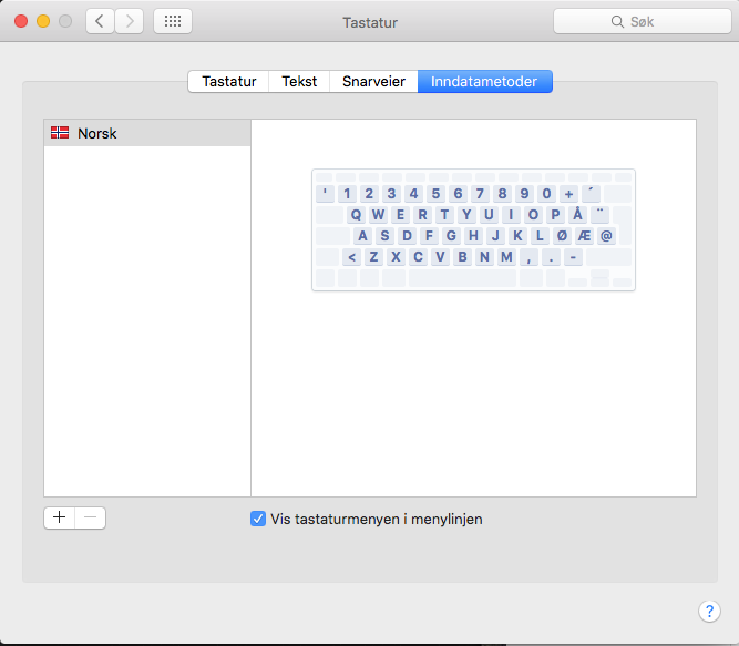

Hello. I have been using a Logitech G15 keyboard with my MBP for years now without any problems. However, a few days ago my Mac have changed the following signs: < and > to ' and §
I have tried a lot of things, but nothing seems to work. The first image is the keyboard layout of my Mac. The second image shows my Logitech keyboard. Is there any way I can make the Logitech the same as my Mac keyboard?

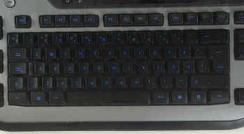

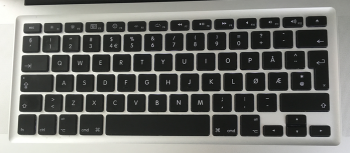

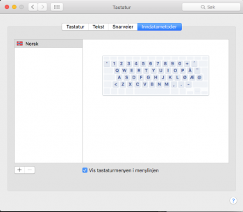

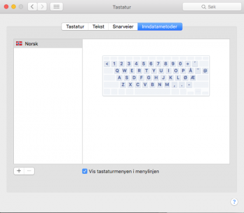

Just to get this clear, the Mac keyboard layout is the one you always had? It is the Logitech keyboard that is suddenly wrong? The keyboards themselves (hardware) are identical in the layout, or is the Logitech keyboard different (i.e. American layout, with a horizontal enter key)?

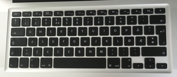

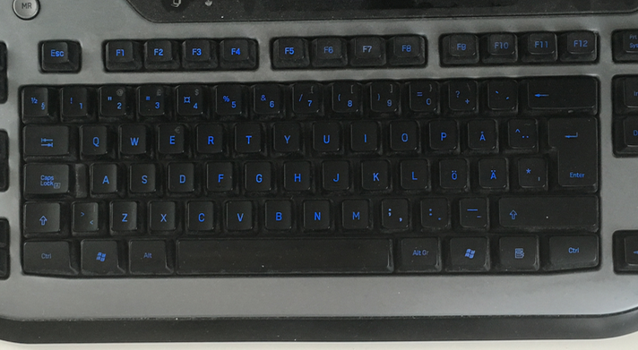

The problem is with the Logitech Keyboard. The Mac keyboard is perfect. The layouts are identical, see images below.
Logitech G11 Norwegian
MacBook Pro 2011 Norwegian
Thanks for your troubleshooting-help!
Well it seems that OS X does not recognise the hardware layout. I found some potential solutions here, which you can try.
1. Check whether there is a button to change the keyboard type in System Preferences → Keyboard → Keyboard. If so, press it and follow the setup. Make sure you select ISO as the keyboard type.
2. Check whether the file ‘com.apple.keyboardtype.plist’ exists in Macintosh HD/Library/Preferences. If so, unplug the keyboard, remove the file and plug in the keyboard. The same setup should start afterwards. If not, try rebooting after you’ve removed the file, just to make sure that nothing is cached.
Reactions: 997440
Hello, your suggestion 2 worked perfectly, and everything is back to normal! Thank you very very much for your assistance!
