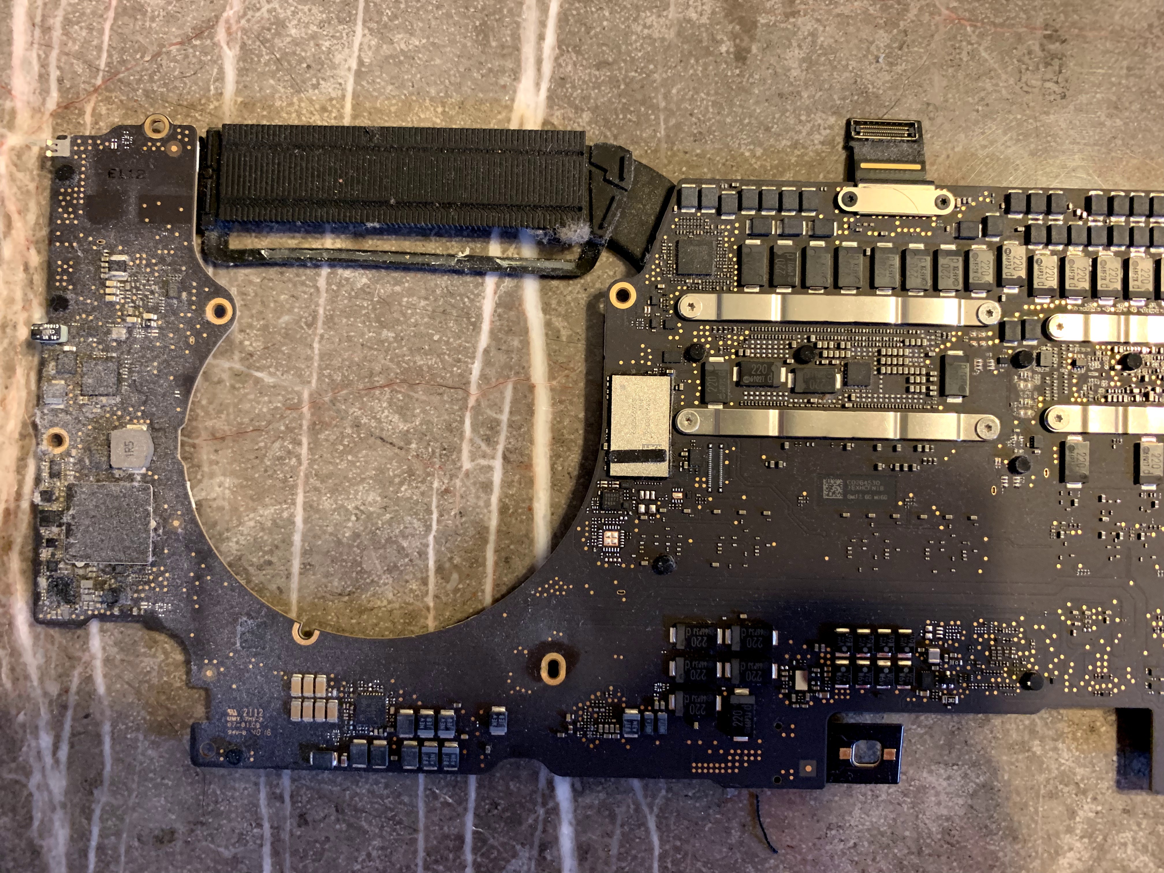

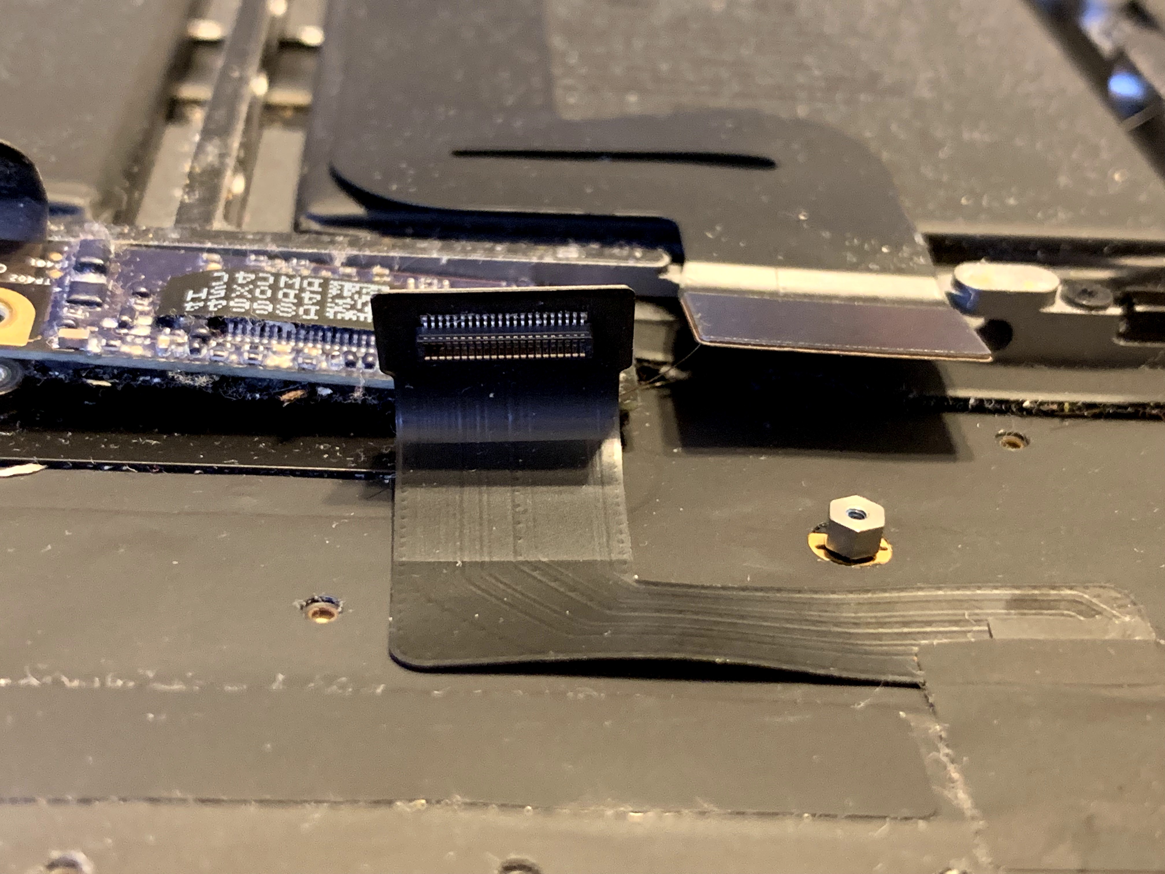

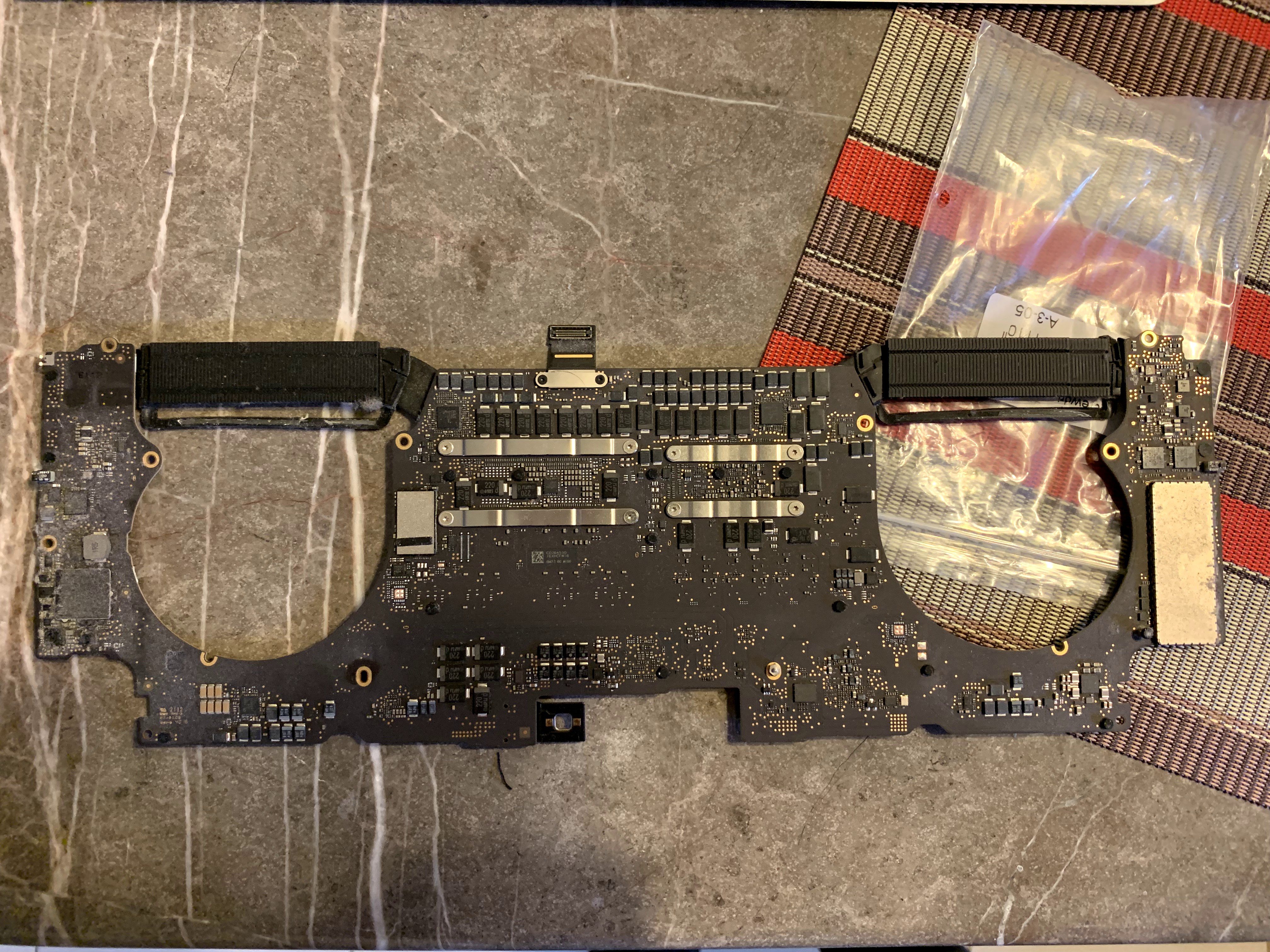

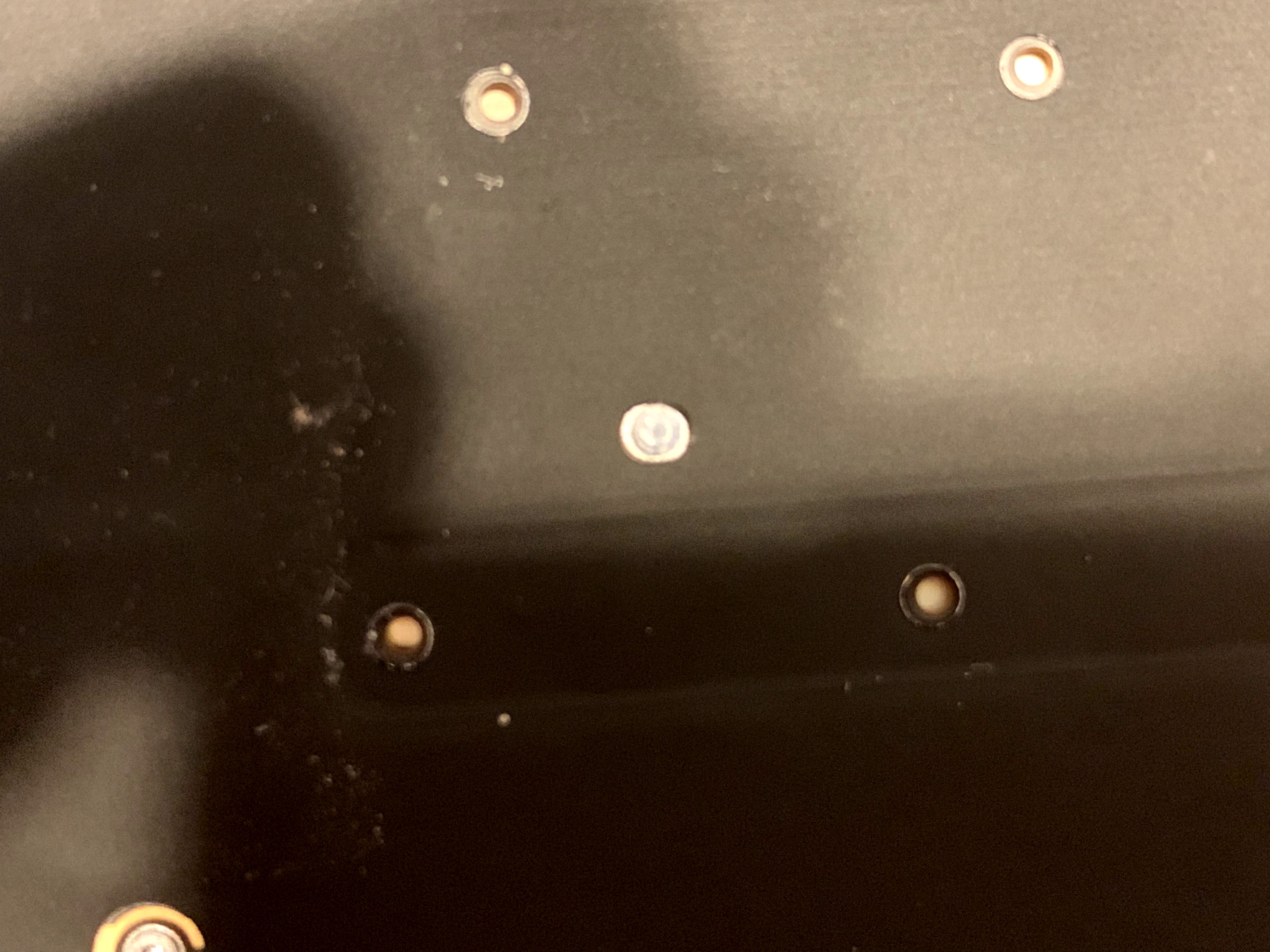

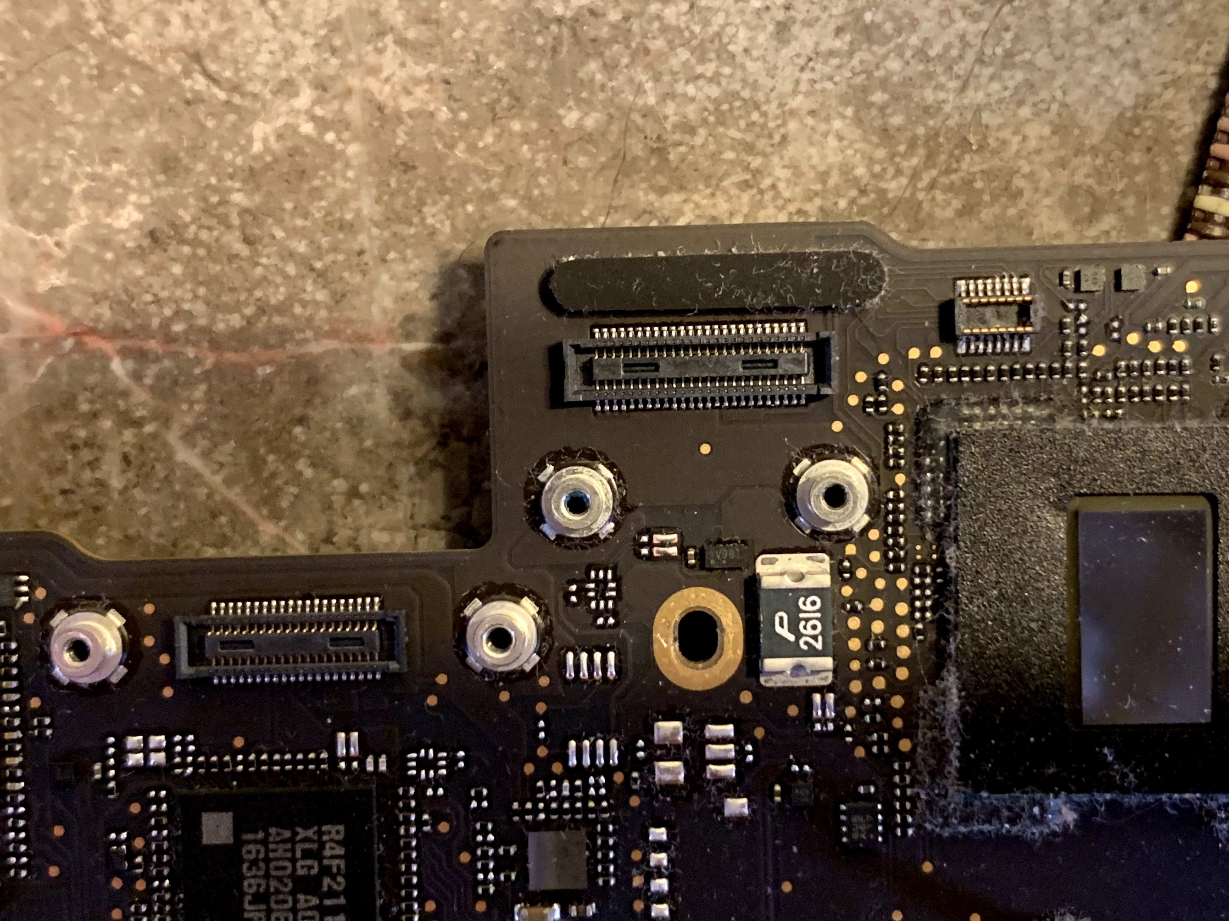

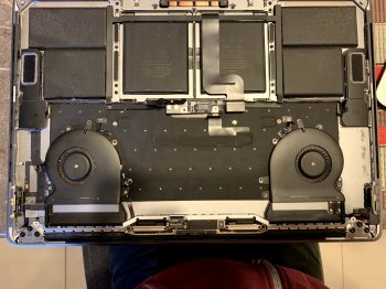

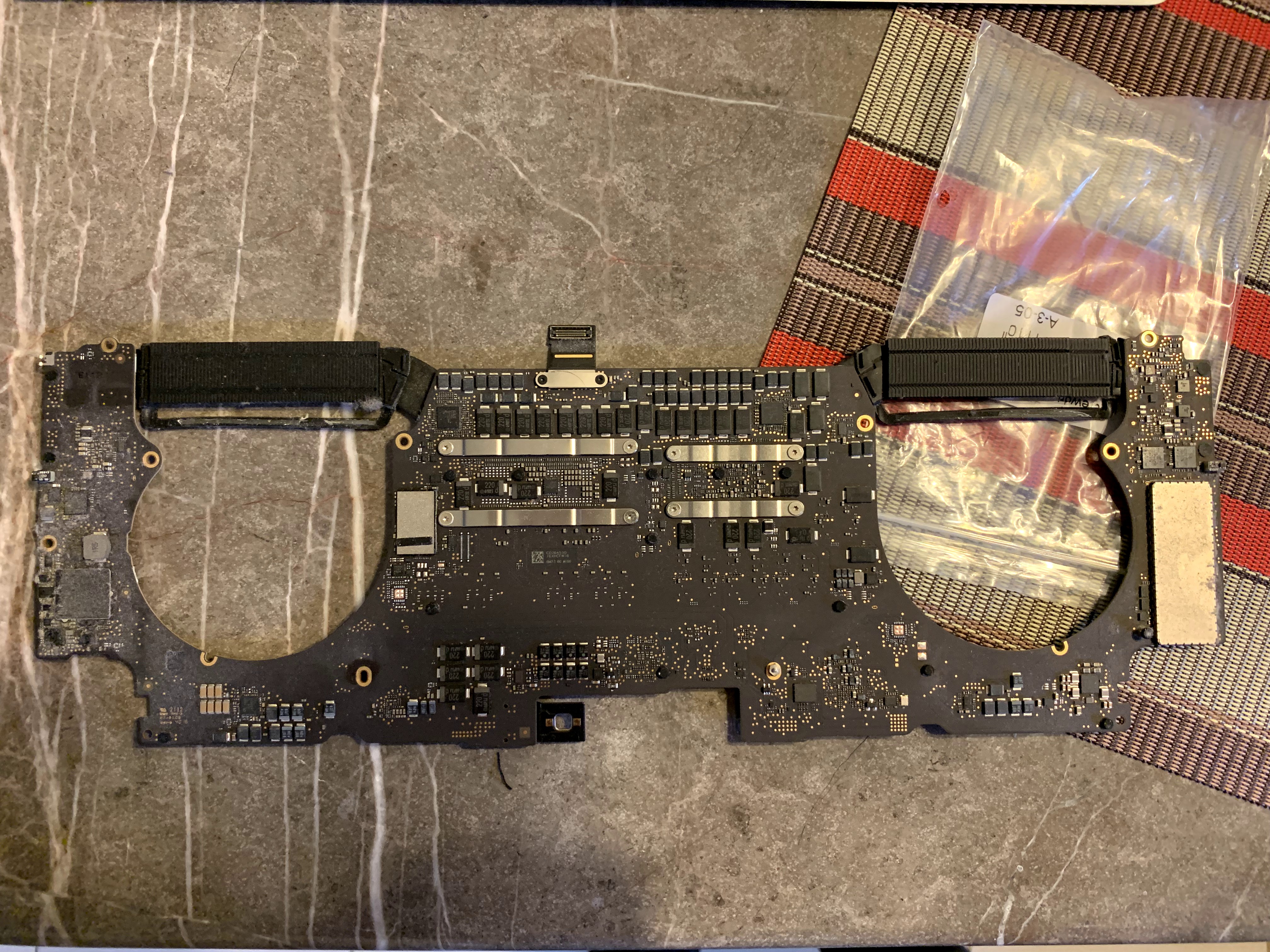

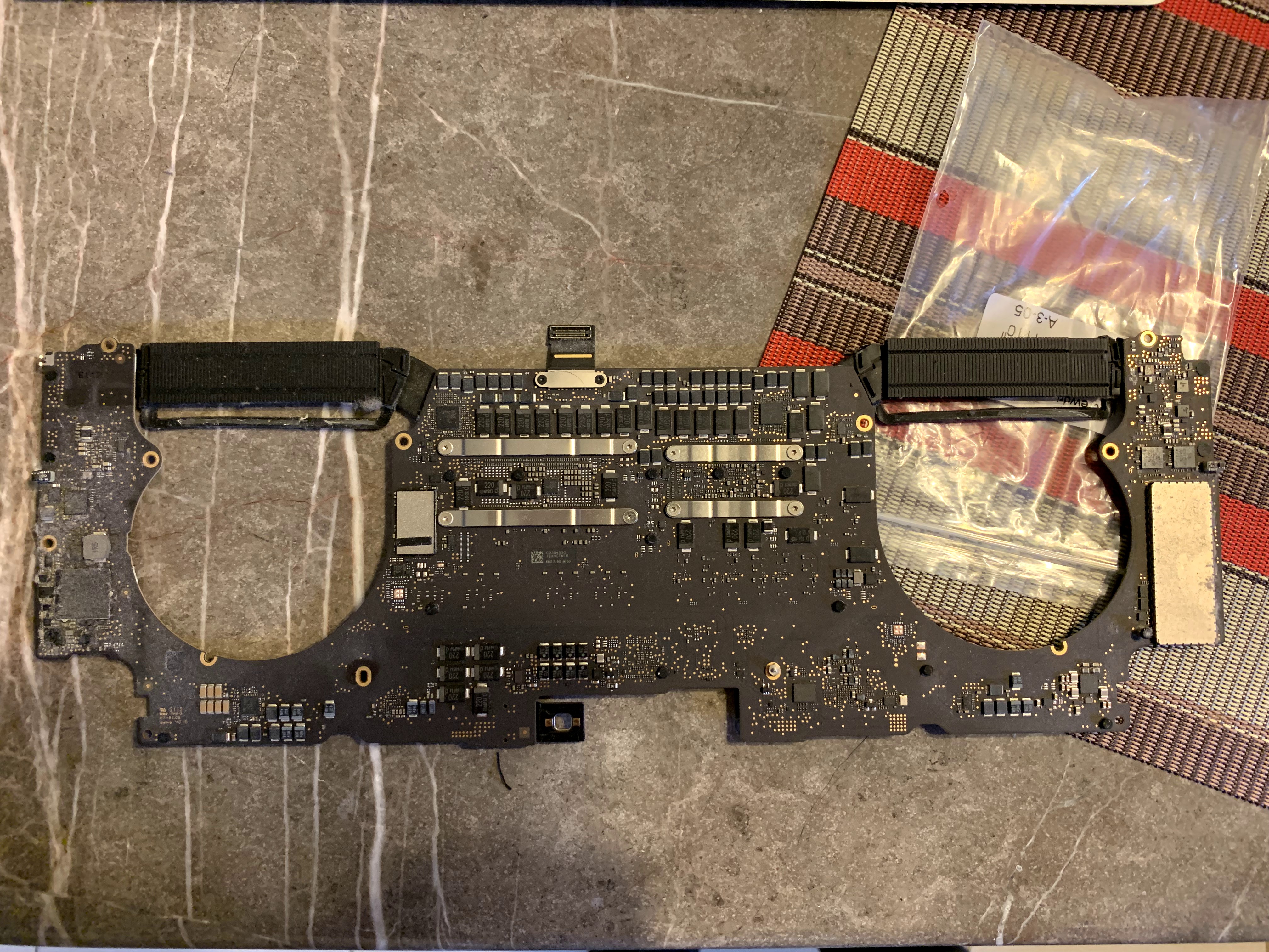

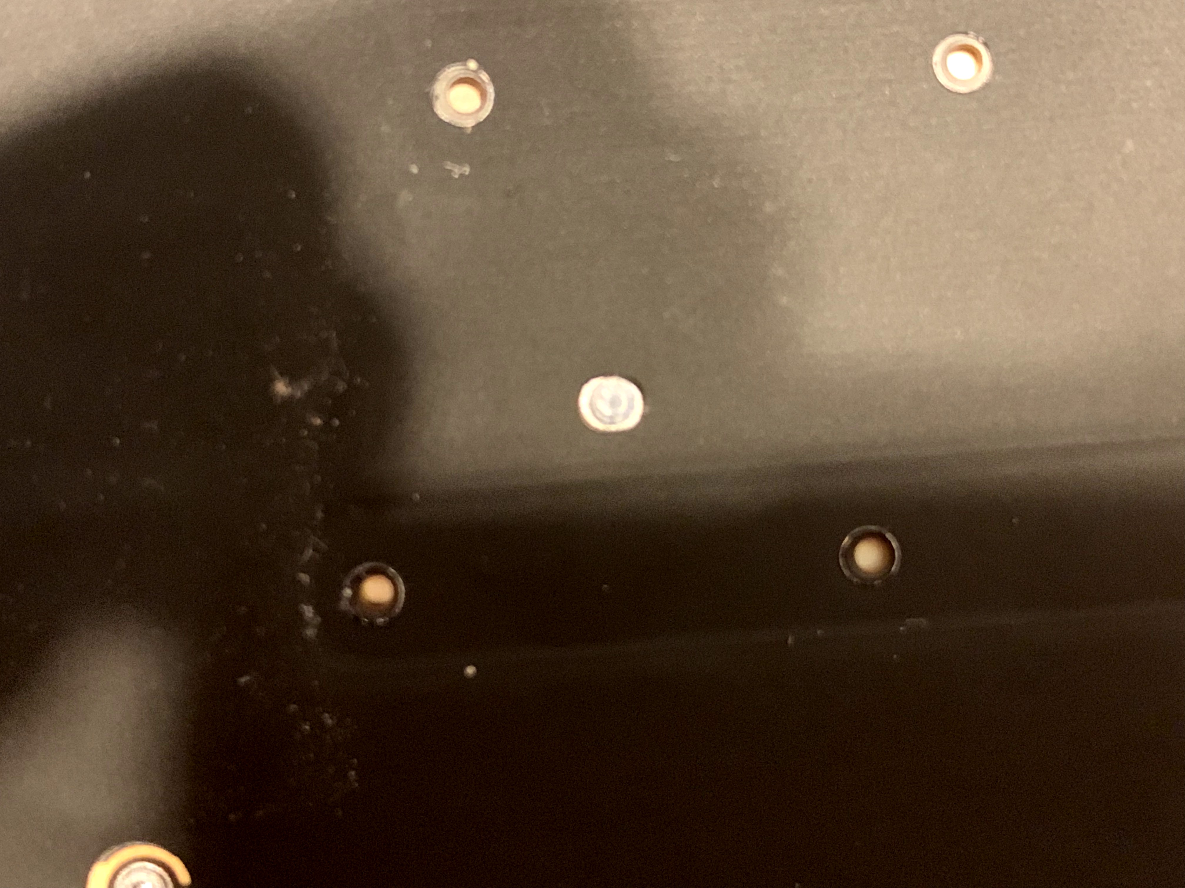

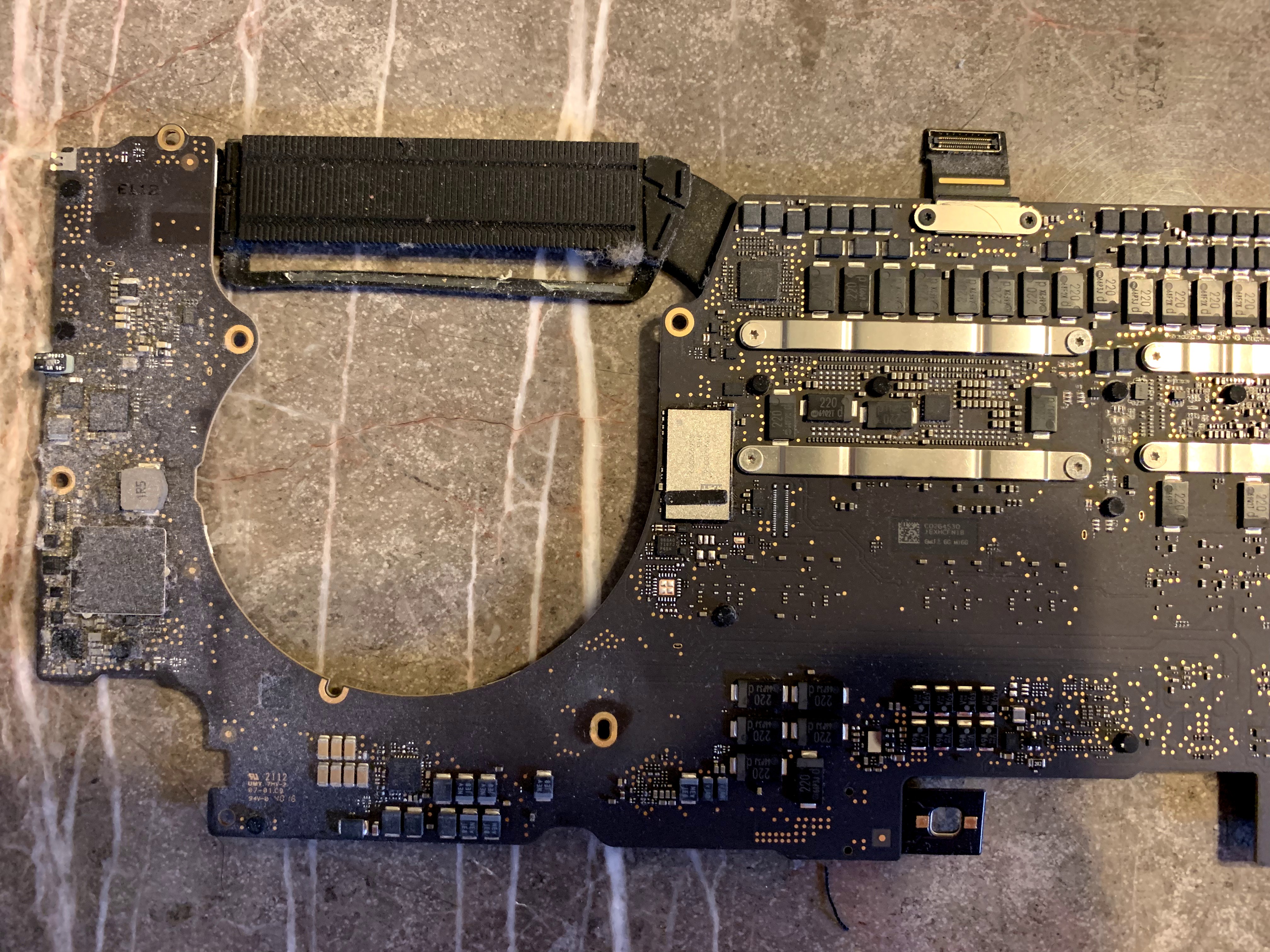

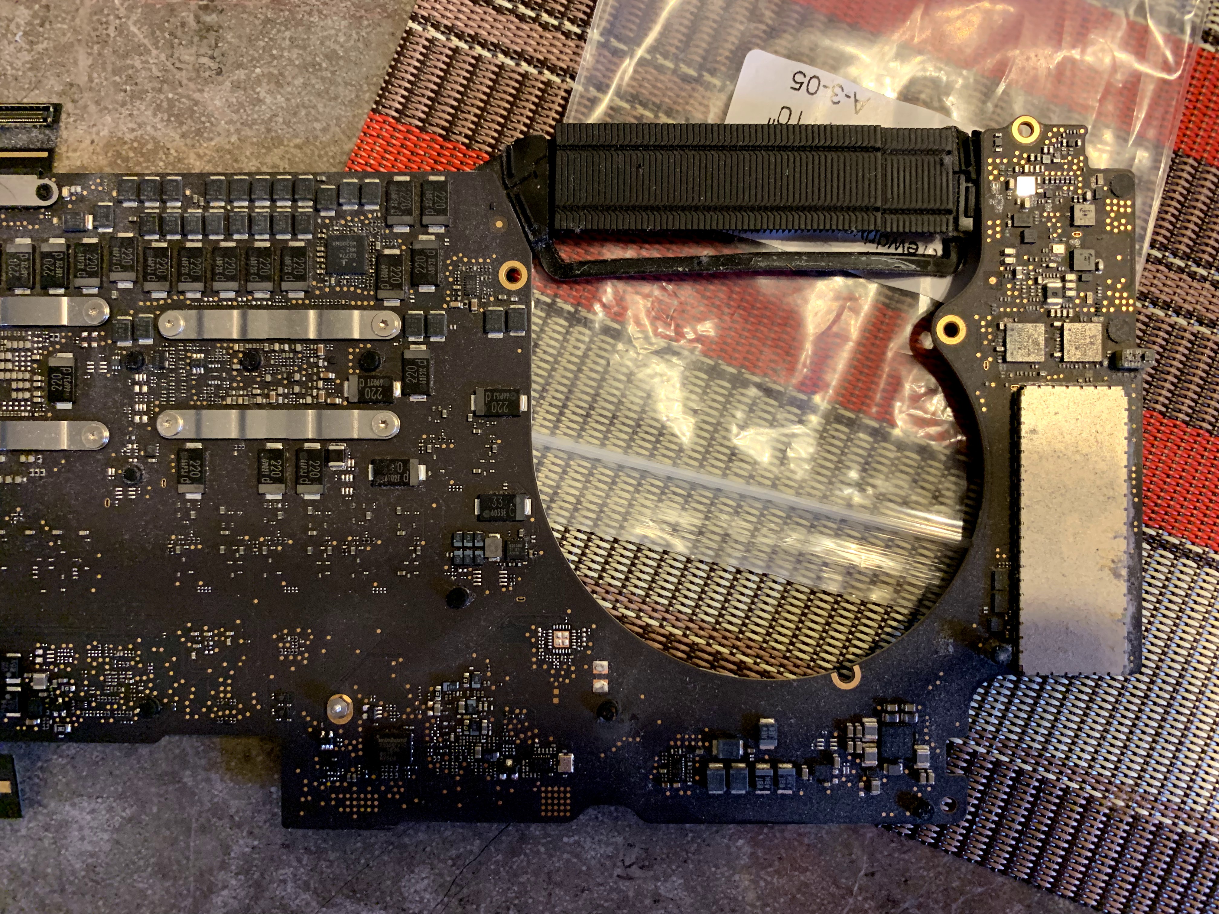

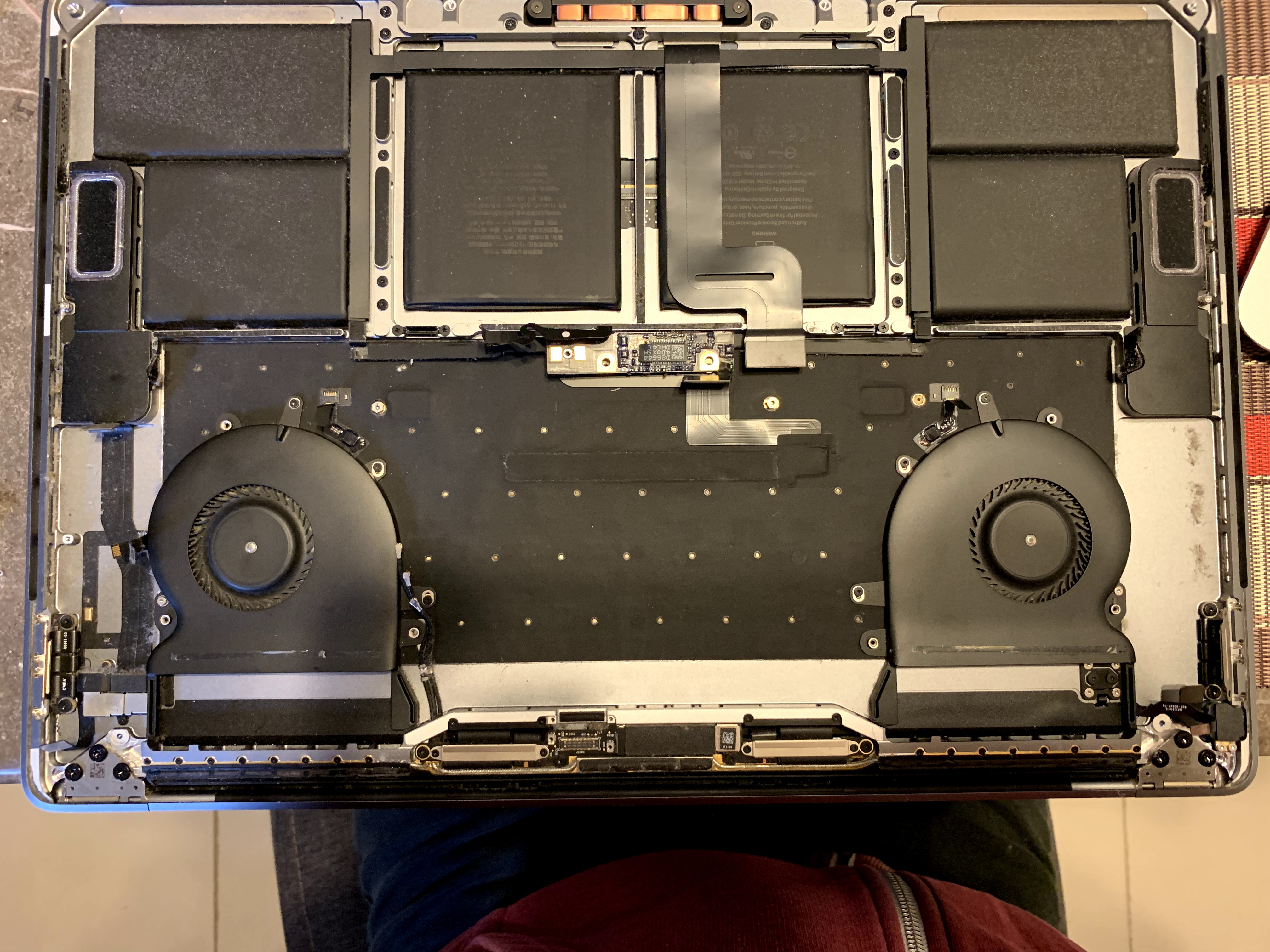

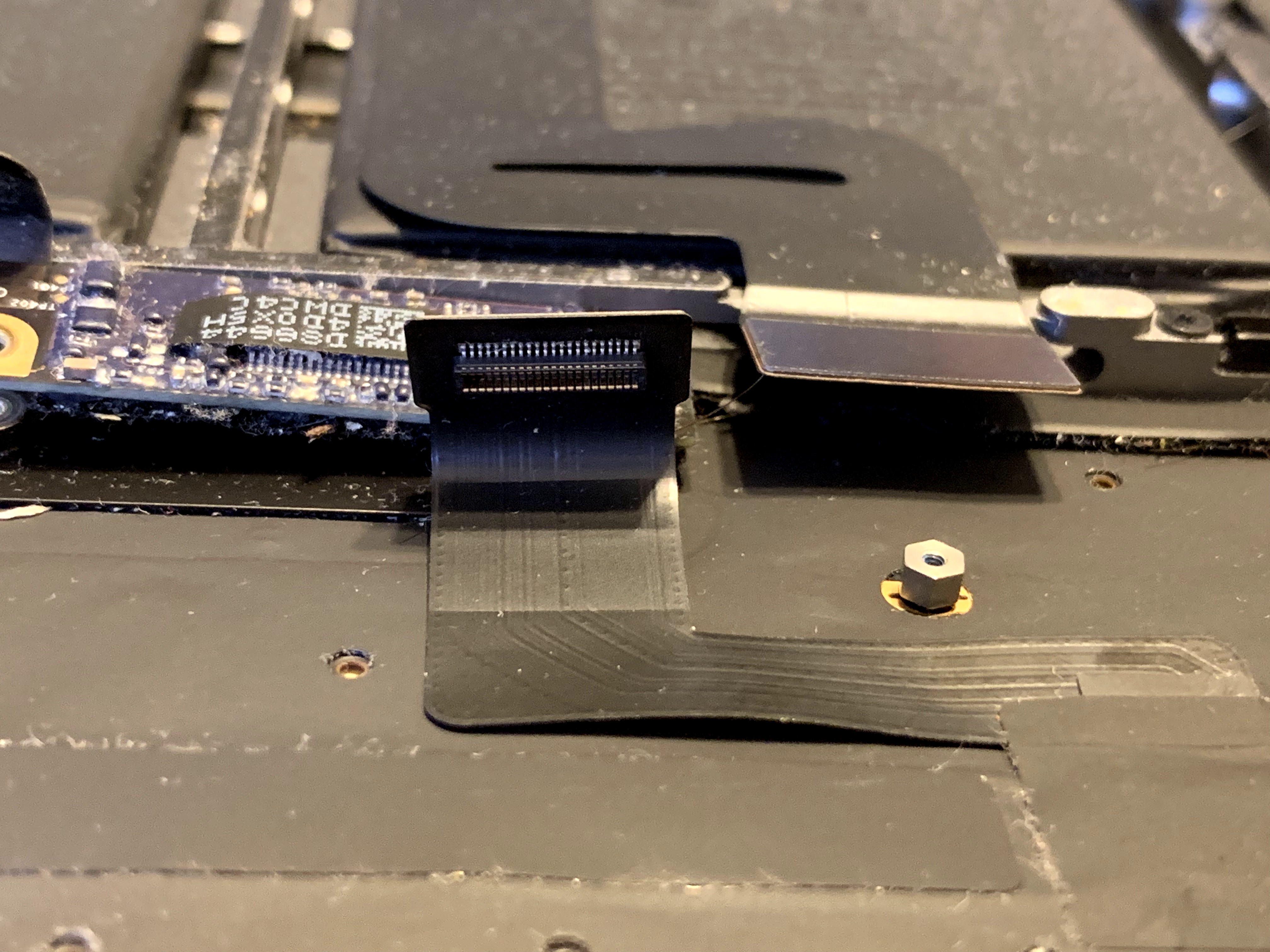

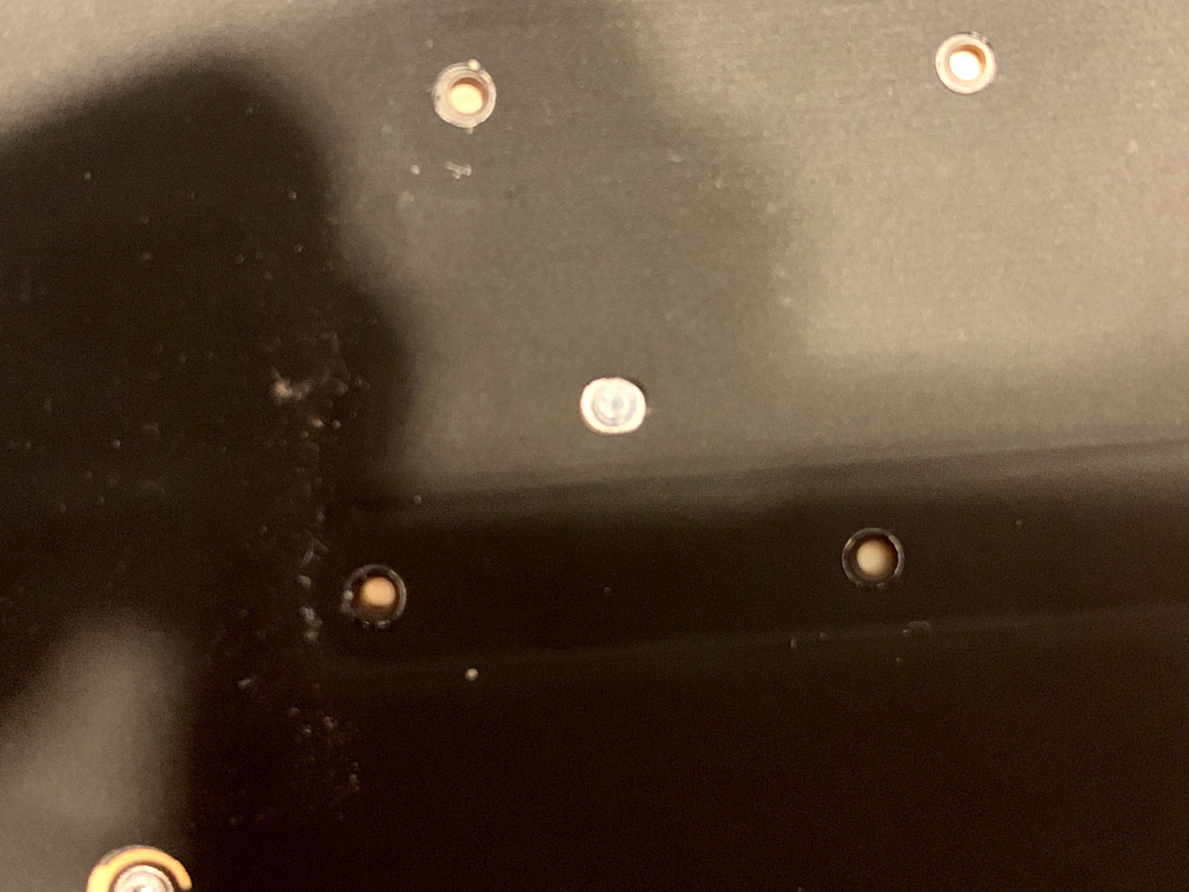

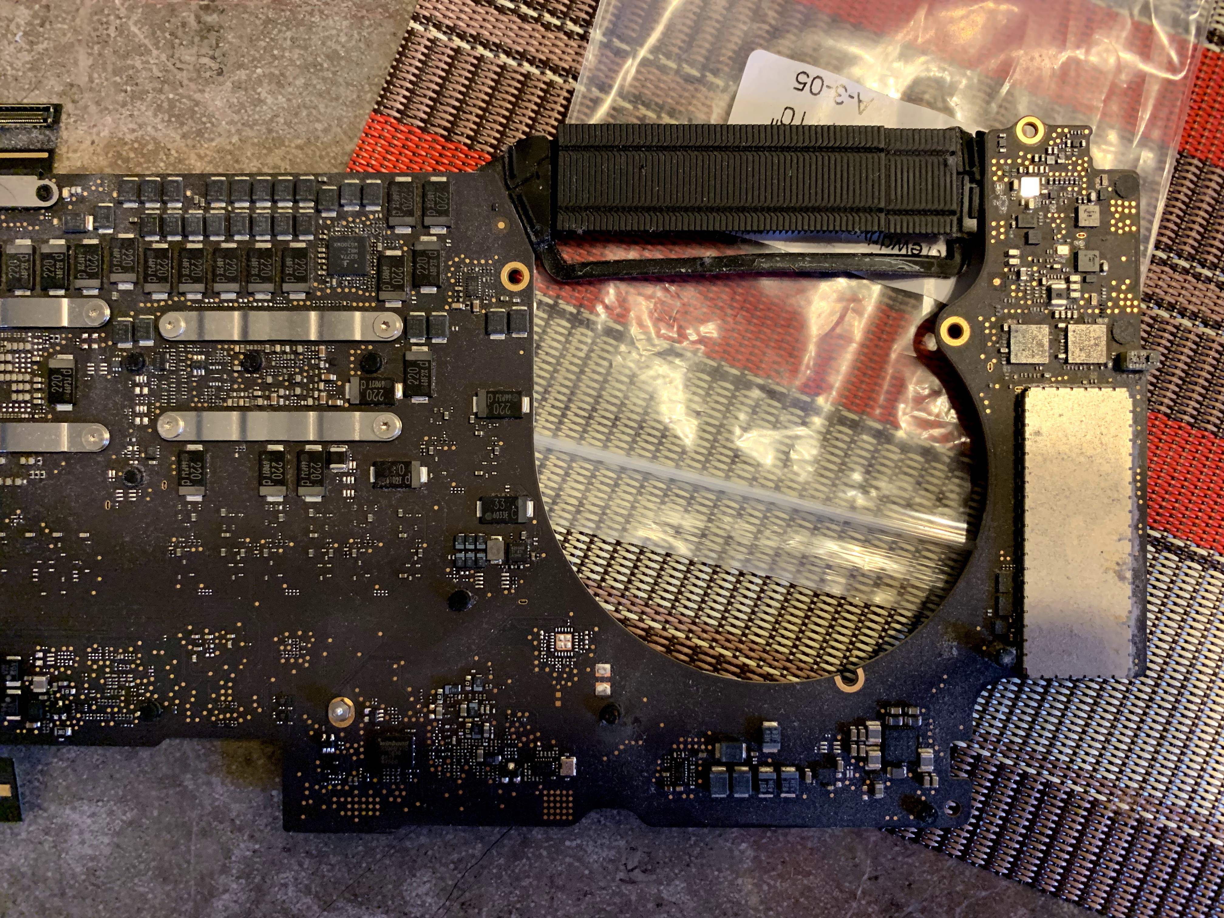

So, I got to work today taking it apart (surprisingly easy when you watch the iFixit videos). From what I can see, there is no evidence of any water damage to either the connectors or logic board, so any problem I assume must be under the black plastic cover of the keyboard. I'm starting to think that this issue may not be anything to do with the wine damage from ages ago.
My question is: does anyone know what the water sensors are supposed to look like when activated? I know that on the older Macs they changed from white to pink, and from what I can see, all of my sensors are white, which would indicate that very little, if any, wine, entered the Mac at all. There are lots of tiny dots on the bottom of the keyboard, but they are simply a standard metal color and don’t appear to be water sensors at all. Indeed, are there any water sensors on the bottom of the keyboard at all? The ones on the casing and logic board appear to be the standard ones I’m used to seeing, and they’re all white.

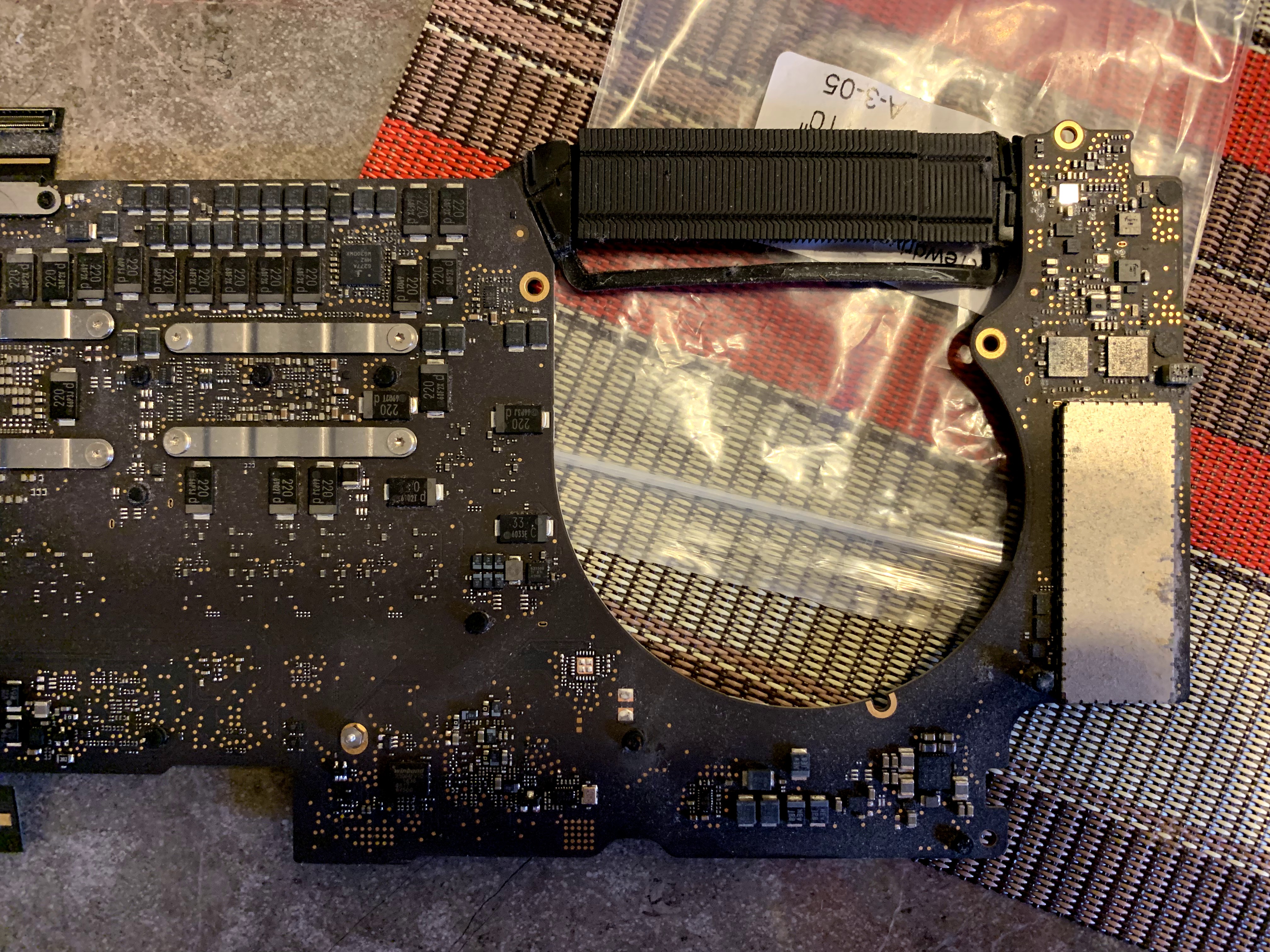

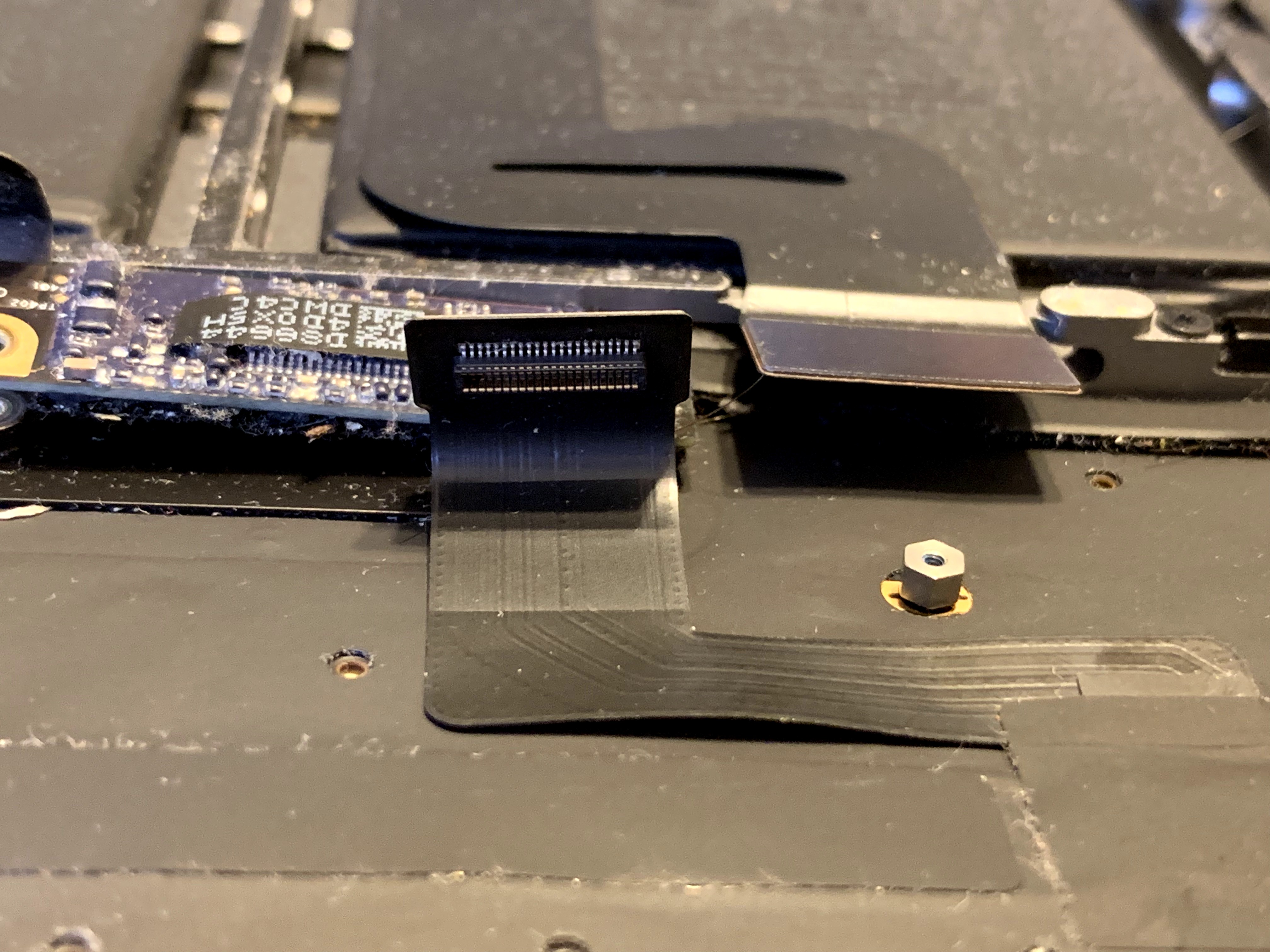

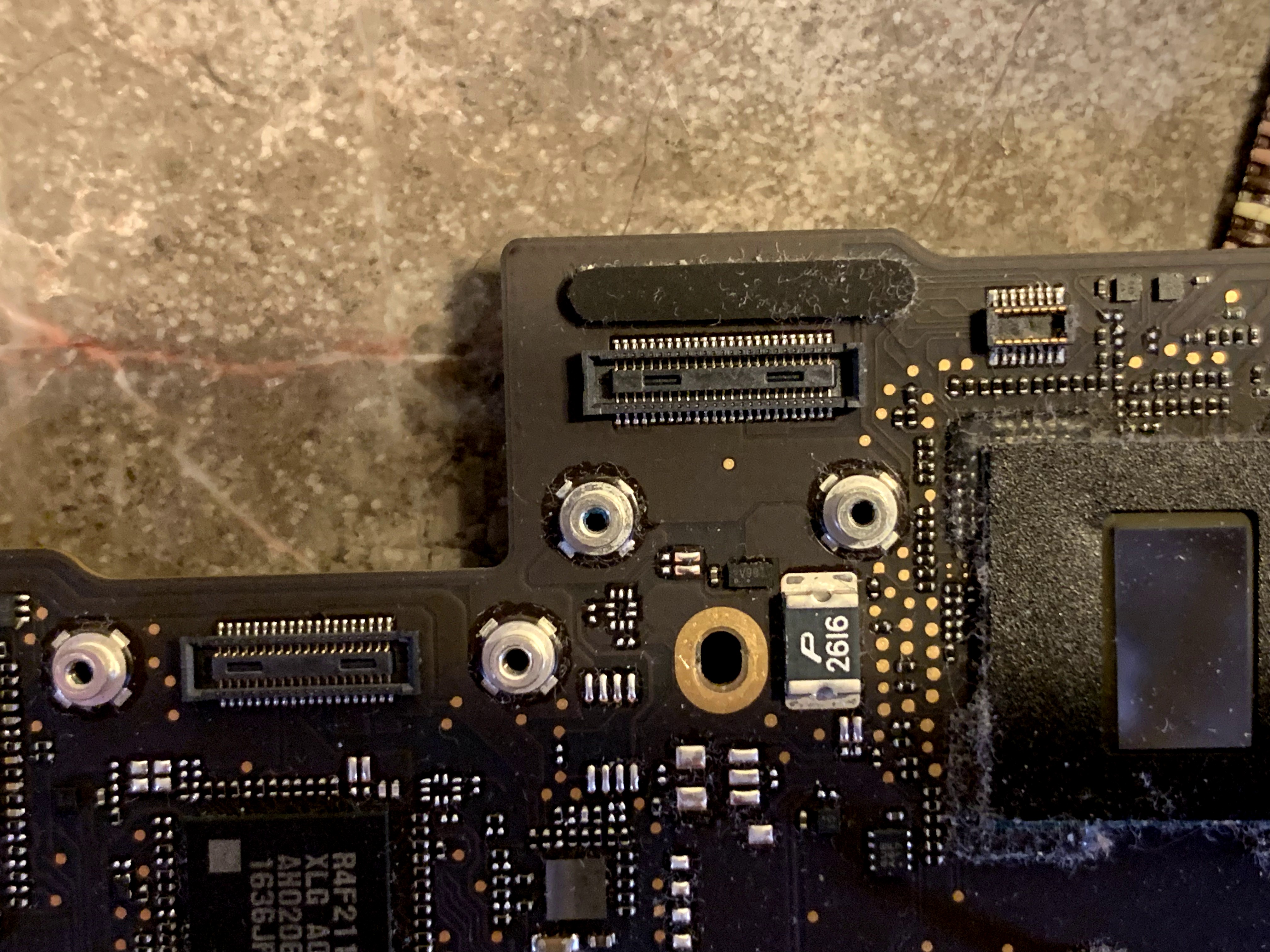

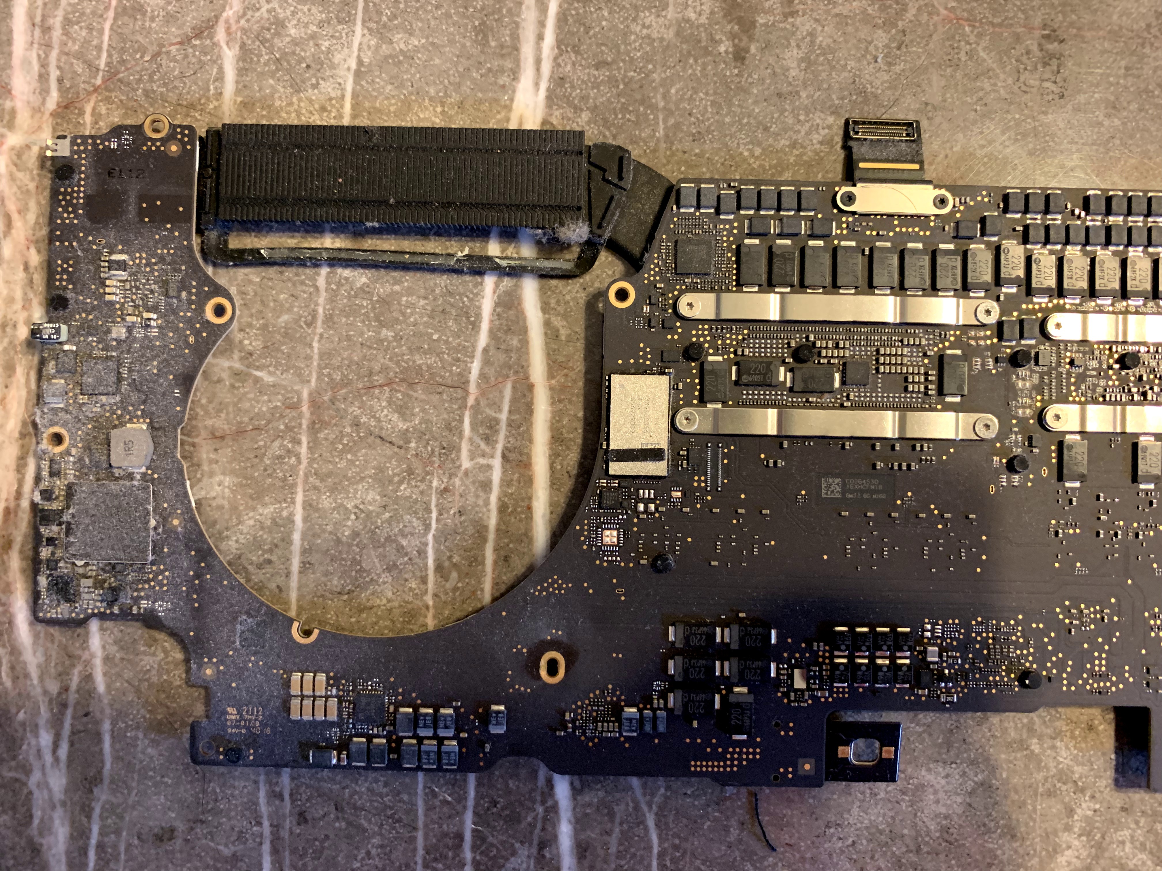

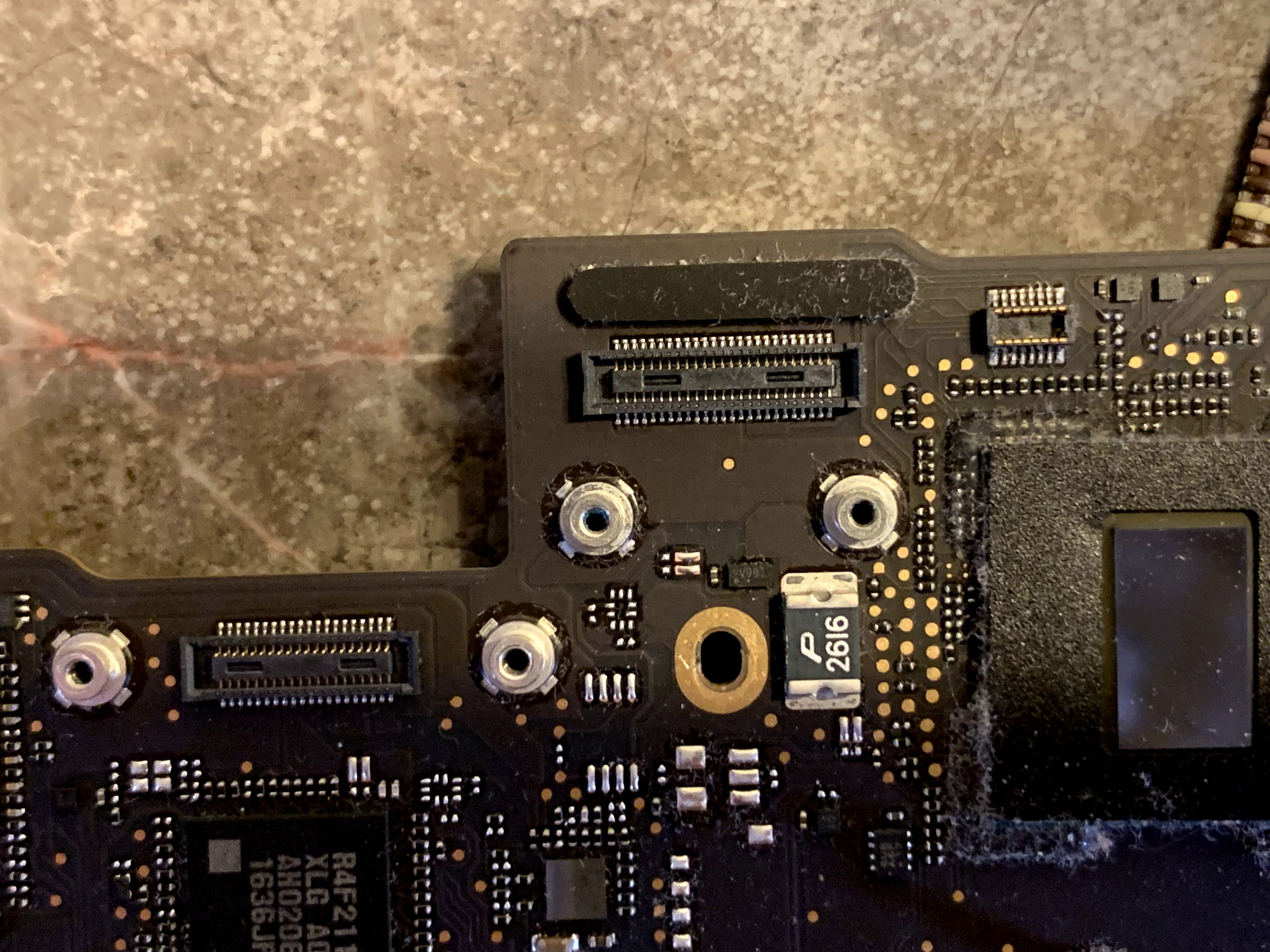

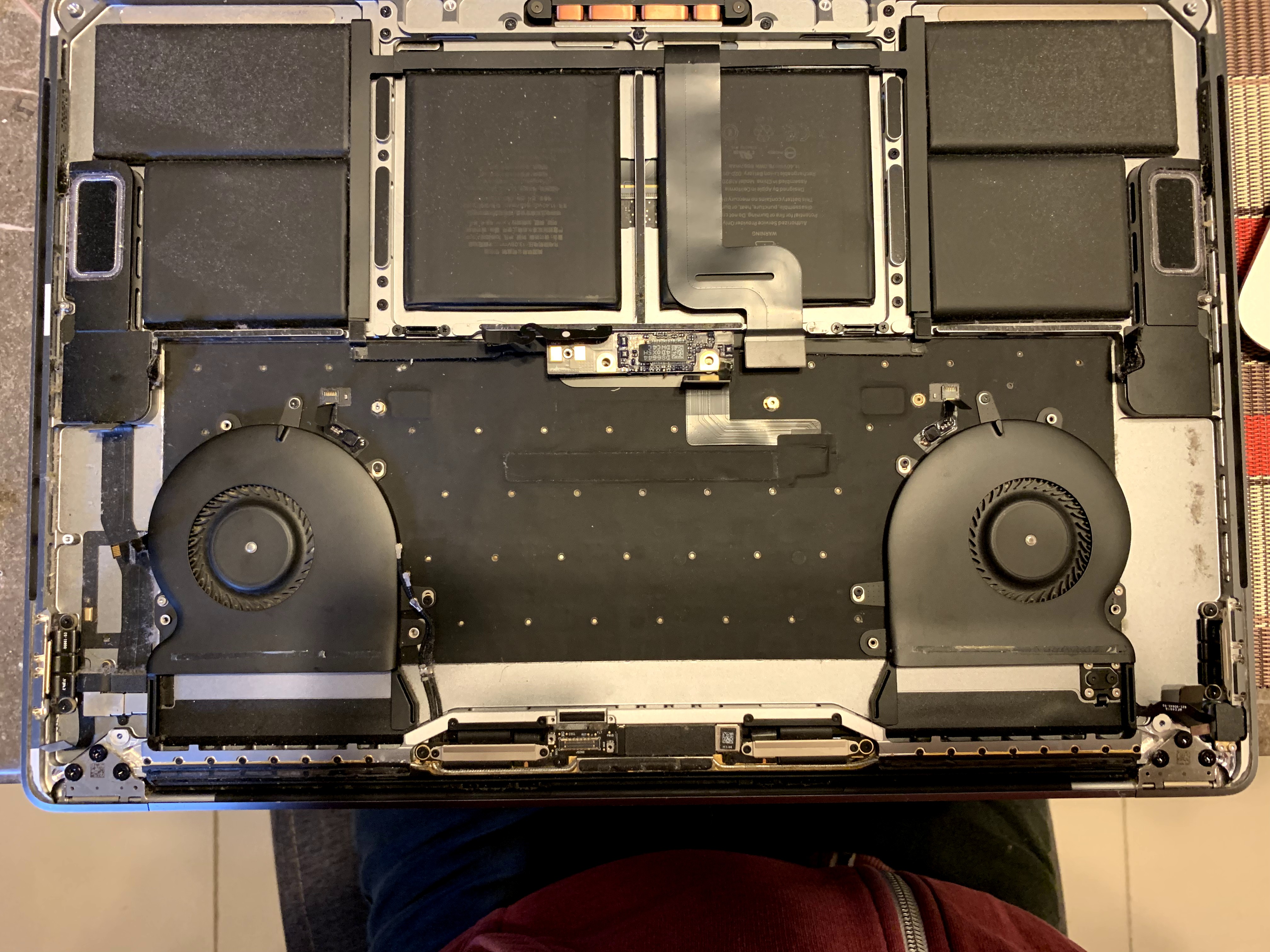

I put the laptop back together and nothing has changed. If someone could look at the pictures below to give me an idea in terms of if they can see any damage / activated water sensors, that would be great. Thanks.
View attachment 829680 View attachment 829681 View attachment 829682 View attachment 829683 View attachment 829684 View attachment 829685 View attachment 829686
Why you didn't show whole second side of the board (this one with main chips like CPU and GPU) ?
Was rushing and forgot to take photos: that side was perfect too.
Just to give a final update on this, I put it all back together and made a Genius Bar appointment under the apple keyboard replacement program. They agreed there was no evidence of liquid damage and replaced the whole top case assembly, including keyboard and battery, free of charge. Very happy with that result.
