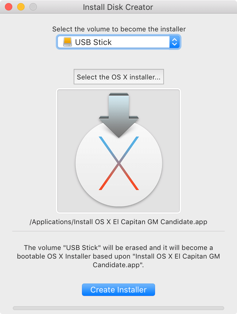

For Catalina, this is what I'd suggest.
You'll need a USB flash drive 16gb or larger.
My recommendation is that you download the following:
Install Disk Creator:
(free app)
This makes it EASY to create a bootable flash drive with a few clicks of the mouse.
IF you're having trouble getting a copy of Catalina, I suggest you use dosdude1's "Catalina Patcher" app to grab it.
You DO NOT have to "patch" anything.
You just use his app to download Catalina, and then quit it and move on to the Install Disk Creator app.
(free app)
