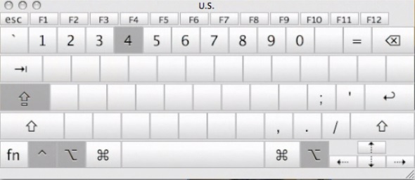

Today, something strange happened to my Macbook 13" (Macbook 7,1 identifier, Mid 2010). After the usual start up I realized that the keyboard and trackpad do not work. Only the numbers on top would work. Trackpad clicks turned into Right-Click anywhere I tried it. After all, I tried to use the on-screen keyboard software to start googling about it, and that's when I realized that the letter keys are not even enabled there.
People offered trying some key combinations upon booting up but again nothing seemed to fix the issue.
While playing with the on-screen keyboard I realized that when I push the key "0" and hold it, everything comes back to normal. All the letters and trackpad. the only problem is that I have to hold the "0" key to be able to use the keyboard and trackpad. that's very strange and I have no idea what's wrong with my laptop.
