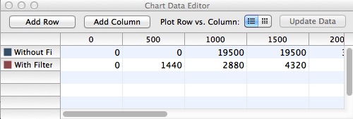

Hi, seems simple enough but I haven't figured it out. I have a line graph in Keynote and I want to have two of the points on the y-axis on the same x-axis value. e.g. x value is 1000, and I want to have two y values on 1000. Effectively the line will be vertical going up.

MisterMe, where do the multiple y-values come from? The image attached is the data editor where I would like under the blue x-value 1000 to have a first y-input on 0 then a second y-input on 19500, so it ends up being a vertical line up between those two points.
If I add another column (x-value) and name it 1000 it just adds another x-value to the graph so would have two 1000's, which is not what I'm wanting. Hope the problem is clearer now?

In your screen shot, the data matrix clearly states that it is set to graph rows vs. columns. The y-values are listed on the rows of the data matrix; the x-values, on the columns. "With Filters" is one set of y-values; "Without Filters," the second set.
Yes I am aware they are the y-values but you can't adjust them to have two y-values for one x-value. Anyway, problem is solved, I used a Scatterplot instead and connected the points.
I'm happy that you solved your problem. My guess is you should have used a scatter plot all along. However, you did not need to "adjust" the original graph to accept two y-values for each x-value. Each row of y-values is plotted against the same x-values.
Using Line graph in Numbers, I thought it might work to add an X column = 999 with Y=0.
Expected that if the graph displays the X-axis in increments of 500 then the 999 column wouldn't be displayed as a "category", but all the X-Y values get plotted and visually it generates a vertical slope in the jump from (999,0) to (1000,1000).
But then I tried it. Unfortunately the Line graph only supports "category" along X-axis. Too bad it doesn't support numbers. That's a major limitation. 🙁
So yeah, as you've already discovered, Scatterplot is the way to go...
