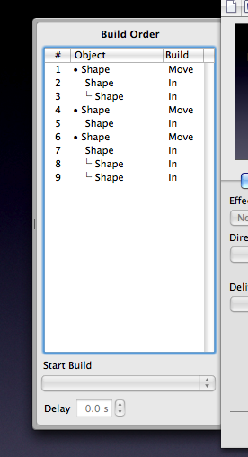

Just to elaborate a bit:
The easiest thing would be to plan out your object's move completely first, so you have all of those builds in place, with the "on click" start already programmed in. As mentioned, this action is under the "action" tab in the animation inspector.
Next, plan your items that will appear at the moving objects first "stop" Choose whatever Build In options you want, and then drag that animation so that it appears just BELOW the first move step (if the first move is Step #1, the first appear will be Step #2). Then under "Start Build" select "Automatically after build 1) and choose whatever time delay you'd like. If you have other images you want to appear with the first one, make them appear just after the first appearing item and have them start their build "Automatically with build 2" (assuming you want them to appear together). Then repeat for each move step.
I don't know if this makes any sense or not. I did a really quick build with one object making three moves with other objects appearing after each move (two objects after move 1, one after move 2, and three after move 3). The moving object moves on each click and then the others appear automatically after each move. Then there is a pause until the next mouse click.
