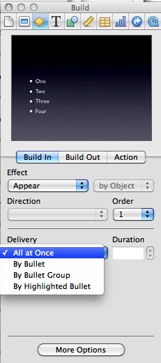

You can make the bullets appear all at one by selecting the Build Tab on the Inspector then toggling the desired Delivery.
There is more information about bullet builds on pp. 116-117 in the Keynote 09 User Guide.

You would have to make hierarchal bullet groups to do that. Probably somewhat different from PPT, but nonetheless would allow groups of bullets to appear together.

Thanks for the reply, that seems to work. It does seem a bit of a kerfuffle though to manually indent a bullet and then change the indent back to that of the "first-level" bullets...

Actually one could make another work around by using two bulleted text fields and aligning them so they appear as one with each text field set to "all at once." Click once the 1st set appears. Click again and the second set appears. In the Build Inspector, click on more options to make sure the 2 builds are in the correct order.
