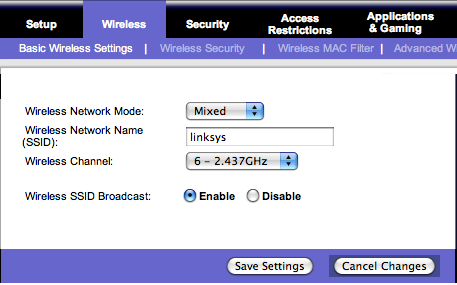

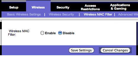

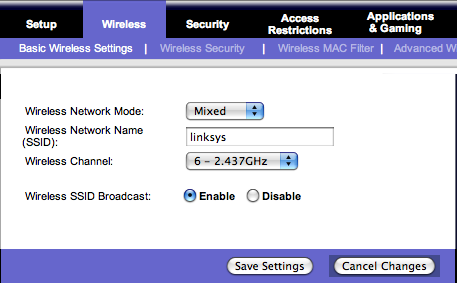

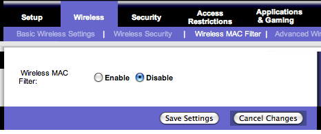

Okay, I was able to log into my router set up, and I found the section of the setup that enables or disables SSID broadcasting, and it is currently enabled. So I'm assuming its as simple as just disabling it and saving the changes. The same goes for the Wireless MAC filter, it is currently disabled, and it should be enabled. correct? What does disabling SSID broadcast and MAC filter actually do and how does it keep my setup more secure? Thanks for your help by the way, I'm learning some new stuff here.
When you click on your Airport icon, you see the different networks around you, right? Well disabling broadcasting your SSID will make your SSID not show up on that list. But if someone wants to they can still see it with other software even if you don't broadcast it.
MAC filtering allows certain people with the correct MAC address on their wireless card to connect to your router, but you can spoof MAC addresses easily, again with software.
WPA2 Personal is enough, IMO. Just make sure it is a strong password and also make sure your router password is strong too. If you need any more security than that, then whoever wants to get in that badly will probably get in through other methods.
