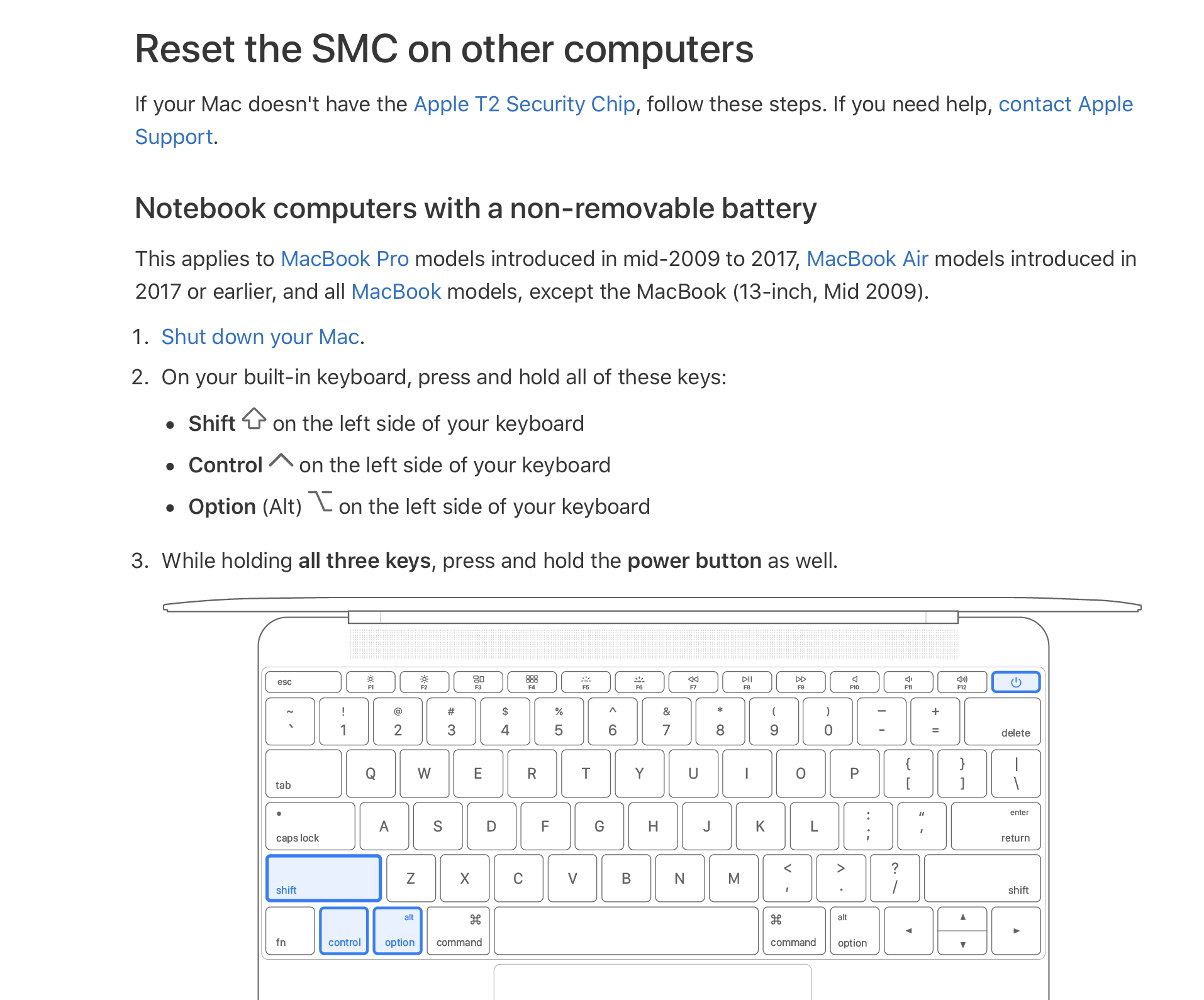

4. Try resetting SMC (see screenshot below) this may seem futile starting from where you are, but I once had an apparently dead MBP and Apple said reset the SMC, which I did and to my amazement it booted.

You may indeed need to reset SMC (affects startup and power systems) or NVRAM (includes default video parameters) https://support.apple.com/HT204063

The SMC reset process requires the machine to be shut down before starting.
