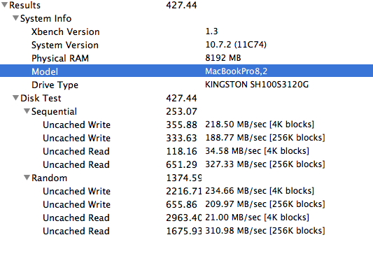

anyway, i did an xbench. not sure what all that means?

Well, I don't know exactly how Xbench tests, but your numbers are all within about 20% of mine, and I have a 6Gbit SSD that's performing properly. Which is to say that it sure sounds like it's just your benchmark app acting up, and your drive is running normally.

One possible difference is that Aja is doing straight-line, high-bandwitdh transfers--large blocks, sequential--which will give about the fastest throughput rates a drive is capable of. Xbench tests both small and medium blocks in random and sequential, which generally exposes the strength or weakness of the controller more than the raw theoretical speed of the SSD--the better the controller, the better the small block results will be. It's even possible that upgrading the drive's firmware will help.
As for the other app you're using, I have no idea; maybe it uses some mix that exposes a weakness in the controller, or maybe it's just doing the test in a way that's unreliable or doesn't repeat well.

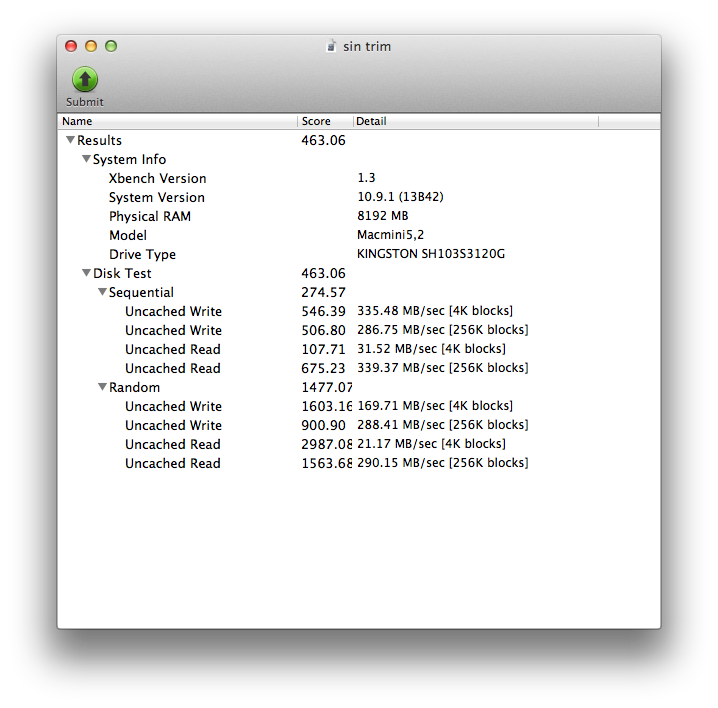

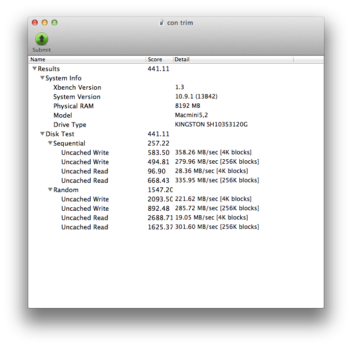

Hi!
I just bought a Kingston hyper 3k 120GB and installed it on my mac mini mid 2011 and i'm a little bit worried about the advertised speed and the bench scores.
They are different with and without trim, getting higher score without trim.
