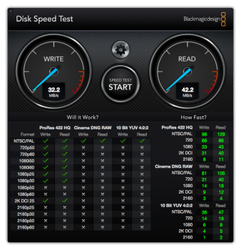

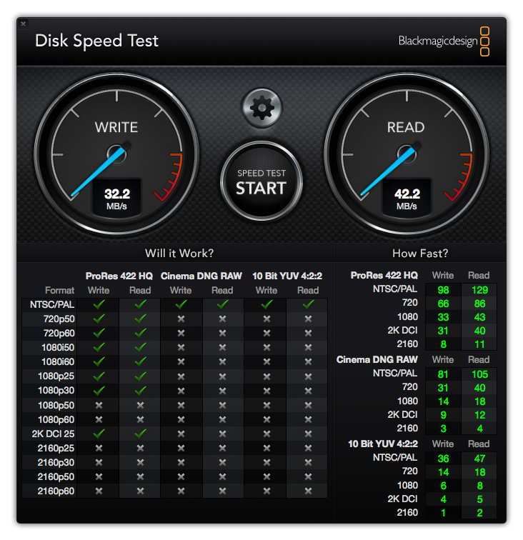

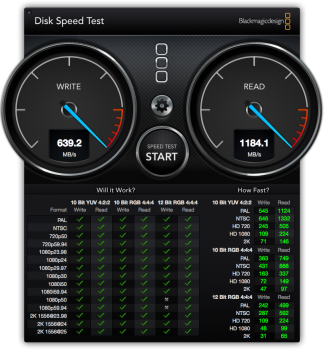

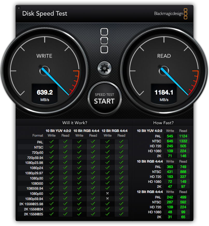

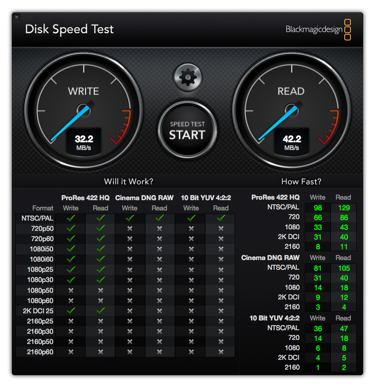

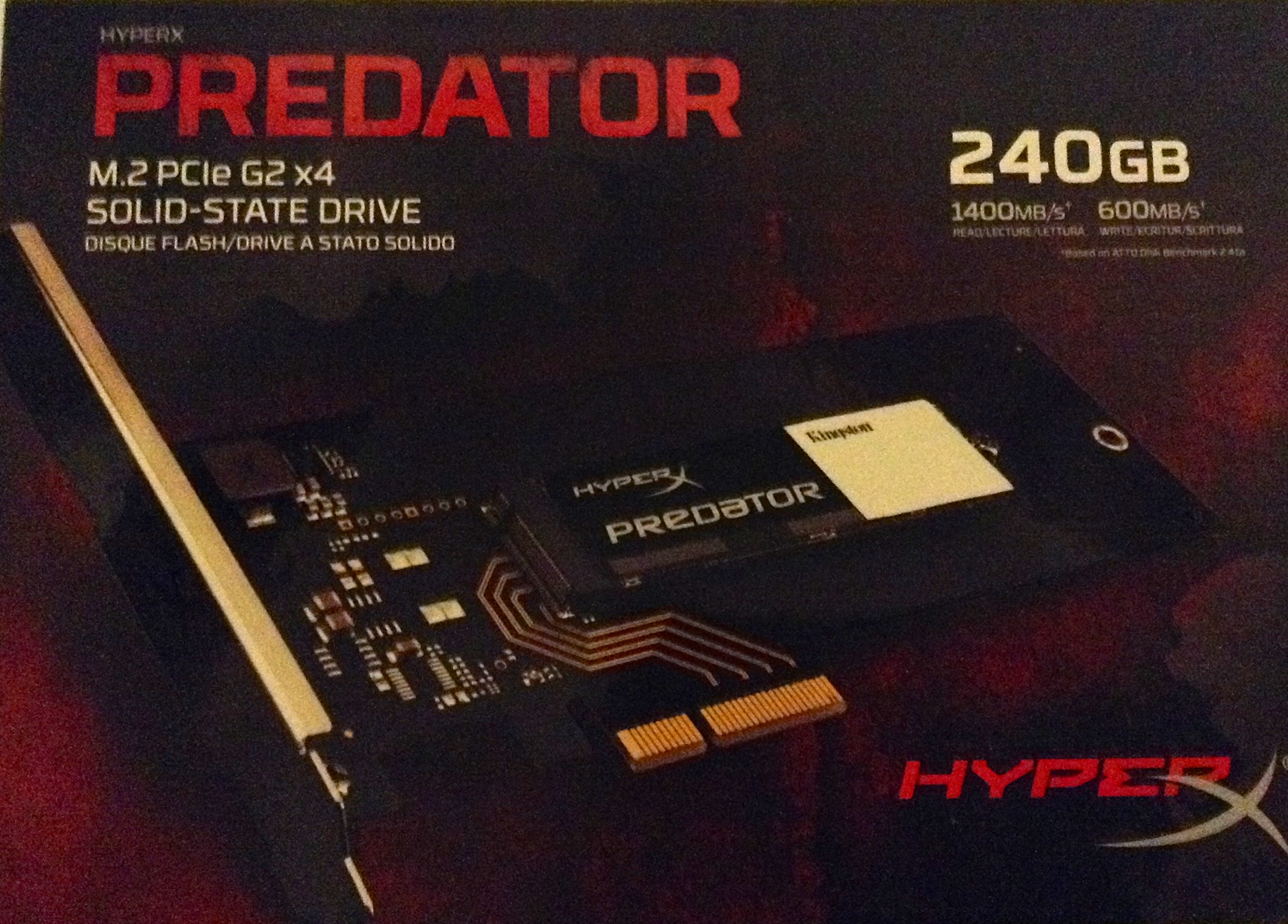

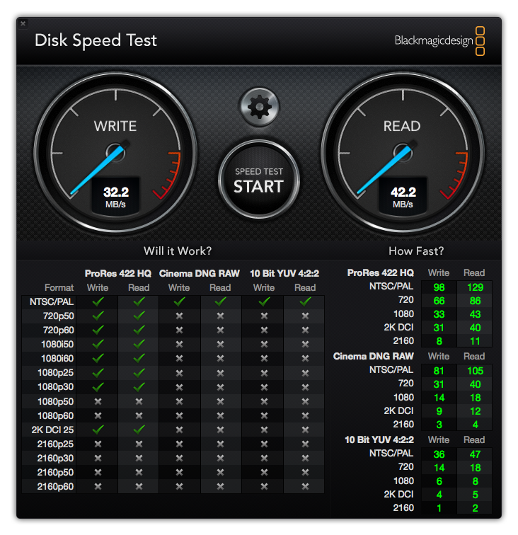

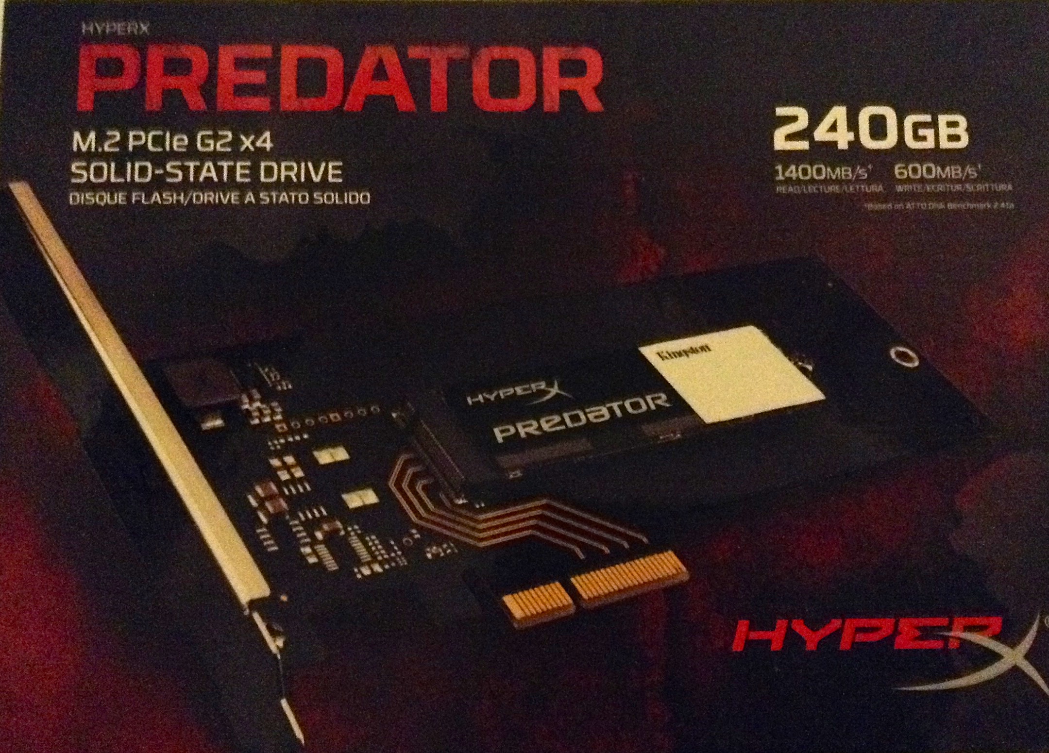

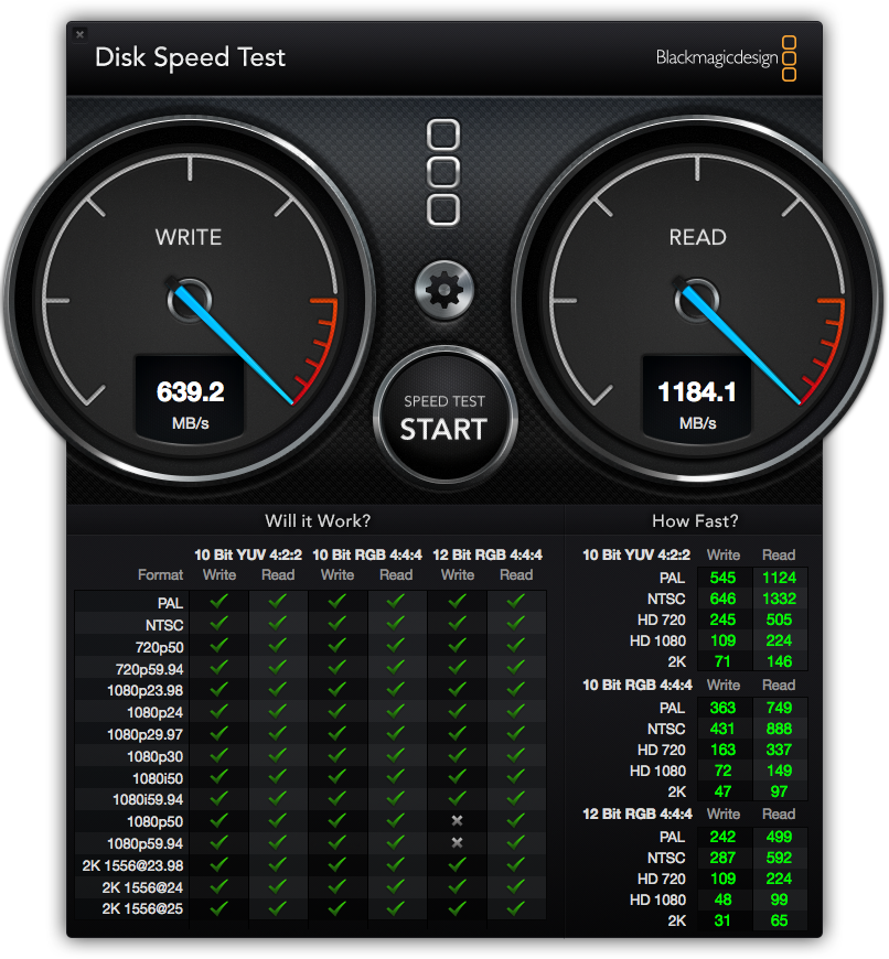

I'd like to put the hyperx predator 480gb in my 2008 3,1 mac pro as the boot drive. But, I've been told it won't work. Have you had any issues? My current write speed is only 60mb/s on the original 320gb drive!
I have the Kingston HyperX Predator 240GB as my boot drive in a MacPro3,1.
Worked fine right out of the box.
Reportedly it should be faster.
