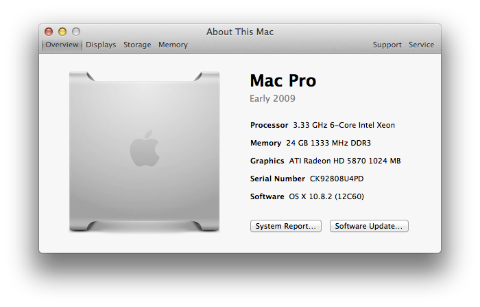

Huh? I upgraded my pro to a hex core 3.46 Ghz 3690 and added 4x 8 gb Ram for 32 GB and it runs fine at 1333MHz?
Wow. That's odd. Mine definitely gets down-clocked.
Yours reads as an "Early 2009". Maybe the 4,1 firmware doesn't allow 1333 MHz RAM?
(I didn't even think it was possible to put a hexacore in the 4,1 without updating the firmware.)
This is probably because the memory module in the 4th slot only supports 1066MHz clock speed. If the 4th one also came from the same kit, you have a very good reason to exchange it.
(I didn't even think it was possible to put a 6-core in the 4,1 without updating the firmware.)
He did the firmware upgrade and that's why he could install a 6-core. As mentioned before, the "Early 2009" display is based on the serial number and has nothing to do with the firmware version. I recently upgraded to 2.93GHz 8-core for my 2009 MP without upgrading to 5,1 firmware, but it still shows 1333MHz memory clock speed because the X5570 supports it.
Whoops. I always just assumed the description was linked to the model identifier. Thanks for setting me straight.
Ah, but I bought my Mac Pro as a 2.66 quad from a refurbisher with the RAM preinstalled and advertised as being DDR3 1066 MHz. So finding that it works in triple channel at 1333 MHz is a bonus, really.
Yes, that's right.
