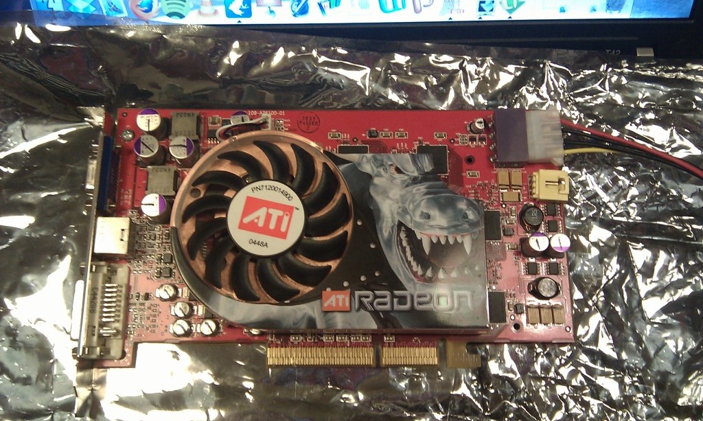

I have no idea. 256mb, that I know.
Post pic of the card please.
No, I do not. But that would give me a **** resolution, not no signal at all. And i tested every port available, VGA, DVI and S-video.
It depends on OS and ROM used with card. All of FGL X3 I've flashed were giving no signal in 10.4 and grayscale video in 10.5 without ATI Display installed. After that all was as it should. All of this with reduced 64k ROM. ATI Displays isn't only driver and preference pane, it also installs ATI ROM Extender which is required to run cards that use reduced ROMs.

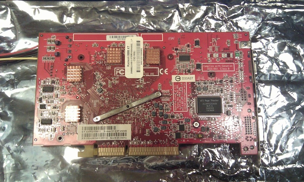

Pardon the quality. Mobile is the best I can do since I don't own a digital camera.
Ah, I see. Well, the seller said I'd need it to run anything above SVGA, otherwise it should work. Anyway, I'm pretty new with legit Mac's not to mention mac modifications, so pardon my ignorance.

OK, so one thing is clear: it will output video only via D-Sub, because it's real X800, not the Fire.
So: try ATI Displays 4.5.7 first - if it isn't an issue it won't hurt. If it won't help, try 2 more basic troubleshooting methods:
- triple check pin taping (do you hear "chime" sound BTW?)
- login to your MDD remotely (via ssh or VNC) - if you have another Mac by the hand, and see if card is properly recognized in System Profiler.
Comment
