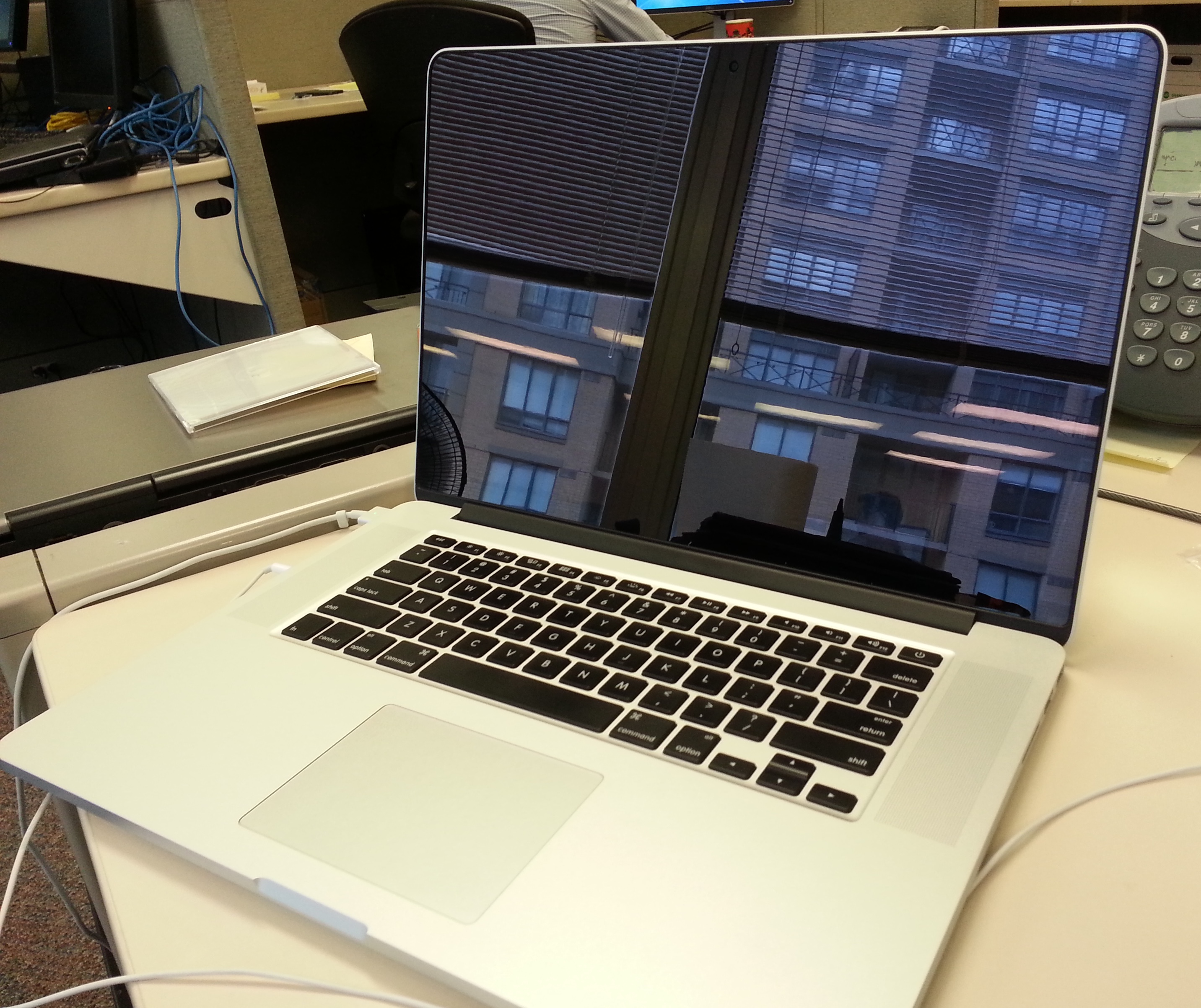

awesome! do you have pics to show us?
Ask and yee shall receive. Photo is a bit overexposed, it exaggerates the glossiness a bit, it isn't that bad.
