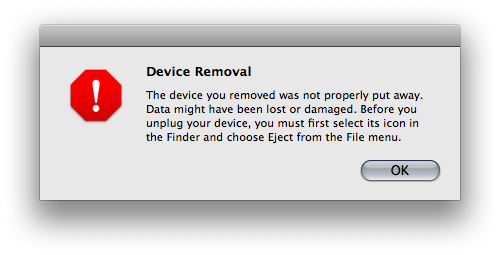

Do you get this dialog when the drive ejects?

That is the exact message Blue
