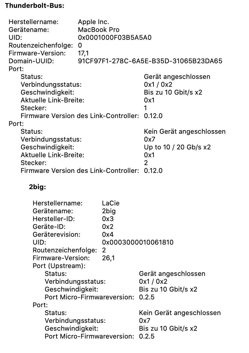

Hi y'all! I have a similar problem with a used 2big TBT 10TB that I bought. I am using a 2013 Macbook pro with OS Catalina.
The Thunderbolt Raid will show up in the system profile, buther neither in the Lacie Raid Monitor ("unsupported RAID detected"), nor in disc utility. After I took the two Seagate 5 TB discs out of the Raid and put them back in, they showed up in the finder and disc utility for a short while, but then ejected themselves, not to be seen anymore. Any help is greatly appreciated.
