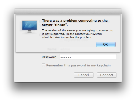

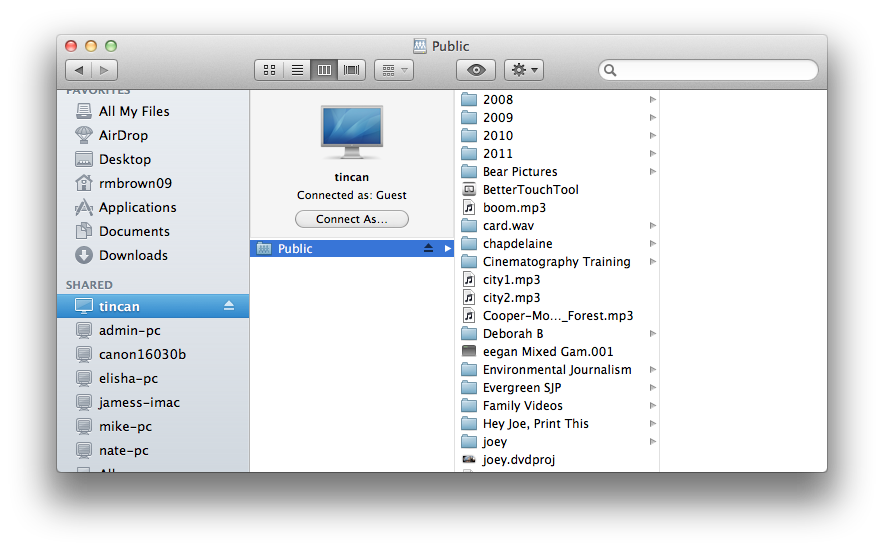

>Above is the 6TB 5Big that with SL works just great.
>Going through finder to shared we can see the 5Big just fine, and connect even to the unsecured (no password) folder. See Pic
>When trying to connect to the secure folder however, this error is presented.
>I have been using transmit in the meantime, but that requires files be download to use 🙁
>Via finder I can run DMG's or whatever straight from the drive.
>Any ideas? The firmware is up to date and Lacie seems to not have a good answer for me after multiple contacts. Thanks.

This probably has to do with Apple updating and dropping support for the use of afp “DHCAST128″ because it was supposedly insecure. Netatalk 2.2 should be supported with Lion, but until Lacie releases a firmware update, you will have to use Cifs/SMB to connect to you network share.
There is a hack you can try:
To turn on “DHCAST128″ support please do the following on your Mac running Mac OS X 10.7 Lion:
1) Launch /Applications/Utilities/Terminal and do:
sudo chmod o+w /Library/Preferences
Then:
defaults write /Library/Preferences/com.apple.AppleShareClient afp_host_prefs_version -int 1
Now Quit from Terminal and restart your computer.
2) From Finder, select an AFP server, or use “Connect To…”. This will cause the AFP Client to create the full preferences file
3) Launch Terminal again and do:
sudo defaults write /Library/Preferences/com.apple.AppleShareClient afp_disabled_uams -array “Cleartxt Passwrd” “MS2.0″ “2-Way Randnum exchange”
Then:
sudo chmod o-w /Library/Preferences
Note: To add a “DHCAST128″ to the disable list, use
sudo defaults write /Library/Preferences/com.apple.AppleShareClient afp_disabled_uams -array-add “DHCAST128″
Let me know how it works out for you.

Thanks for the post, I did the steps (no idea what was being done) but to no avail.
Same error connecting via Finder or "Connect to Server."
Hope Lacie or Apple or whoever fixes this soon. We were going to update the computer lab to Lion, but perhaps we will wait a few .xx's.

Transmit connects because you are using an entirely different protocol to connect to the share. In this case, you are using SFTP (Secure File Transfer Protocol). AFP (Apple Filing Protocol) was the protocol updated by Apple.
The updated AFP in Lion adds more security in terms with connecting to shares. Current NAS boxes do not support this added security which causes the problem you are currently having.
When you did step two, did you try and login to your share or just allow it to connect? I suggest trying it again, copy and paste. But this time in step two, when it asks you for the user name and password, just leave the dialog box open and restart your computer without logging in and go to step 3 once the restart is complete.
