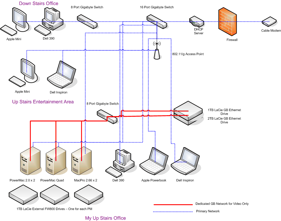

Hodgjy is correct. You cannot use multiple interfaces concurrently. If you want to go cheap, get a 5-8 port gigabyte switch/router/firewall which acts as a DHCP server. You can get them for ~$145. You can even go cheaper by dropping the firewall/DHCP (you will have to use static IP's). Connect the LaCie to either computer and mount the shared volume on the 2nd computer. The downside is that the connected computer must be on. Here is my set-up.
http://att.macrumors.com/images/attach/gif.gif
