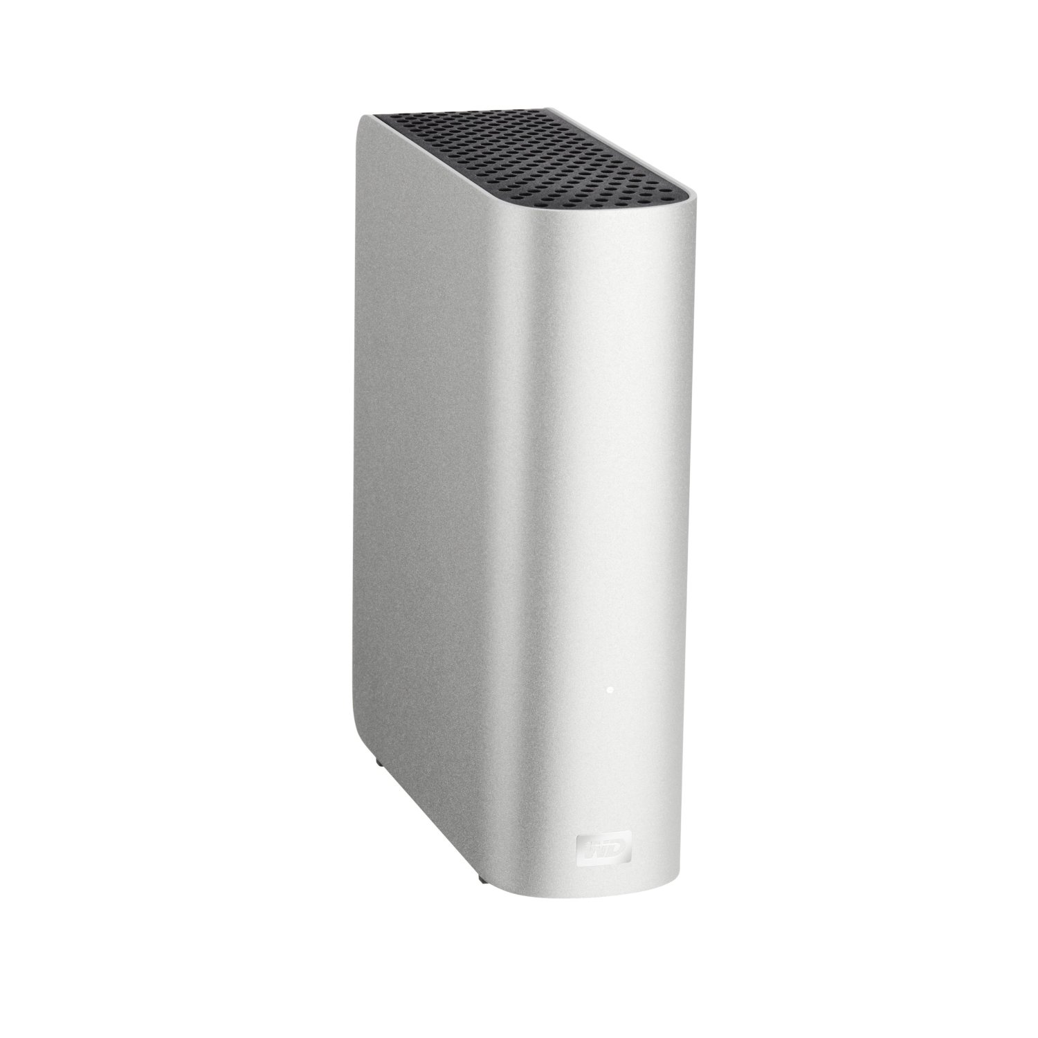

Other than that, maybe a Western Digital MyBook Studio?
