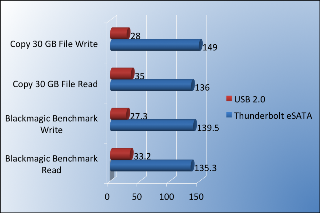

    I noticed that the Lacie eSATA Thunderbolt hub was for sale at the Apple store and decided to give it a try. I used an external 3 TB 7200 RPM hard drive from G-Technology for the tests.
    I was also curious to see how daisy chaining would work and whether the Lacie could output a mini displayport signal. So I connected a mini-displayport to DVI adaptor which was then connected to a Dell U2412M. The good news is that this works so if you're looking for the cheapest way to connect an ACD (or any other monitor for that matter) to an ATD, then putting this hub after the ATD is the cheapest way of doing it.
    The good:
    • Solid construction and looks good
    • Full eSATA (SATA II) speed - check out the chart below
    • 2 eSATA ports
    • Mini Displayport pass-through
    The bad:
    • Pricey for just eSATA ($199)
    • It's not huge, but it's bigger than a typical external 2.5" drive. Is that really necessary?
    • Requires own power adaptor. Surely it could get power via Thunderbolt? I really don't understand why it needs a power adaptor. This adding boxes to make your computer do useful things business gets really old when each and every box requires its own power adaptor with slightly different specifications. I've got a drawer full of them now and cable management becomes a nightmare.
    • Why no USB 3 or Gigabit Ethernet? Seriously, for $199 they could have added more than just 2 eSATA ports. eSATA is pretty good if you've external mechanical HDDs, but not adding USB 3 is a serious oversight in my opinion. eSATA is not good enough for the latest generation SSDs.
    The Lacie thunderbolt hub does exactly what it says on the box, but whether a typical consumer is prepared to pay $199 to copy and backup (a lot) faster is another question.
    [​IMG]
    Figures are in MB/s (Mega bytes per second)
    Tests were done on a 2011 MBA

    The g-tech drive does have a FireWire interface, but due to some logistics I won't be able to retest it until next week. I would expect around 80 MB/s via FW 800 based on previous experience.

    I'm getting about the same speeds on a quad interface 7200rpm drive using Black Magic speed test. It's about 2x faster than Fw800. Is it really worth the cost $250 with cable .... hmmmmm don't know as it has just 2 esata ports. I was going to do a mini review on my blog. Will post when I get her done.
