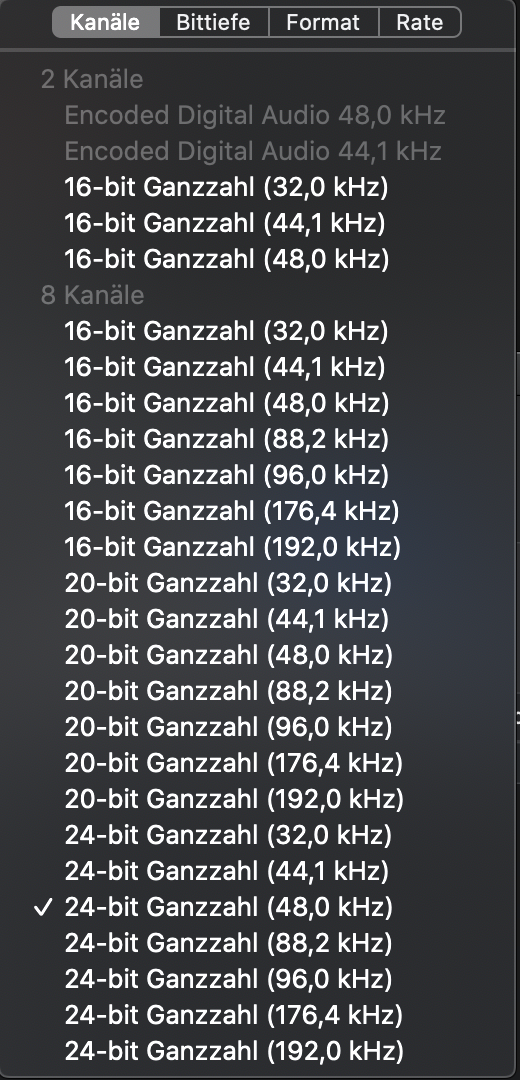

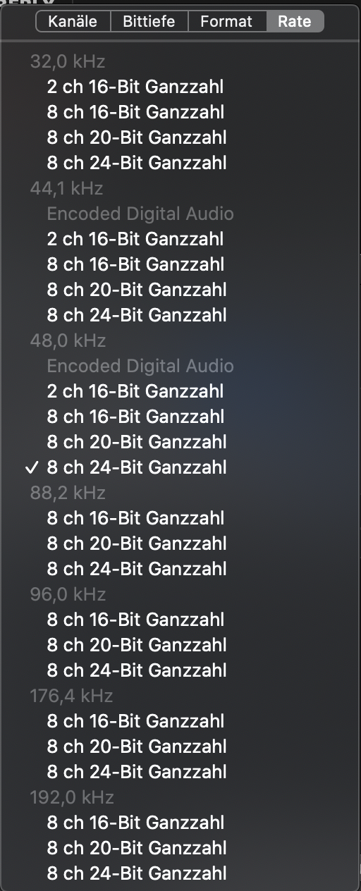

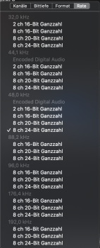

If you look in Audio Midi Setup, what does the HDMI adaptor show as its output and Speaker settings?
Hmmm, here are screenshots from the settings. Speaker config was set to 2 speakers strangely, I set it to 5.1 surround but it had no effect, and if I click on the speakers to test them, the only ones that output the test noise are front left and front right, the others remain silent. Bildschirmfoto 2020-02-22 um 20.45.24.pngBildschirmfoto 2020-02-22 um 20.45.36.png
