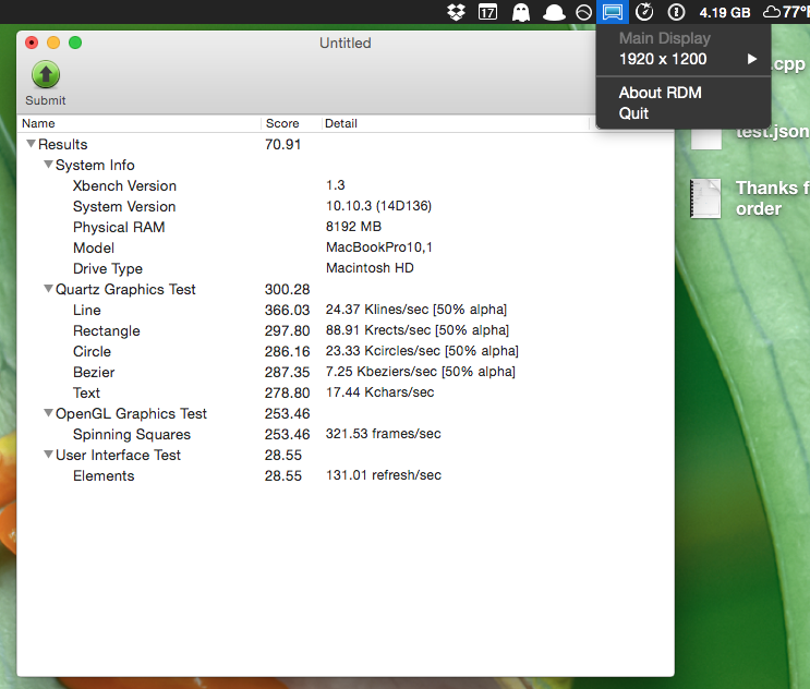

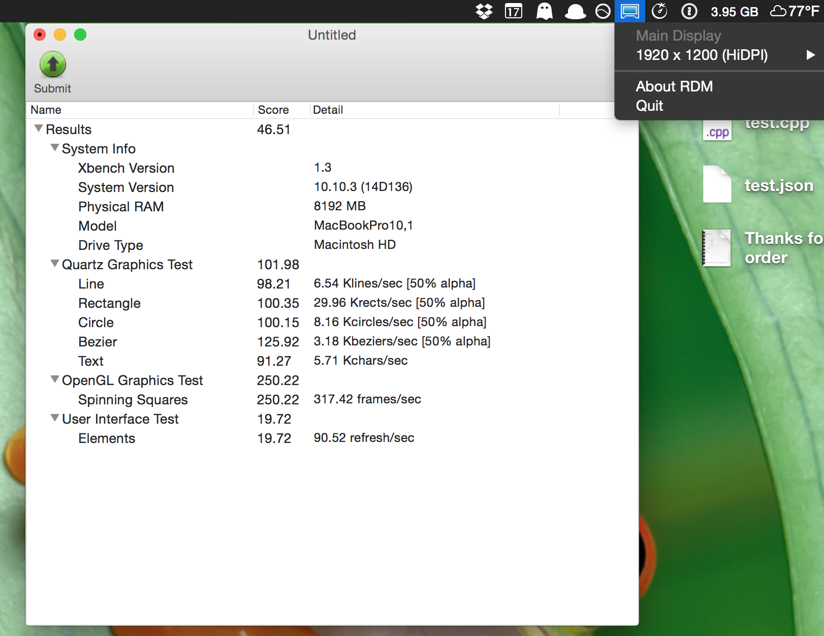

First of all my post is a rant that lag on the rMBP exists when using HiDPI resolution. The current rMBP are power enough to handle HiDPI but with lag.
If you can't understand that than maybe you can't perceive lag.
As for proof, just run a xbench with the same resolution using HiDPI and not using HiDPI. The non HiDPI will perform at least 40% faster on graphics test.
Attached xbench graphic results running in HiDPI and non HiDPI on 10.10.3.

Indeed. Apple's current solution is fundamentally inefficient. It's a software problem.
The power required for running games vs rendering OS UI elements at 60 fps are two totally separate problems.
You can see in the benchmark I posted above the OpenGL scores are almost the same. Games mostly just use OpenGL. However the Quartz and UI test are where the differences are.
If it was such an easy problem to fix why hasn't Apple released a software fix already.
When the xbench for HiDPI and non HiDPI modes give the same results under OS X, then I would say the issue is resolved.
