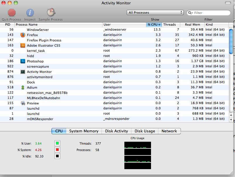

AppleGoat
macrumors 6502a
I'm on my second 13" MBP i5 2011. The first one I mistakenly feared had heating issues. Upon returning it within the 14-day window, I discovered the first could not be such an anomaly, as the replacement became just as toasty under similar load. For a while, I have suspected the replacement is not as snappy as the first one. It may sound like nitpicking, but certain applications take a jump or two more to open and the stacks don't emerge from the dock with as much aplomb. Currently, I have a 172 MB PSD file open but minimized and the whole system is sluggish and not quite as responsive. It sometimes lags even when switching from one tab on Firefox to the next. The dictionary app which usually pops open takes a few hops and my iTunes tracks skip at times. Is this normal? Does this sound an issue that could be sorted out by an SSD?
Could be any number of things. Lack of RAM, spotlight indexing the drive, rogue process eating away your ressources, etc.
There probably wasn't a heating problem with your first MBP, they all run hot and are designed to do so, if it's not shutting down due to the heat, you're good to go.

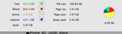

Open up activity monitor, display all processes and sort by processor usage. Also show us the pie graph of the memory with the page ins and outs, we'll go from there.
It's not as laggy at the moment. However, I just launched Chrome, which was open 10 minutes ago, and it took 5 hops. Chrome has never launched in one hop from a start-up like it had in my original i5.

+1 for spotlight indexing, especially if you immediately dumped everything from your old computer onto the new one. I'm curious as to what's eating that much RAM. It looks like you have a few of the CS5 apps open.
Get more RAM. Paging out indicates that you are having to use the swap file on your HDD quite a bit, which in turn is probably responsible for the delay/lag in doing things you are experiencing.

As for whether an SSD will help, it will, but only to a certain extent. Apps will load a lot faster, large files will open a lot faster and it will help to a small extent with the page filing. However, you will most likely still feel some lag/delay when doing normal tasks, like switching tabs in Firefox or switching between already running programs.
If you are frequently working on large PS files (among other things), you will probably get more benefit out of getting 8GB of RAM. As RAM is so cheap these days, it would be silly not to give it a try before opting to go the SSD route.

Looks like you're paging out quite a bit which would indicate you're running out of RAM often.
Upgrading to 8Gb could be an improvement for you.
