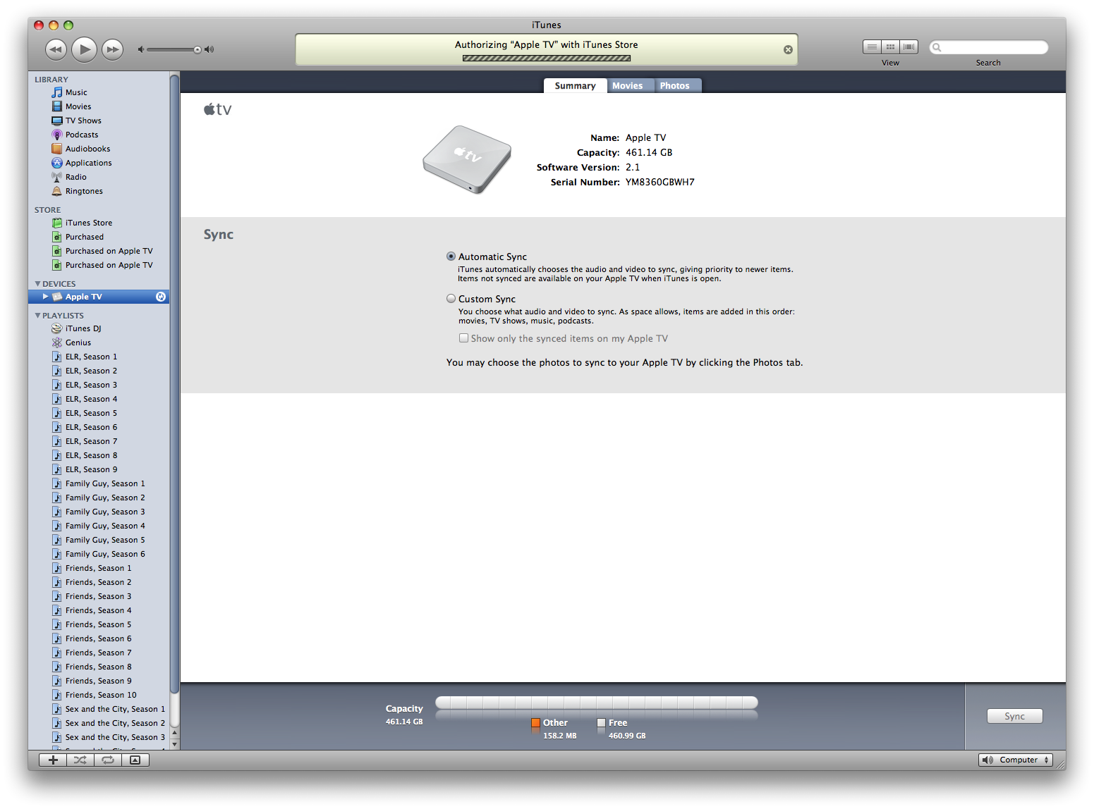

Think I found a valid converter...
Unfortunately I don't have the ability to test it yet...
But I found this:
http://www.cooldrives.com/2sahadrtoide.html
That's a 44pin -> SATA converter... since it's 44 pin IDE, it doesn't require any external power source. So, I believe that what would work would just be:
AppleTV PATA Cable -> Converter -> SATA 500GB Drive (such as http://www.wdc.com/en/products/products.asp?DriveID=506)
The only thing I'm unsure of is the PHYSICAL size of the adapter... it's small, (69x14x17.5mm), I don't know if it's small enough to fit in the AppleTV, and I'm a little hesitant to spend the $120 (Drive+Adapter).
Any souls out there braver than me? (Or any souls out there w/ $20 and a spare 2.5" SATA drive?)

Sorry I should have explained a little more. If you click on the link in my last reply, I'm detailing what's wrong there (to save me having to write it twice......as these posts are pretty similar).
My Apple TV is working fine, in fact I'm exactly half way through syncing 361Gb, the problem I have is fitting it into the Apple TV enclosure.
Here's the post where I have gone into a little more detail.......https://forums.macrumors.com/threads/683178/
