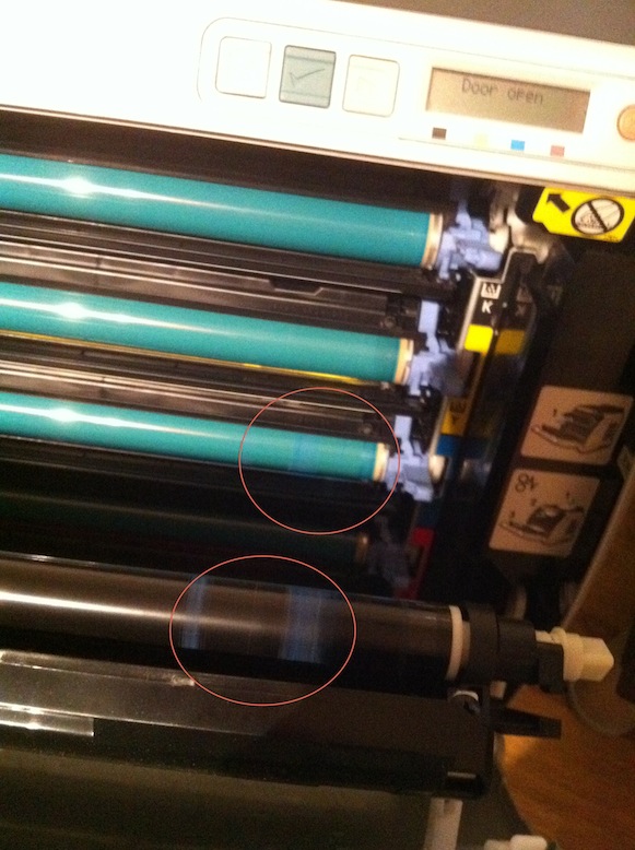

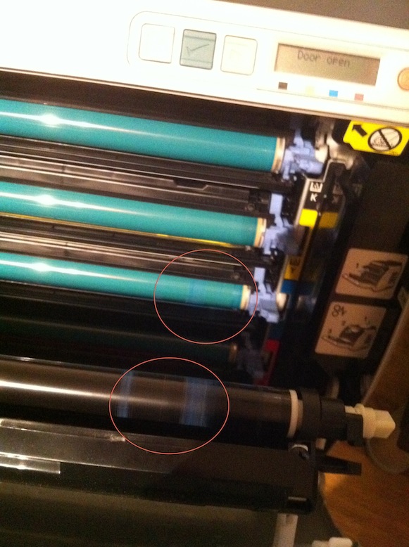

I have a 4-5 year old HP Color LaserJet 2600N that has been serving me well. Recently, it suddenly began producing prints with 2 vertical blue streaks, along the plane of the paper - one on left, one on right side of the paper.
I tried to print a blank page of document, and it still produces the same blue streaks. What does this mean? Is my fuser at fault?
Any advice is greatly appreciated. Thanks!
The brush / scraper thingie that cleans the photoconductor drum is not adequately cleaning that portion. Like a windshield wiper blade with a little dimple taken out of it leaves a fine line of rain across its sweep pattern. Some (Lexmark) laser printers demand a photoconductor replacement every 2-3 toner cartridges. You'll have to check with HP to see what to do with your particular printer.
I think i found the culprit. it's the cyan cartridge.
When I removed the cyan cartridge, the "bottom oval" is clean. How do i clean the "top oval". And by the way, can someone teach me the technical terms of "bottom" and "top" oval?
