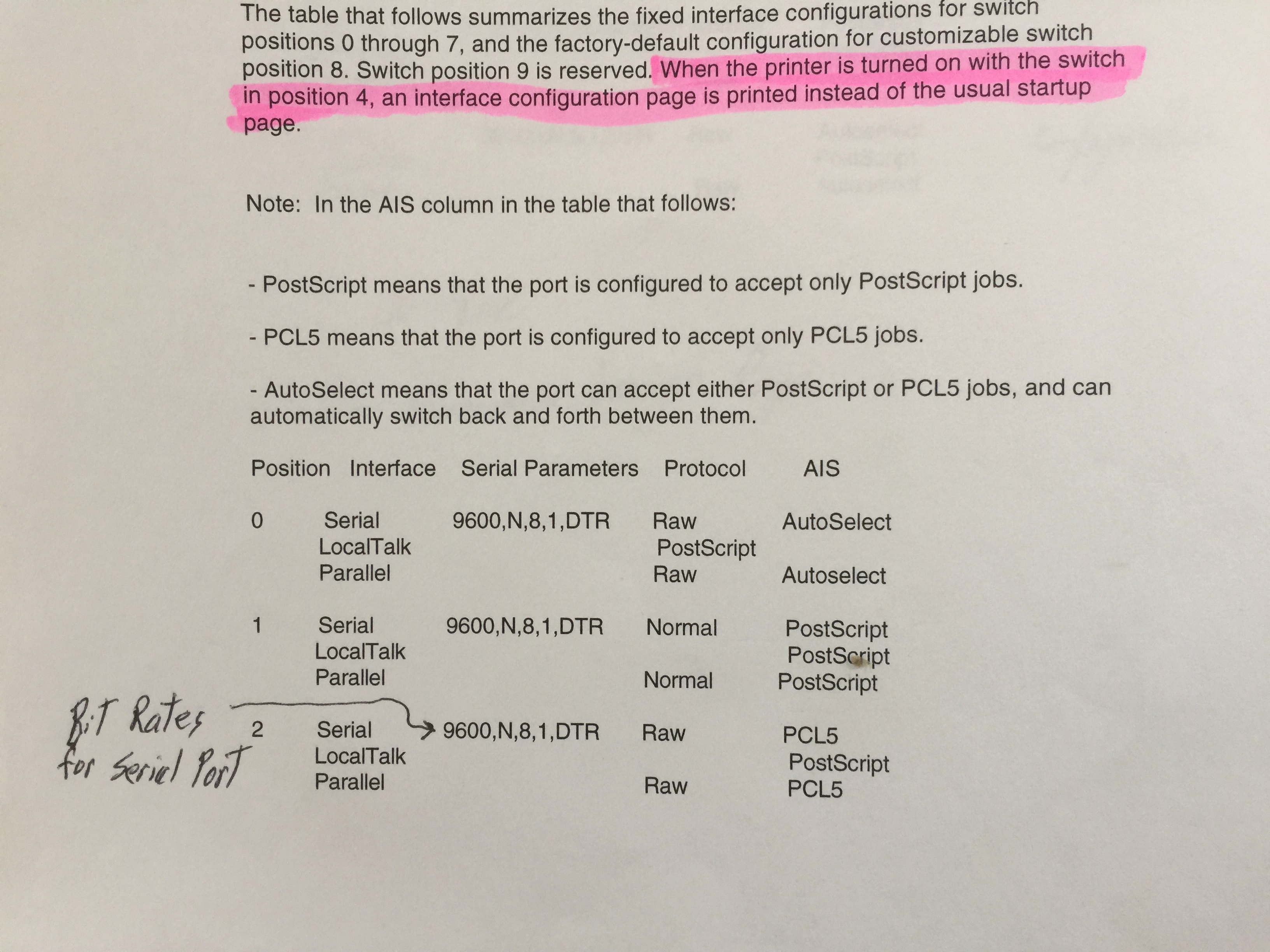

2. Plugged in a 10 foot USB to Parallel printer cable by StarTech, and set the rotary dial on the back of the 360 printer to “1” in order to set all connectors to Post Script.

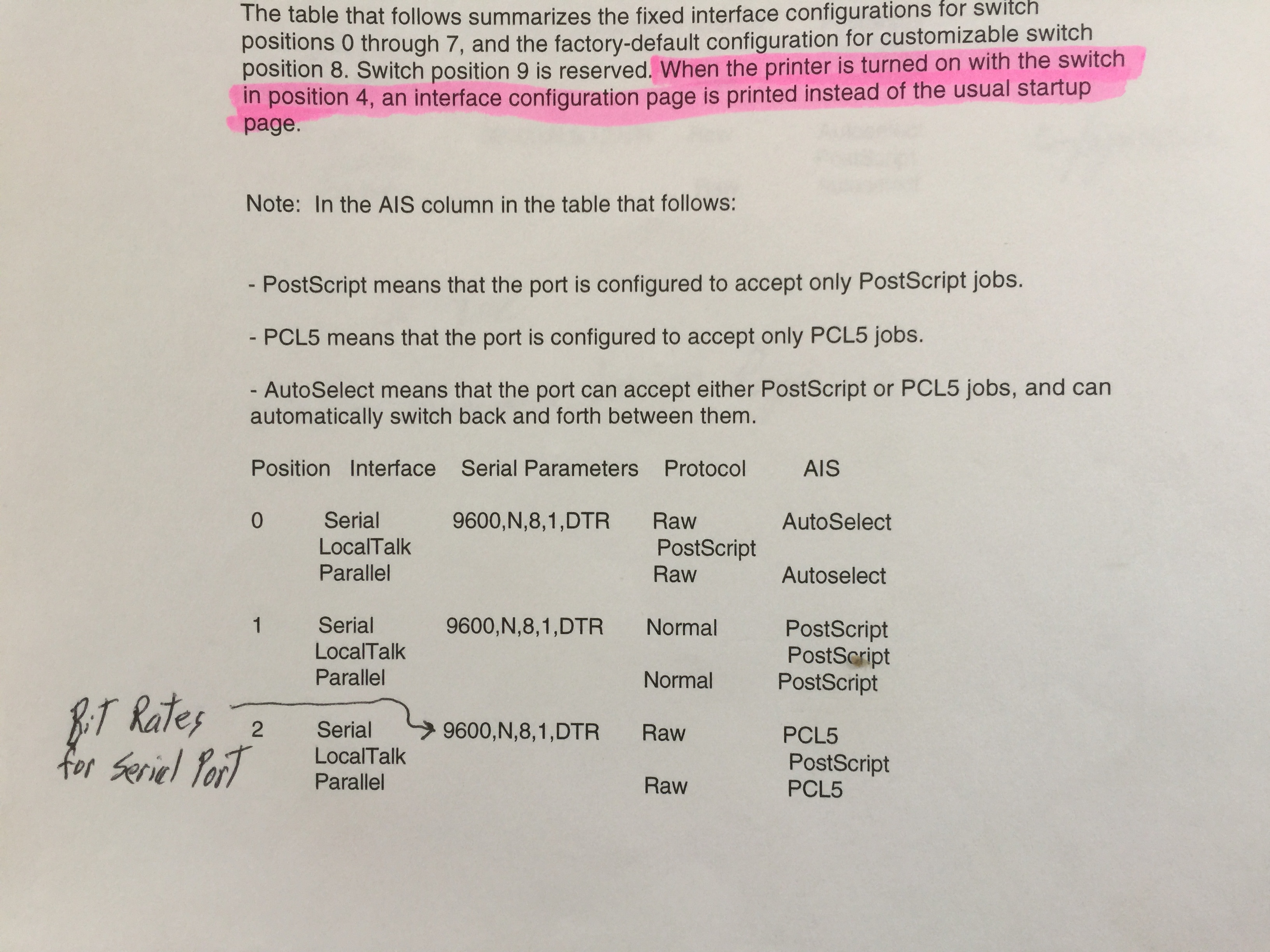

[doublepost=1528295694][/doublepost]Thanks. If you want access to the printer with "Apple Printer Utility-PPC", I believe I read somewhere that you must use an older computer. I know nothing about MacOS X prior to High Sierra. The picture is from the 360 manual. There are old discussions at "Tid-Bits" and the Apple Community I found using Google. Perhaps the print server I bought would have worked if I had listened to my son and dropped the Postscript Printer Description file from MacOS 9 into the iMac sooner. I did download a PPD file off the internet, but it did not work.
