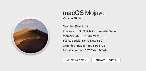

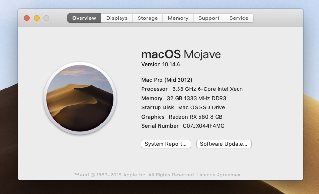

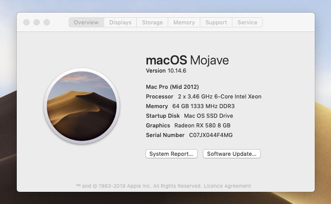

At last......thanks everyone for all your input. Sorry if I pissed a few of you off but roughnecks don't make good IT guys.......I guess
