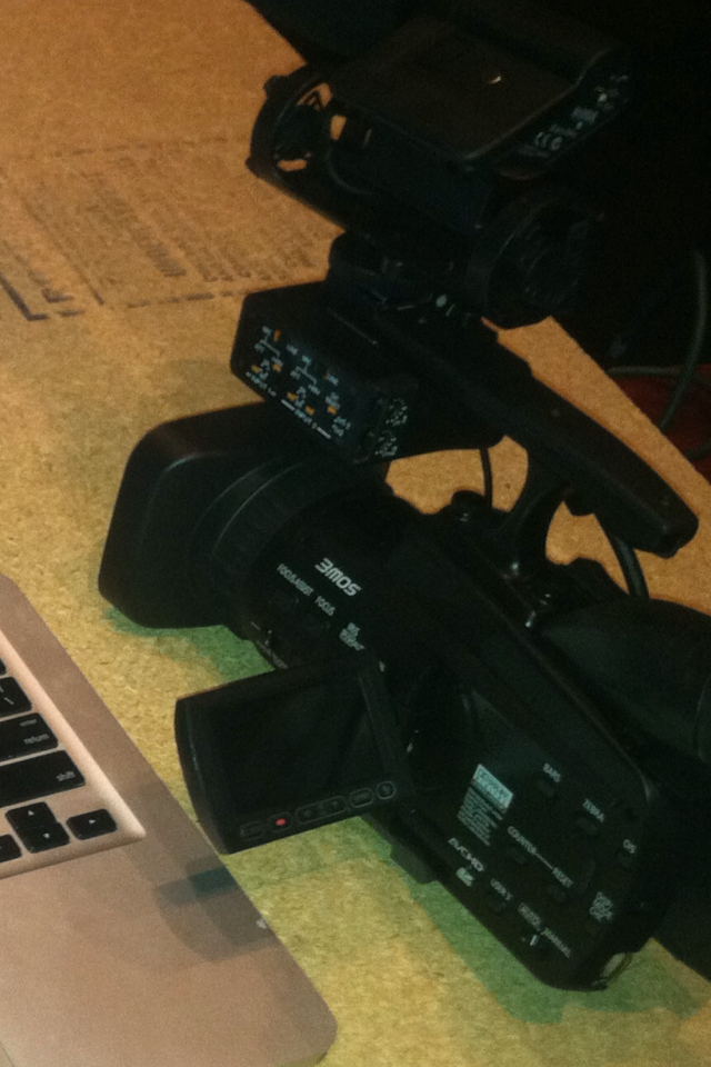

So I am shooting a Christmas pagent tomorrow for my church. I will be using an HDV type camera as well as my Canon 550D. It's for my church but my church is very large and the intended target will be DVDs for distribution at a low cost. The lady I'm working with is (thank God) a news cast major so she will be running the sound board with a total of 10mics. She wants the whole thing shot wide angle and some close shots. I was thinking getting in close with my DSLR and attempting to get some tack sharp video 1920p30 since downressing that always looks gorgeous but I only have an 18-55mm f3.5 lens so that's assuming light is decent but it'll be at 4:00pm...don't tell me to find a lens with a faster f stop because I'm about to hurt someone over the issue with that as it is I just need advice as to what I can do with what I have.
For post edit I'll be using my MacBook pro core 2 duo, 6 gigs of ram, RAID, FCP x (and FCP 7 since the lady prefers that platform), and of course compressor. Biggest concern I have is audio. Definitely want it to sound sharp and clear and it needs to be Dolby Digital with discrete channels that will fit on a DVD.

Okay thanks thanks! I didn't even think of the exposure stuff, I'm assuming the HDV cam will be shooting 60i so for my DSLR I'll shoot 30p to keep things consistent...though 24p would give a very "film like" appearance, the lady that works at my church is an experienced news castor and she said the cameras are really nothing special and I am most likely not going to shoot 60i then try and go to 24p :O.
As for dumbing down the DSLR and depth of field, yeah that's the plan for sure. I'm gonna throw it on a tripod and leave it out and maybe change angles a few times? Idk I'll see but either way I'm gonna have to use a deep depth of view if the people are moving forward and back more so than side to side to avoid out of focus video which is just crap. For video monitoring I think I may have an external 10" composite monitor but I'll see...I have used it before and God did it make a difference with the depth of view stuff.
As for the HDV cam. I have used one maybe once but I'm a fast learner and know all about the tech so I'll play with it a bit. Definitely want to find some ISO settings on all the cams involved and keep that a constant though.

Yeah I'm pretty sure its progressive scan now that I think about it...here's the settings from Media Info:

First time I've done multi cam editing and FCP X sucks with that so this will be a challenge...ANY input would be nice! Thanks everyone.
