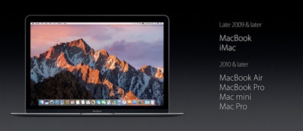

I have a Late 09' Aluminum Mac that needs a new HD and was wondering if this MacOS Sierra would work well on this device? I ask because I don't see how I could install El Capitan on it and would have to do the current Mac OS.
Would it 1) be compatible and 2) would it function properly or would it be extremely slow?
That is what it is labeled as if I recall correctly because the 09' also had the white laptops? something like that.
Well, though the process of deduction if it truly is a Late 2009 model and aluminum, it must be an iMac. The only Late 2009 model compatible with Sierra is the iMac, as the Late 2009 MacBook is a white polycarbonate model.
So yes it should work, and it'll run about like a 8 year old Mac can, though if you put in an SSD instead of a hard drive it will be vastly quicker.
Also, just to make sure it isn't a "Mid 2009" model like the MacBook Pro
You know what, you are right so this might be a late 08' unibody MacBook then.
