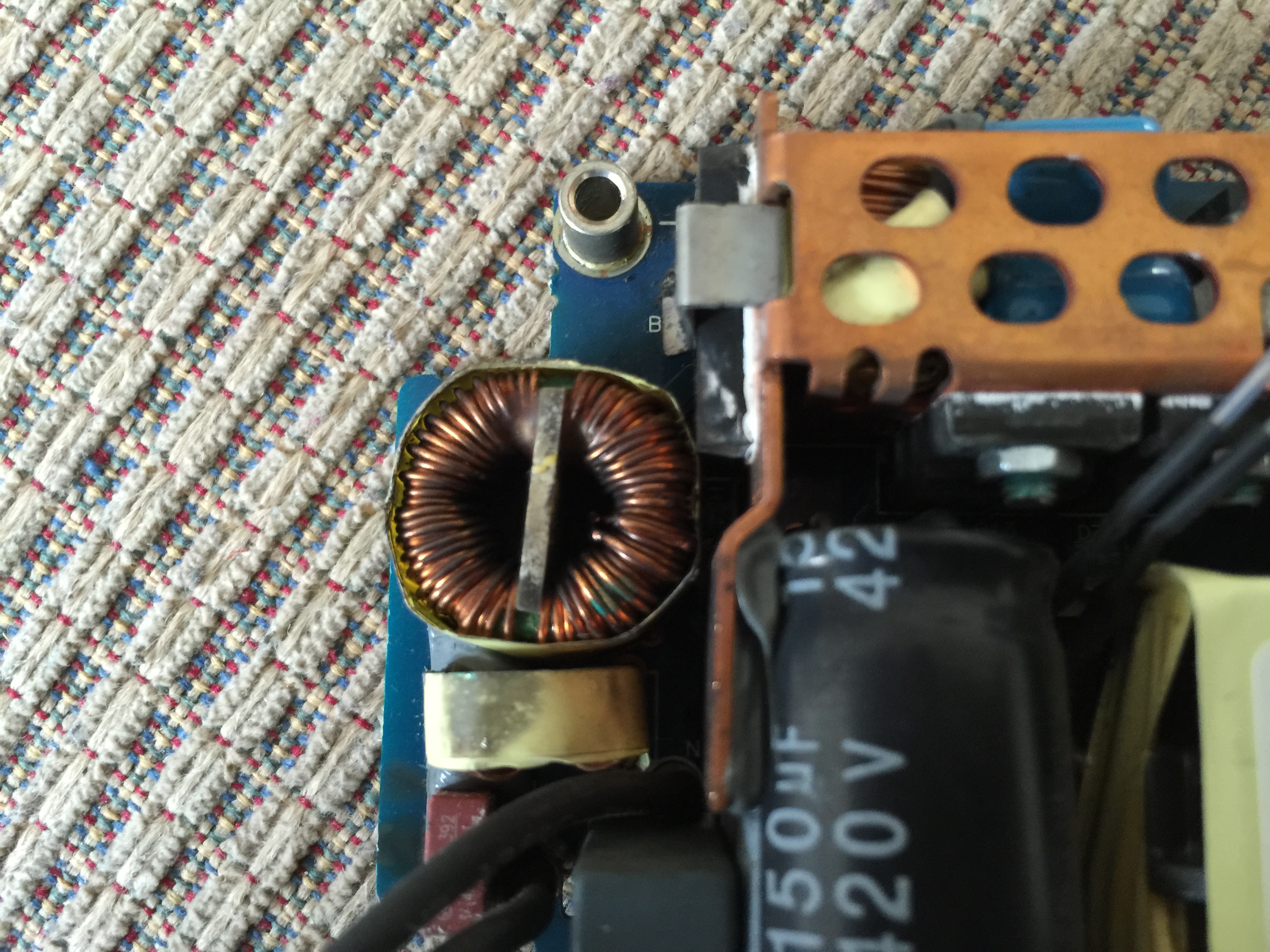

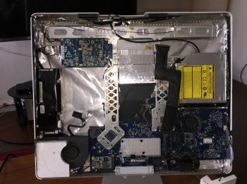

So basically Im trying to save this 2.16Ghz Intel Core 2 Duo G5 A1207 iMac I found for sale for £10. ($15USD)

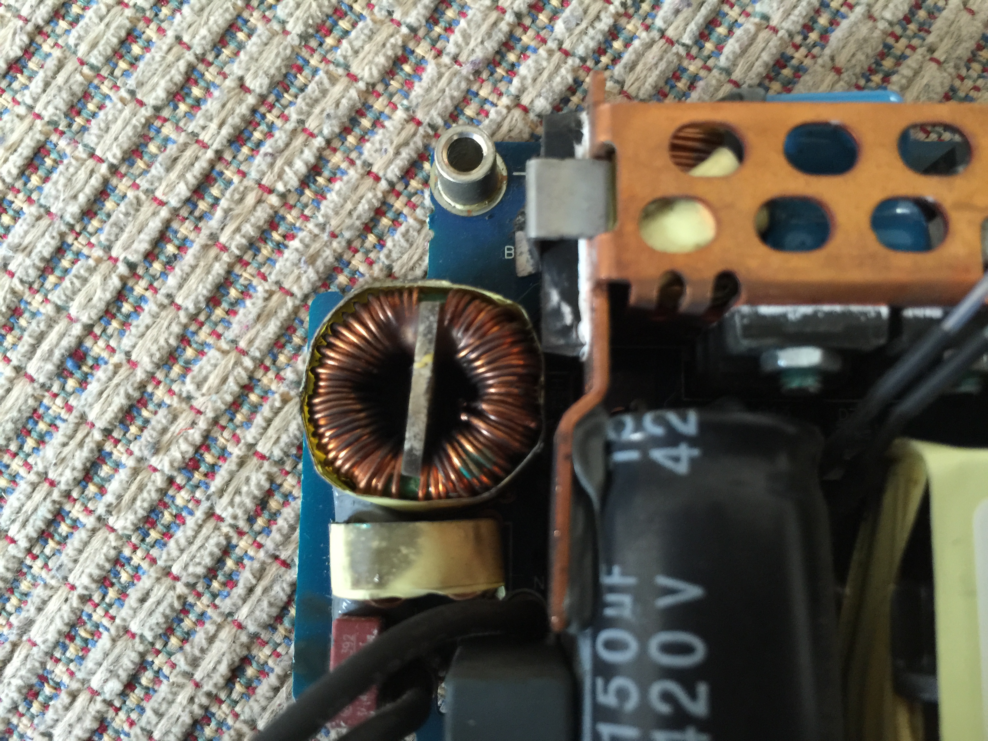

it had no internal HDD (presumably removed for security reasons) and the PSU was blown.
Replaced the PSU for a cheap used unit and now the machine turns on at least

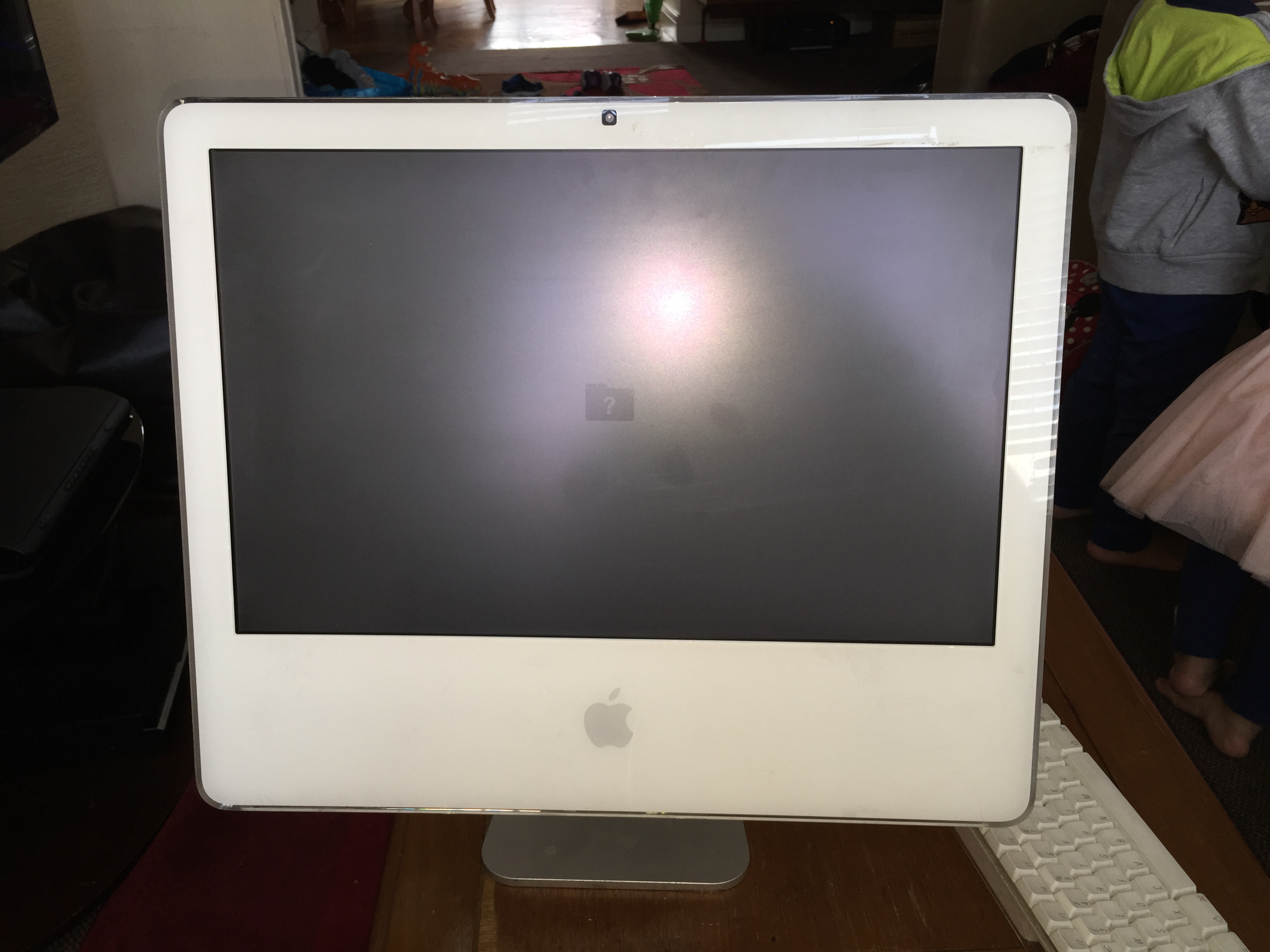

I *was* looking to replace the internal HDD, but on inspection the SATA data connector on the logic board has been damaged by some heavy handed oaf. (one of the pins snapped off)
I have a usb 240GB SSD drive that i would like to run the machine on. is this possible?
Can someone point me to a tutorial of how i go about getting OS X onto the external HDD and booting from it. Is this even possible with No internal HDD?

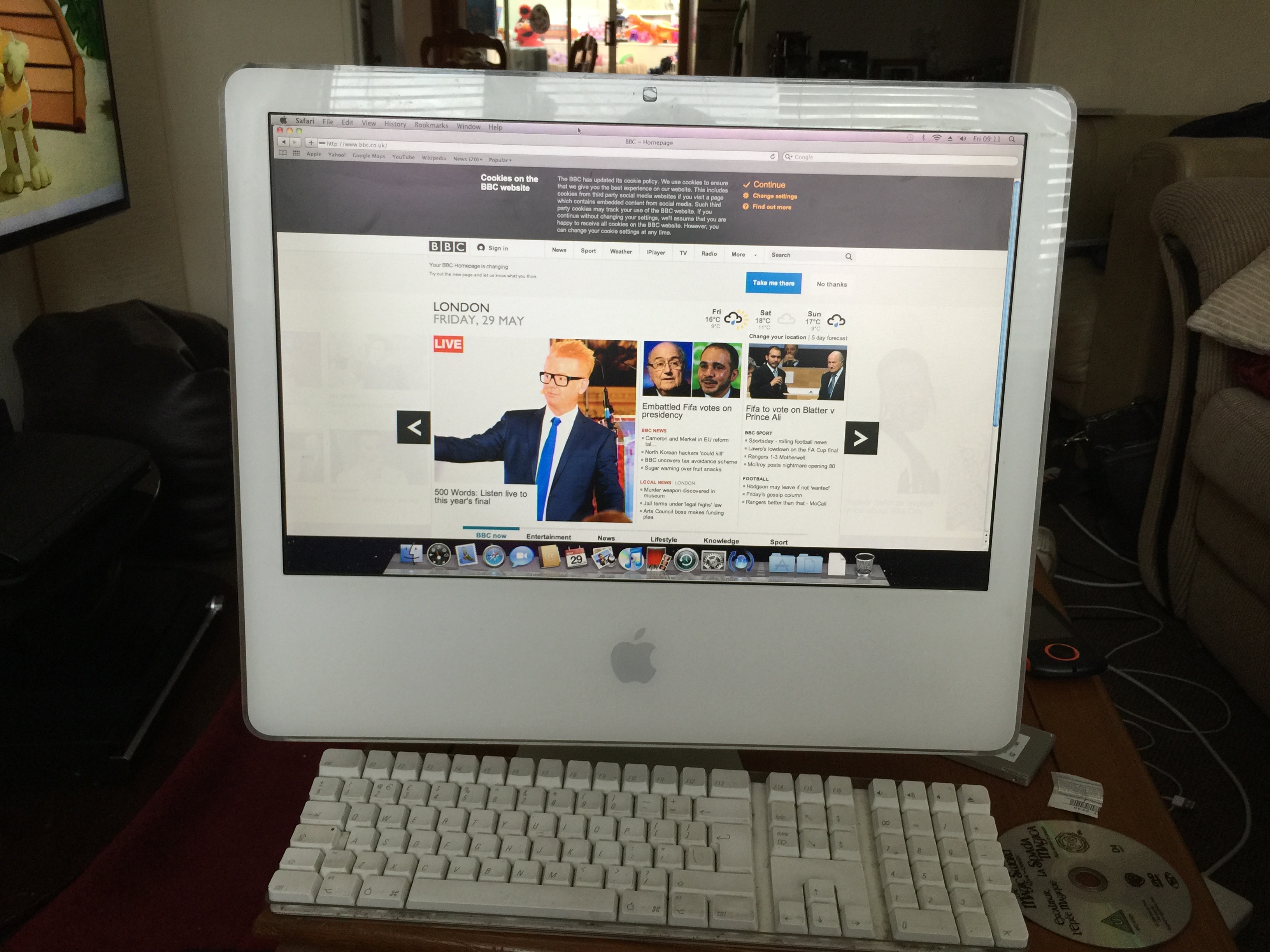

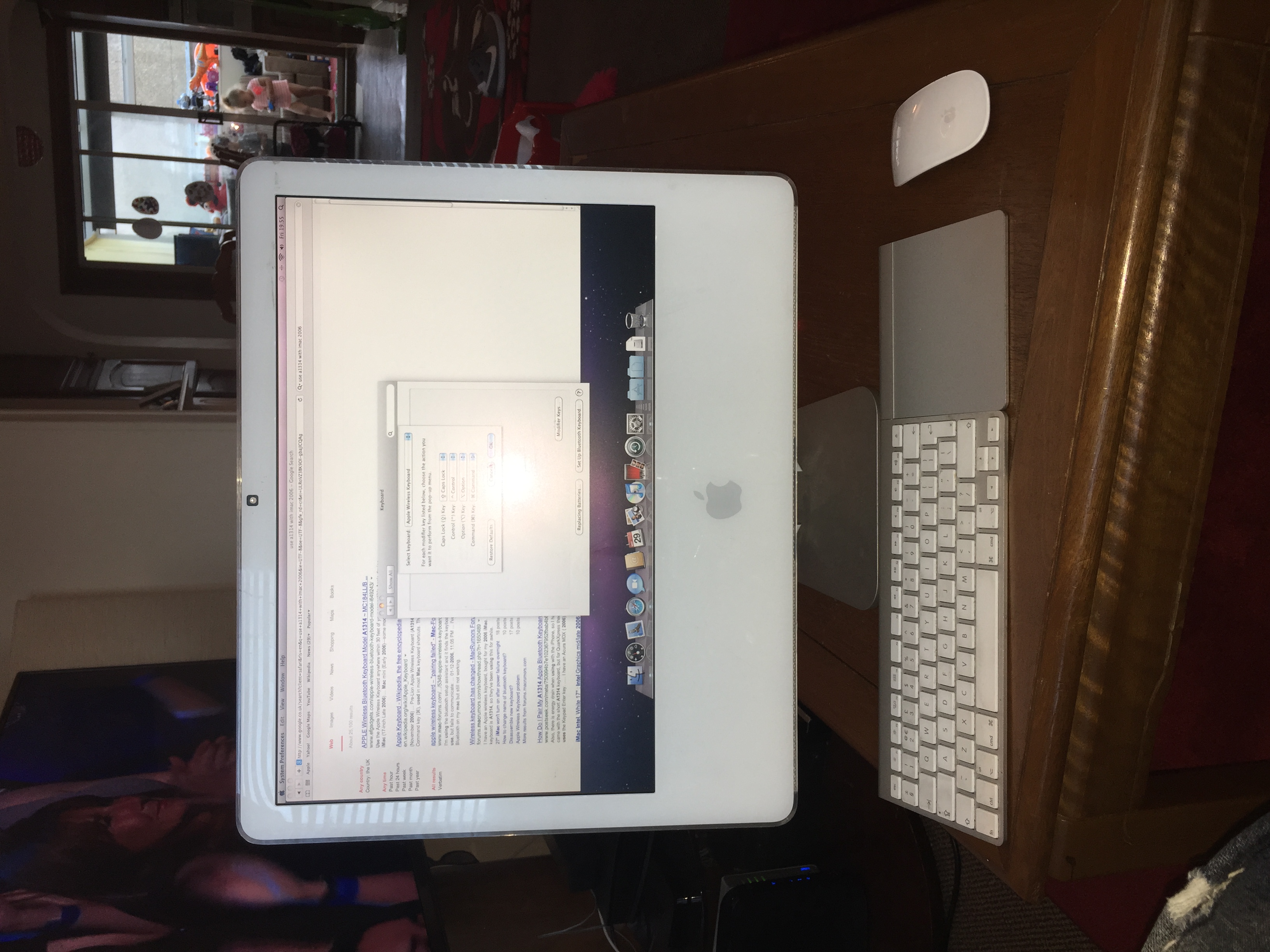

Hi all,

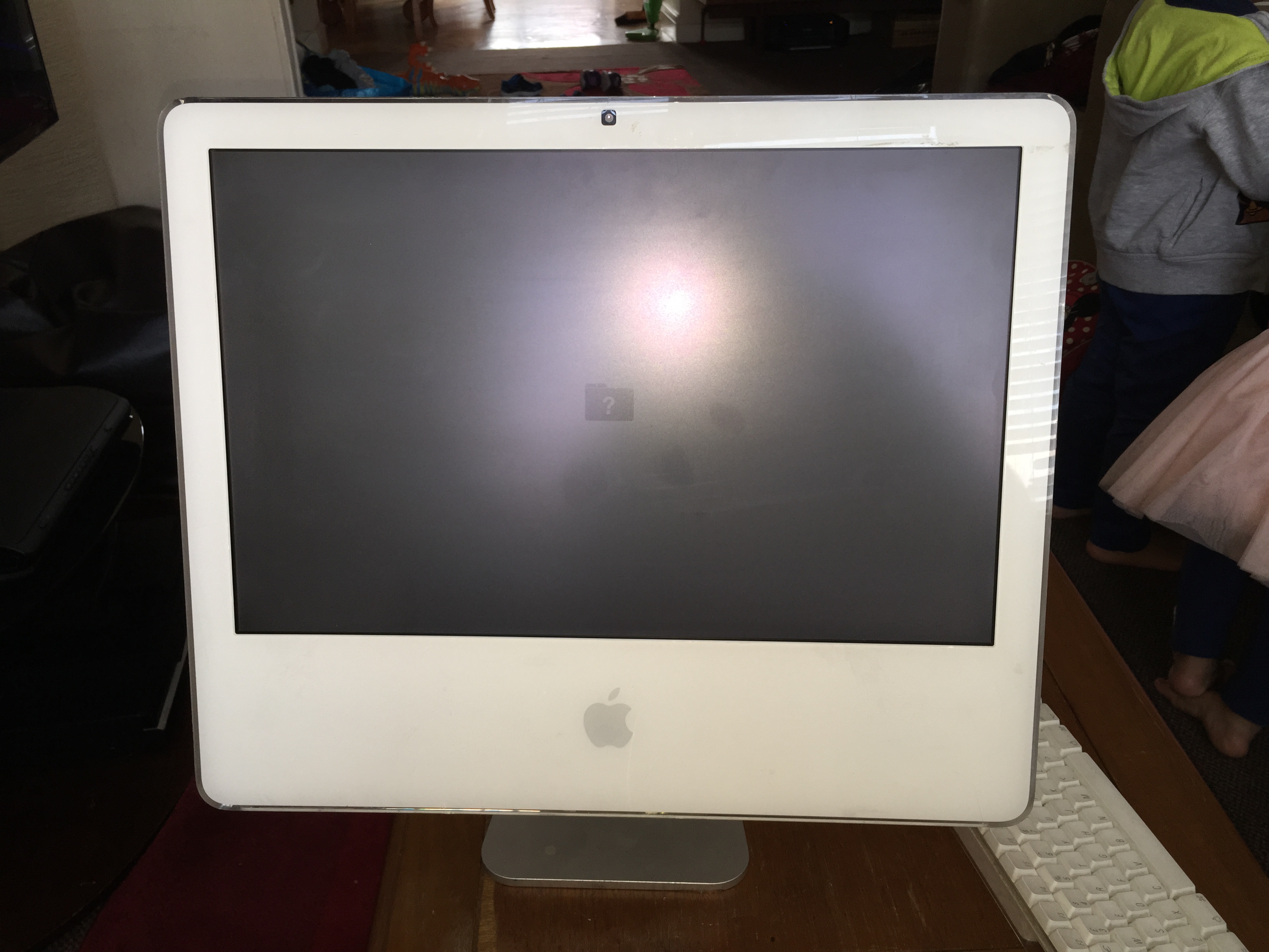

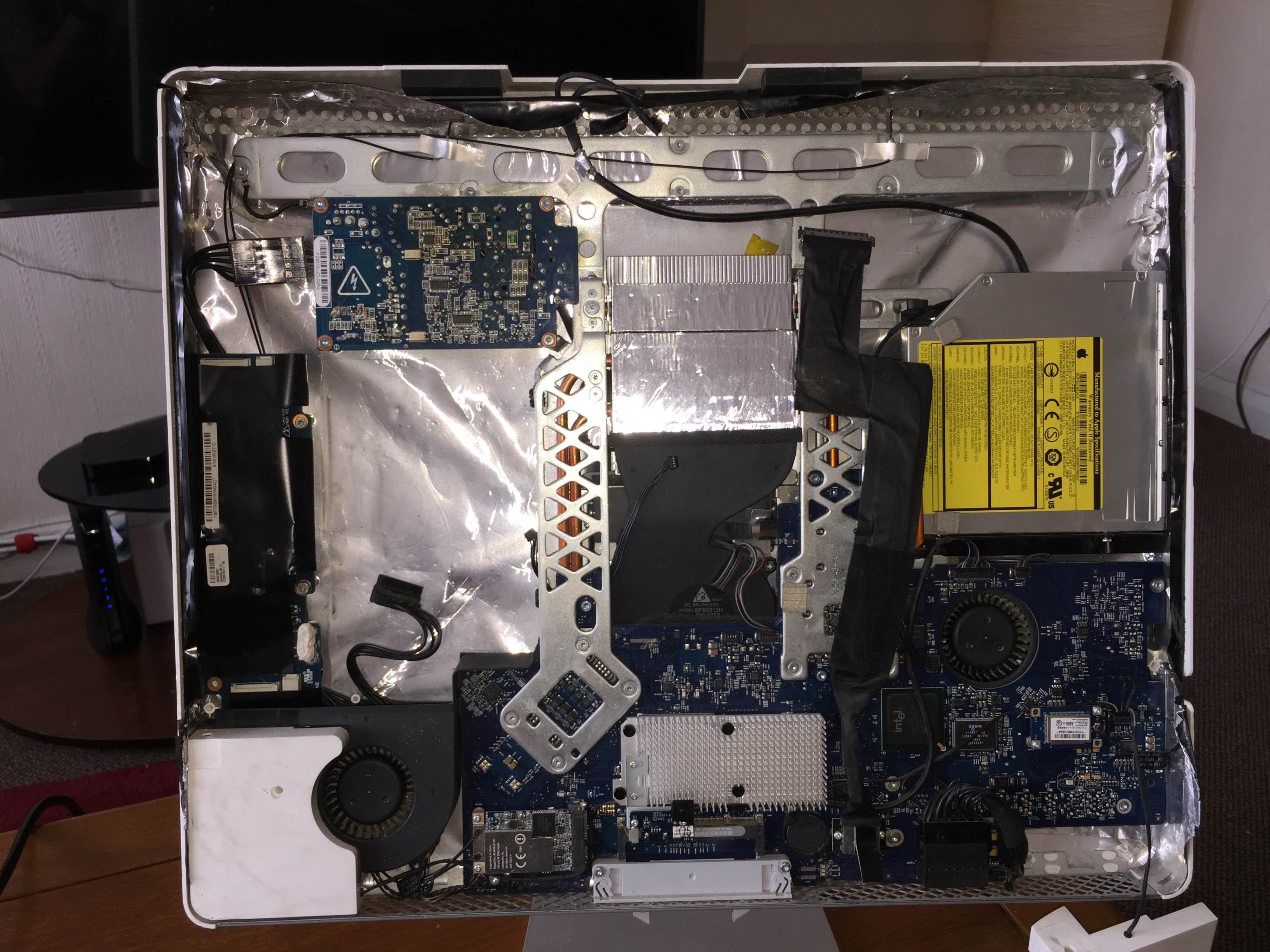

Pretty pleased with myself. Got everything fixed and working as planned!

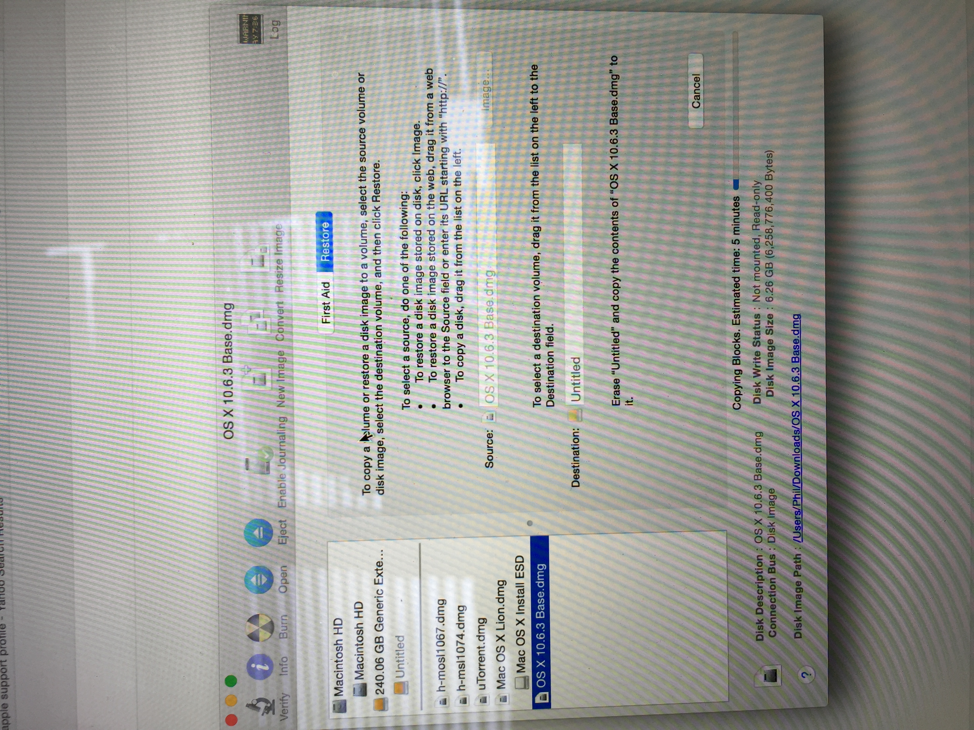

Replaced the psu for one i grabbed on ebay for £21.

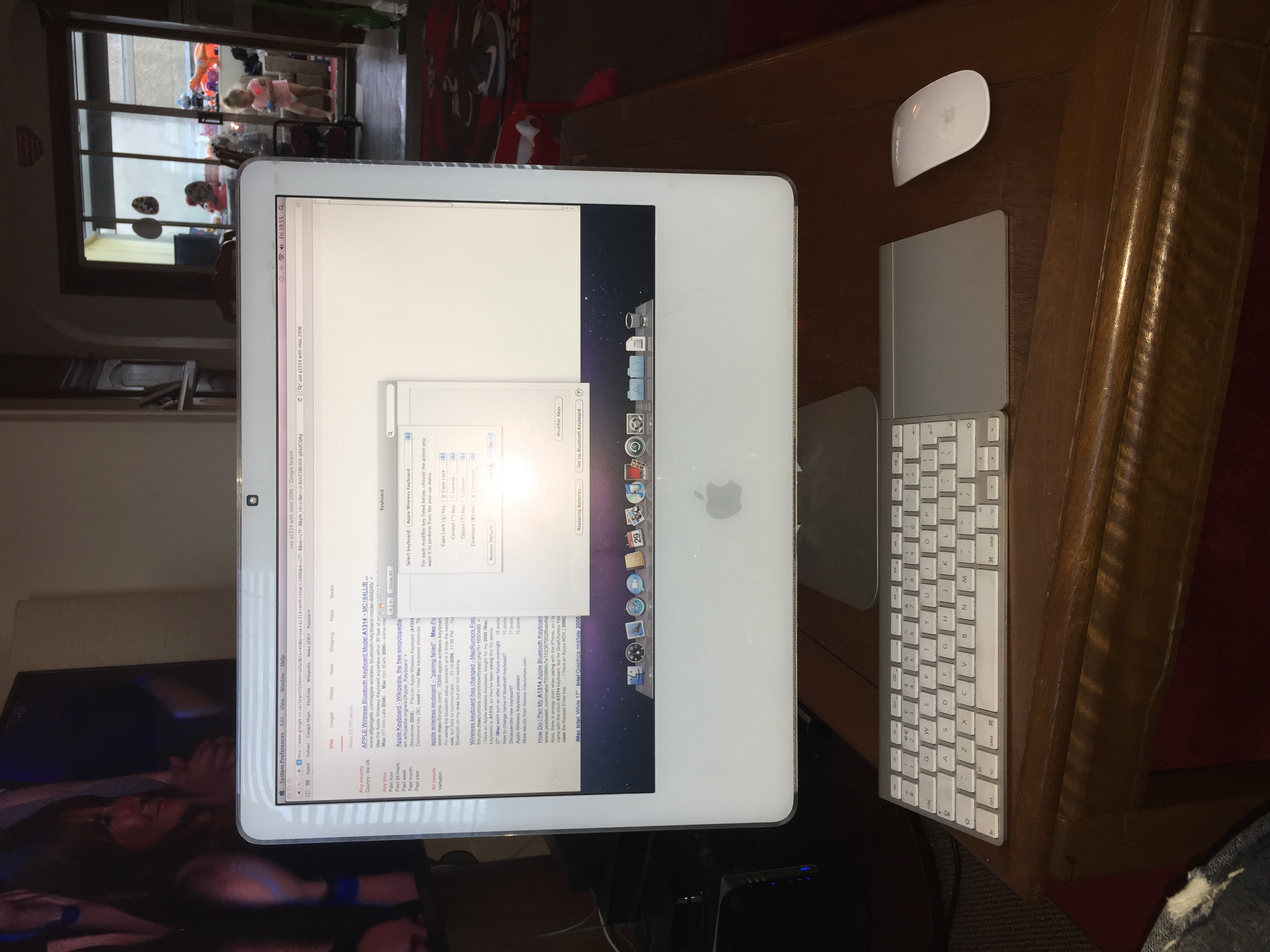

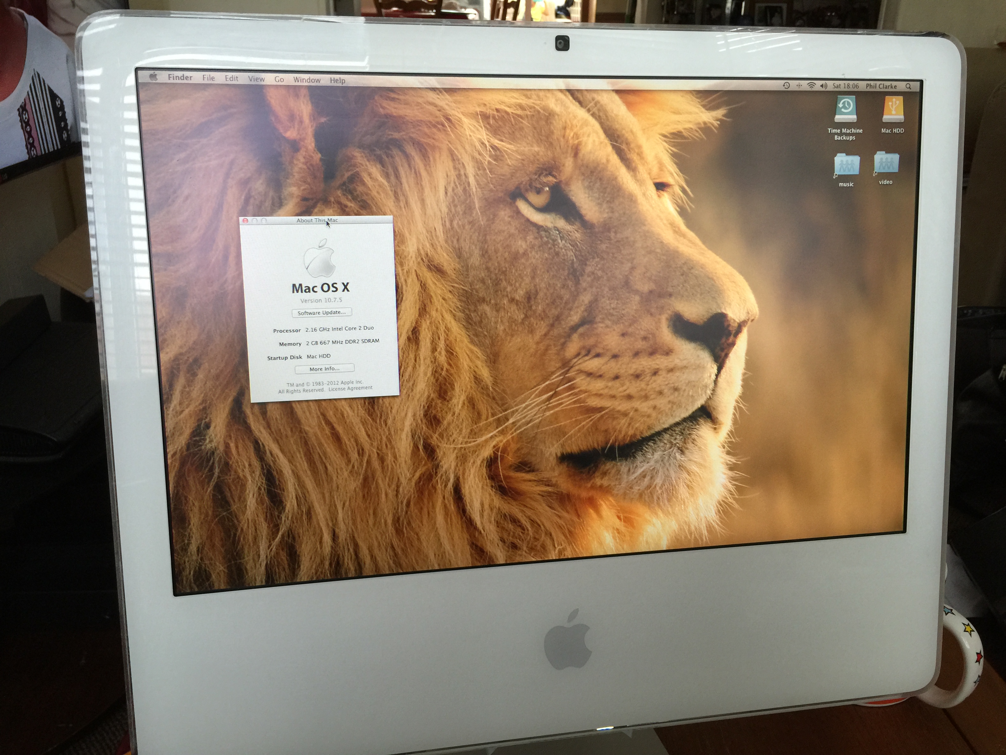

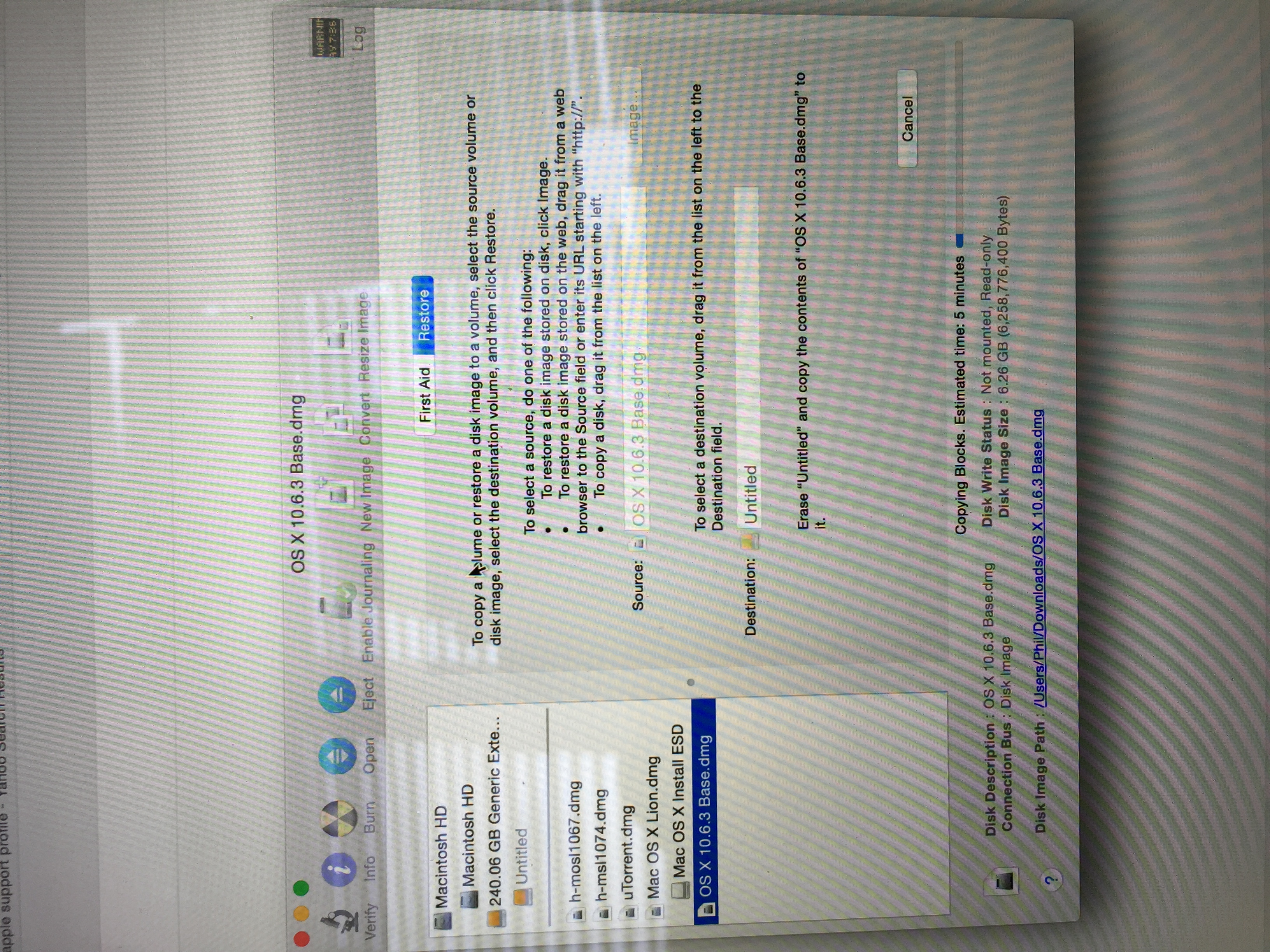

Using the 240Gb SSD i had lying around, I made a base bootable image of snow leopard 10.6.3. Booted straight from usb no hassle.

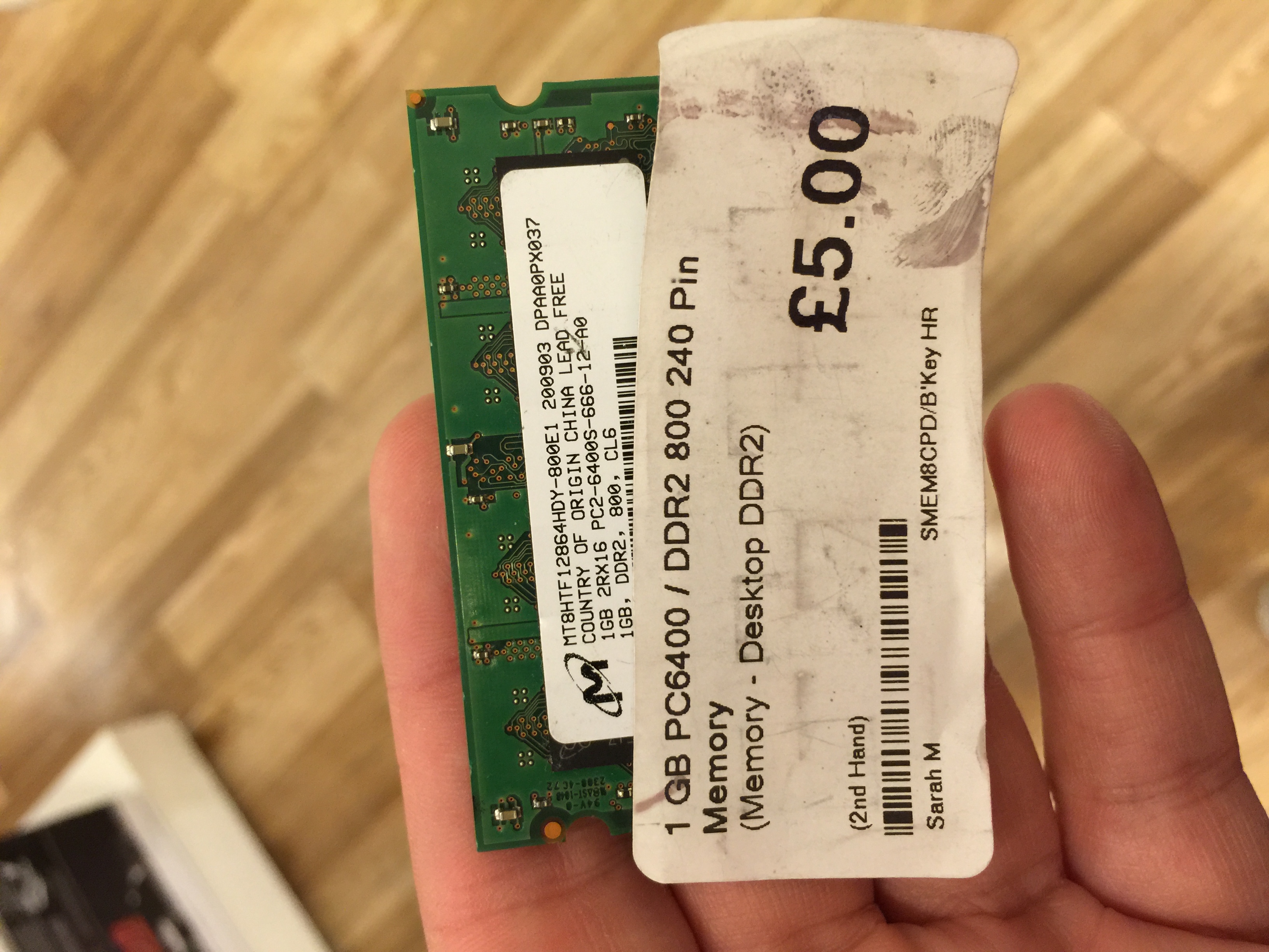

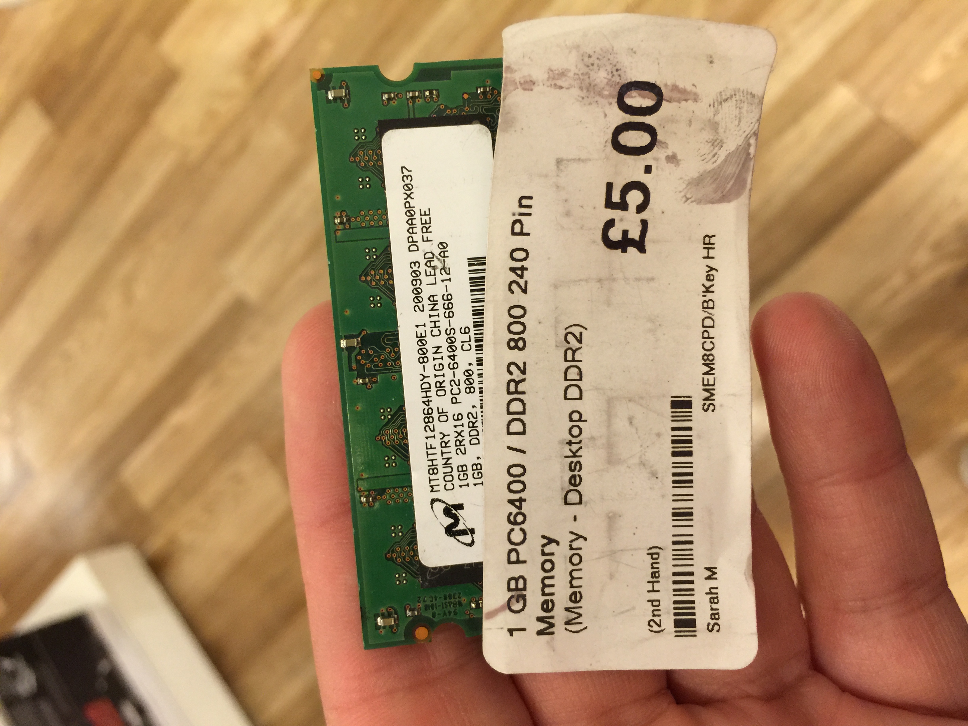

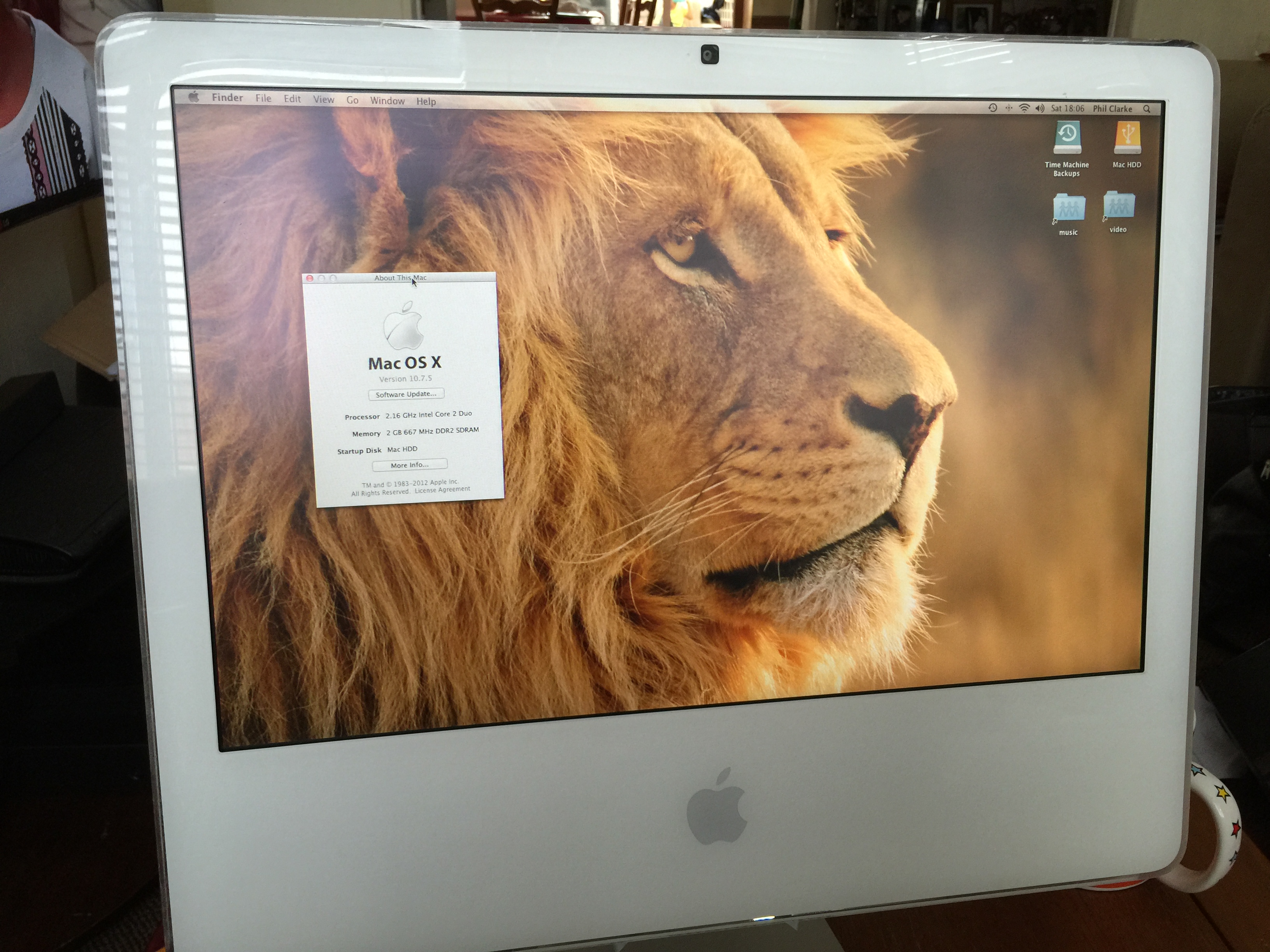

Then updated to 10.6.8, found some RAM in a local second hand store for £5 to upgrade to 2gb then upgraded from the app store to Lion which i had purchased previously for my old MBP.
Now running 10.7.5 Lion (the most up to date OS X this will run)
Oh and I added a wireless magic mouse and aluminum keyboard and trackpad which i had which were not being used.
Just need to find the rest of the missing case screws and a ram cover to complete it.
Running sweet right now! 🙂
Total cost for this iMac was £36, as the SSD and keyboard etc I already had lying around doing nothing.
Pretty pleased with myself and a decent iMac saved from certain death!! 😀
