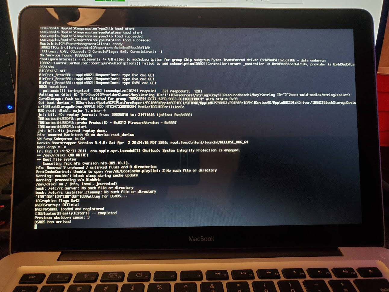

I've purchased a Late 2008 Aluminum MacBook that came with no hard drive. This laptop supports up to Mac OS X El Capitan, so I threw in my 500gb El Capitan hard drive. The progress bar got about to halfway, then froze. I did a pram reset, and now instead of freezing, the display would turn off. I tried many different USB Mac OS installers and the only version of Mac OS I've gotten to boot sucessfully is Mac OS Lion. However, when I go to install it, it says that it could not install additional components. I'm not sure why its doing this, or how to fix it. Any help would be appreciated.
Boot in verbose mode (hold cmd-v after turning on) to see what's happening when it turns off.

So, trying to boot into safe mode, it hasn't black screened, but its been hanging on the boot progress part about 2/3 through for 30 mins now.
