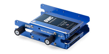

When I had 2 SSDs installed in the 2nd Optical Bay, I used the following:
http://eshop.macsales.com/item/Other World Computing/MM352A52MP/

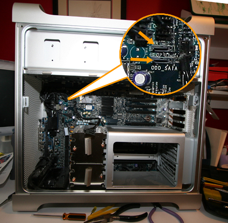

Do you want to boot off the new SSD? If so, you will have an issue using the extra sata port on the motherboard because you cannot boot off of it. At least on mine you could not and I have a 2008 MP.

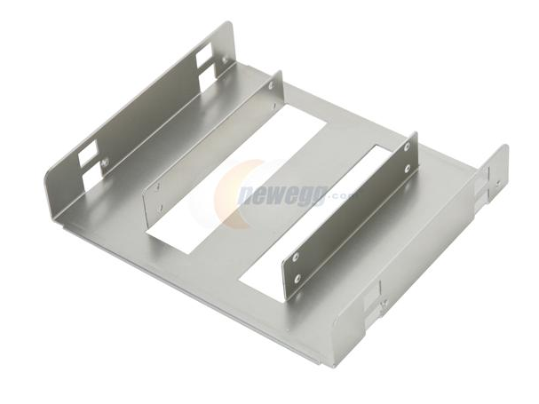

Installing in the optical drive takes more work because you need to run a SATA cable from the optical drive to the ODD SATA ports on the motherboard. The parts you need are as follows:

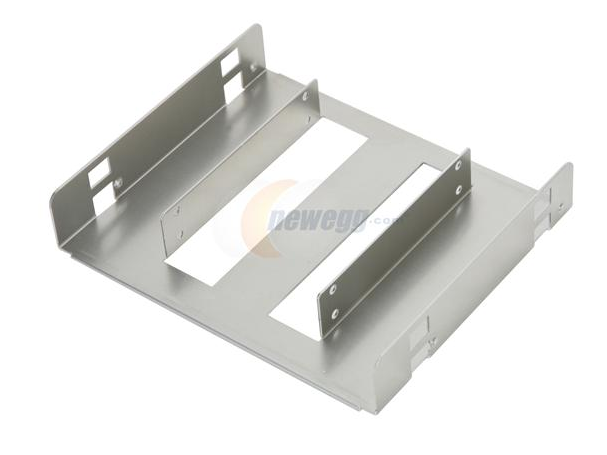

1. 2.5" to 5.25" adapter (to house the SSD in Optical Bay #2)

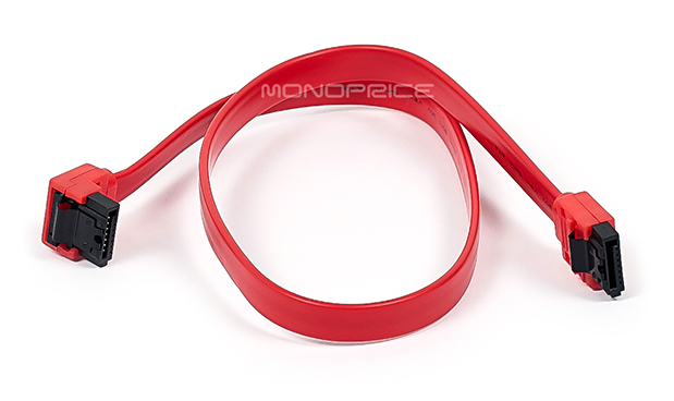

3. You need a SATA cable (18" to 24" with right-angle preferably)

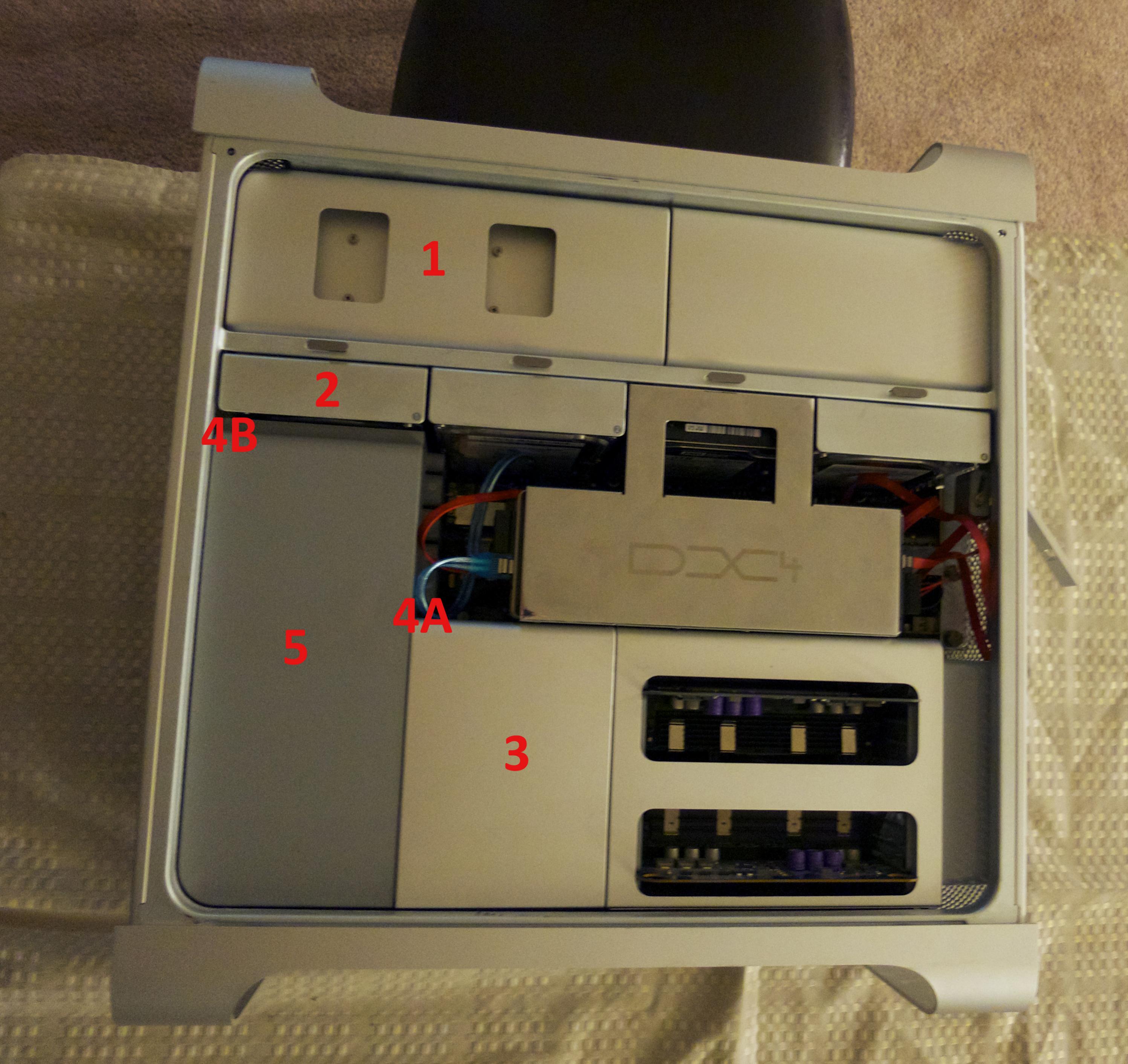

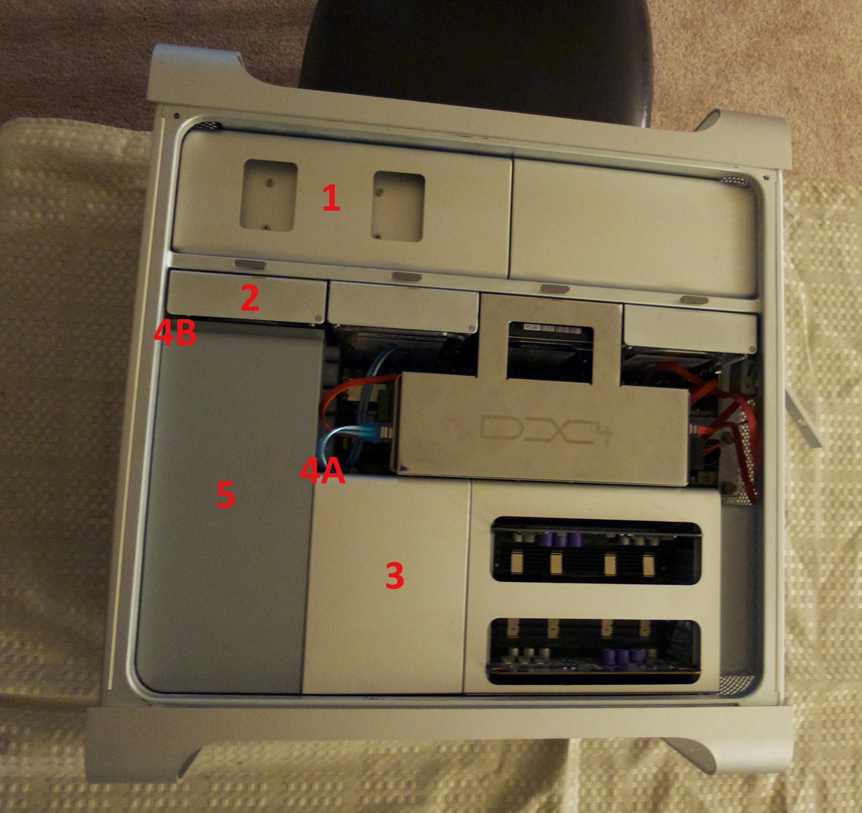

How to Install SSD in Optical Drive
Step #1: Remove Optical Drive, Install 2.5" to 5.25" adapter bracket with SSD, connect SATA power to molex adapter.
Step #2: Remove the HDD from Bay #1
Step #3: Remove Piece Label #3 (see below, I think it's the heat sink cover?)
Step #4A: Remove screw #1 that attaches front fan to motherboard
Step #4B: Remove screw #2 that attaches front fan to motherboard
Step #5: Remove front fan from mother board
FYI: For the next step, you may need to unscrew the Bay #1 SATA connector.
Step #6: Run the SATA cable from your SSD in the optical bay, through the opening available under to the left of HDD Bay one and connect the right-angle part of the SATA cable to either ODD_SATA port.
Step #7: Reassemble everything.
Please Note: You cannot boot windows from the ODD SATA port without enabling AHCI which is a complete pain in the ass.

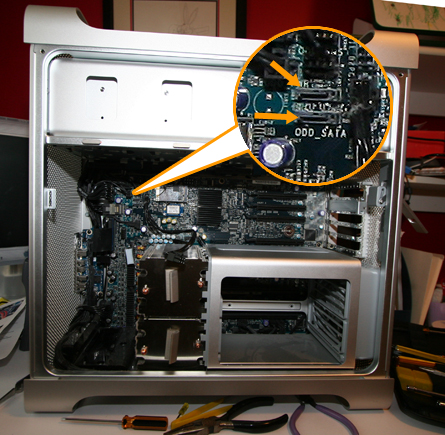

I don't think you can boot the Mac off those two Sata ports either.
**Update** I stand corrected it looks like you can boot off these ports!!!
Unless I am mistaken, you should be able to boot off of both HDDs and ODDs over those ports on the Mac OS X side of things. If you're trying to do anything Windows-related on those ports, however, that's when there's some hackery necessary.
My early 2008 Mac Pro has two Samsung 830 SSD's in RAID 0 as a boot drive and both are connected to the two ODD_SATA ports. I can confirm that you can boot Mac OS X off of the ODD_SATA ports. Windows takes AHCI hacking (don't attempt unless glutton for punishment).

I can also confirm booting OS X off of the motherboard SATA ports on a 2008 Mac Pro 3,1 computer.
I have a pair of OWC 240GB SSD drives mounted in the optical bay running in RAID-0 with my OS X boot, applications, and user data. I ran the 2 SATA data cables from the motherboard SATA ports (under the fan housing) up into the back of the optical bay. Power is obtained from the second optical molex power port with a molex-to-SATA power Y-adapter cable. I use the OWC dual SSD mounting rails in the space where the 2nd optical could be mounted.
Bay #1 contains a OWC 120GB SSD to dual boot Windows in a IcyDock mounting adapter.

Could you see the SSD in Mac OS X when connected to the ODD_SATA port but just not boot from it after installing Mac OS X?
Just to add, I have two OCZ Vertex drives in the optical bay using OWC hardware and connected to the motherboard connectors. Both are bootable with OS X. I don't do no stinkin window crap 🙂 At one time I had an external drive connected (short cable) and was able to boot from it.
Yes, only after I was able to boot up with another drive. I had the OS on the ssd drive, because it would boot off the ssd if I had it in the drive bay, but it wouldn't if I had it connected to one of the ports on the MB.
Hmm. Oh well, I have everything working now, but now I want to go back and see if I did anything wrong.

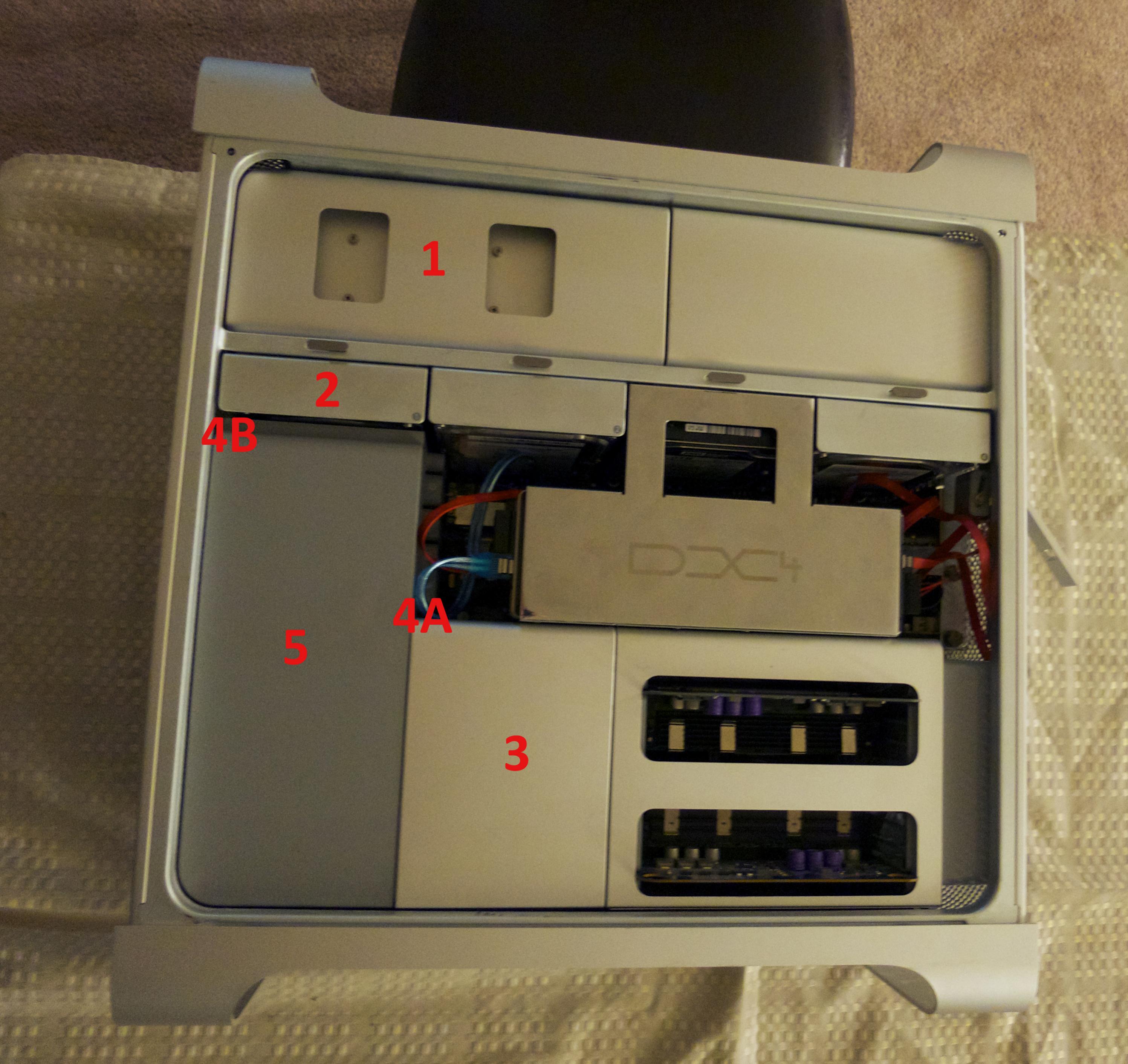

what is the thing labeled as DX4 in your MP? Haven't seen anything like that before, and it looks like it was designed for a mac pro given its position in the 3 sled.. I'm guessing its a raid controller

what is the thing labeled as DX4 in your MP? Haven't seen anything like that before, and it looks like it was designed for a mac pro given its position in the 3 sled.. I'm guessing its a raid controller.
It is a transintl dx4 which holds 4 2.5" hard drives. I have two ssd drives running off my odd_sata and 2 1TB 2.5" hdd running of a PCIe card.
