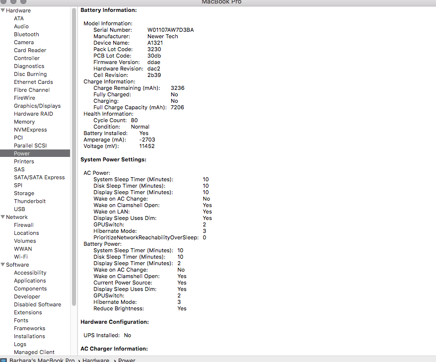

Hi. I replaced my original Macbook (15 in., mid 2010) battery in June 2018 with a Newer Tech. Also changed to SSD. As you can see from the attached screen shot, the battery supposedly is running normally, but not it's not really as it is draining super, super fast. If I get two hours out of it now, it's a miracle. I'm really disgusted and wonder if this Newer Tech battery company is any good. It came from OWC and was installed at an authorized Mac servicer. I don't play games, music, videos, etc. on my computer, just use if for basic stuff and I rarely use Chrome. I realize my laptop is old, but I have no plans to get a new one anytime soon. I love this one. Should I try to find an Apple replacement? Thanks.

Be aware that the web has moved on since 2008. Even with the same battery (just brand new), getting say 5-6 hours of life when new with the 2008 web pages, you'll see that drop with the modern 2020 internet. Because the modern internet web pages have a lot more stuff going on inside them.
I'd strongly suggest getting an ad-blocker which will stop a heap of the background garbage on a modern web page running in the background.
I use 1blocker (from the App Store), it works well. You may also be able to get similar results by turning off javascript, etc. but that's increasingly not-feasible if you actually want to use modern web pages.

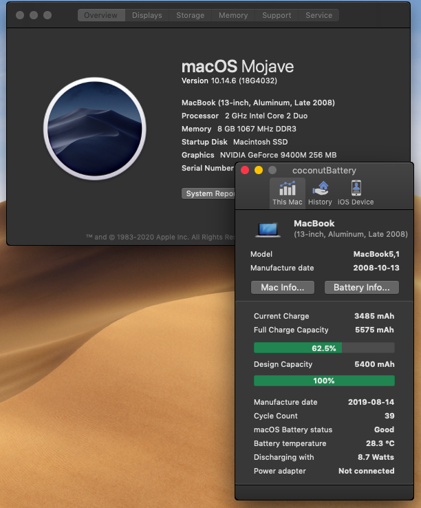

I am happy with the 2-power battery I recently bought for my late 2008 13-inch MacBook but it seems that "user replaceable battery compartment" design is flawed in terms of cooling. My MBP7,1 with a higher CPU clock frequency runs cooler in a clamshell mode with external full HD monitor than my late 2008 MacBook in normal operation. It seems that Apple made a revolutionary leap forward by ditching the "battery compartment" design.
