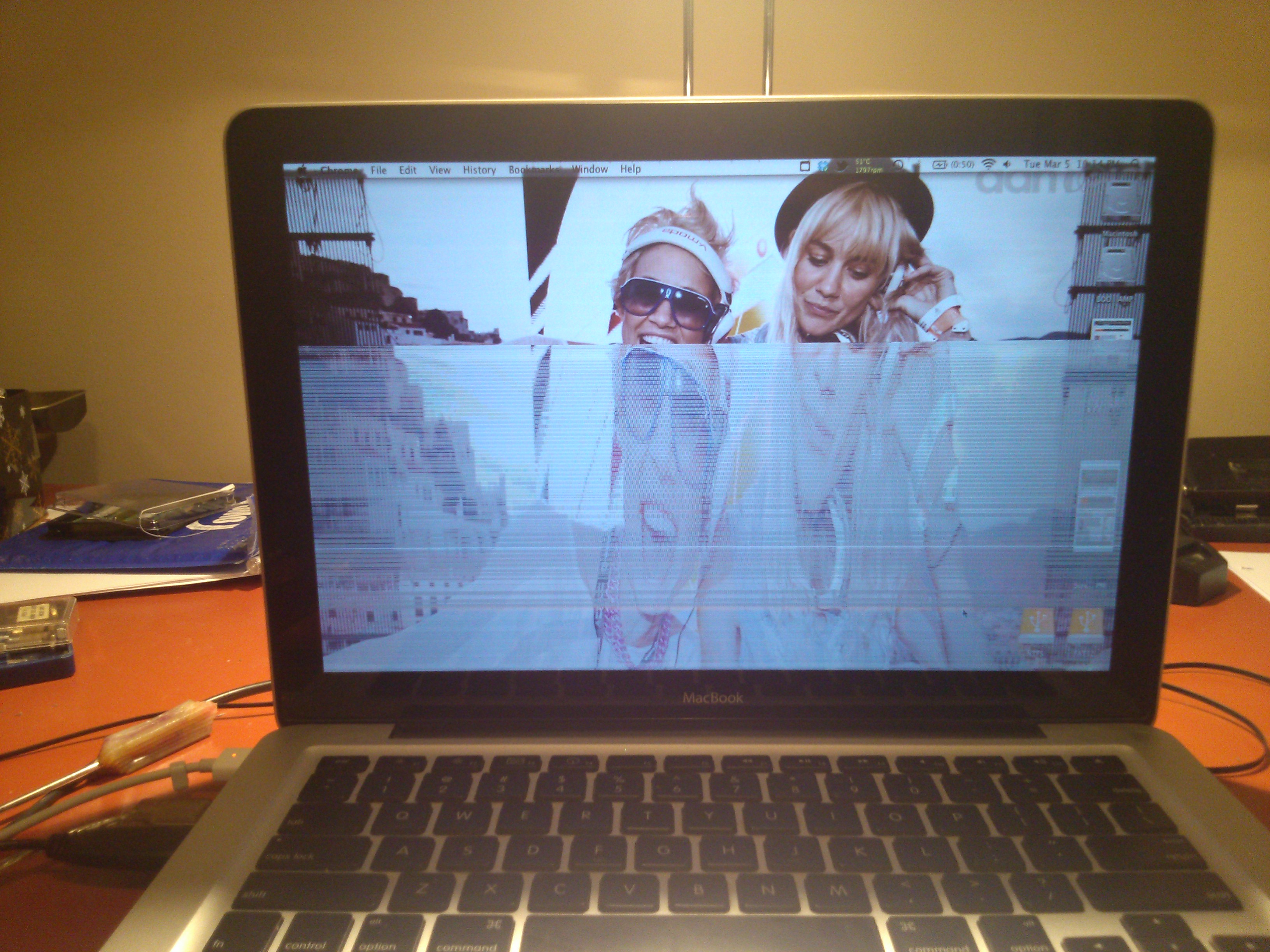

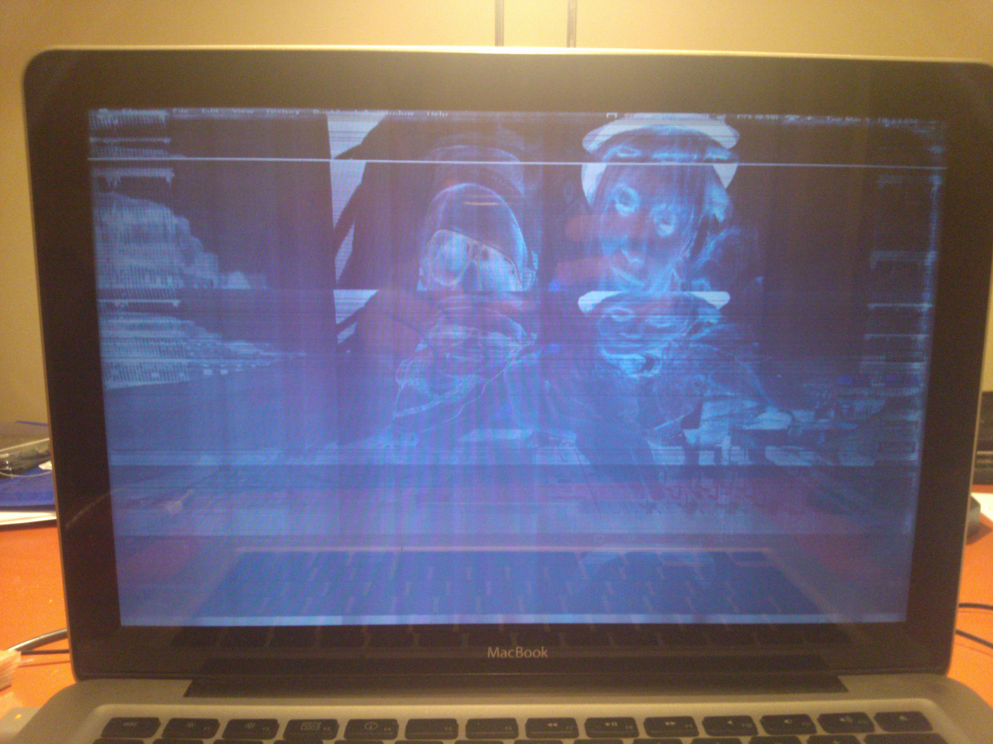

hello there, always checked macrumors's forum whenever I had mac problems but I had searched for this this problem like crazy and could not find a solution.
I have a late 2008 unibody aluminum macbook ( Model ID - 5,1 )
I had my motherboard (logicboard) and hard drive replaced because of a fan malfunction ( fan was also replaced ) in 2009.
I recently replaced the ram from the stock 2gb to OWC 8 GB no problem
The issue that I am having is that my screen has been going bonkers unless i put pressure on the back casing and the front screen (which im doing now)
I took a screenshot capture to see if the crazy screen was also on the computer, as i read other forums and said try this to see if its the screen or the gpu?
I have horizontal lines that disfigure whatever image is on the screen, and sometime my screen slowly turns into black?! I've posted pictures to hopefully give a better description as mine isn't very good.
the first picture is the screenshot of my desktop, the last 3 are pictures off my cell phone of what im viewing.
any ideas?

Your explanation is a bit flaky.😛
From what I understand is that if you take a screenshot that one is OK, but the display is not, another thing, where axactly do you press, on the display is clear but on the casing where, you mean on the casing behind the display?
If the above is true the GPU is OK but the problem is the display, could be as simple as a loose connection.
Sure looks like the problem's in the display and not the GPU, but if you want to verify, you could see if the problem appears with an external monitor.
Assuming it's the display (somewhere above the hinge), what you need is
- some very steady hands and good tools and this guide (http://www.ifixit.com/Guide/Installing+MacBook+Unibody+Model+A1278+LCD+Panel/1428/1?singlePage) as well as some luck (to be able to see the bad/loose connection, or
- a replacement display assembly, which basically means either a load of cash if you take it to apple or that you lie in wait (craigslist etc.) for a busted A1278 (MBAlu) with a working display (these might go for about 100 €/$ and the replacement is quite straightforward).
HTH,
When i put pressure on the screen and the back casing, i essentially pinch them together, and this is usually on the part where the black frame meets the LCD screen. I used a mini display port to hdmi adapter and connected to my TV which worked fine. I assume its entirely something to do with the display?
It's the screen. Buy some tools at an art store to remove the glass, buy a screen for $60 and get to work! 🙂

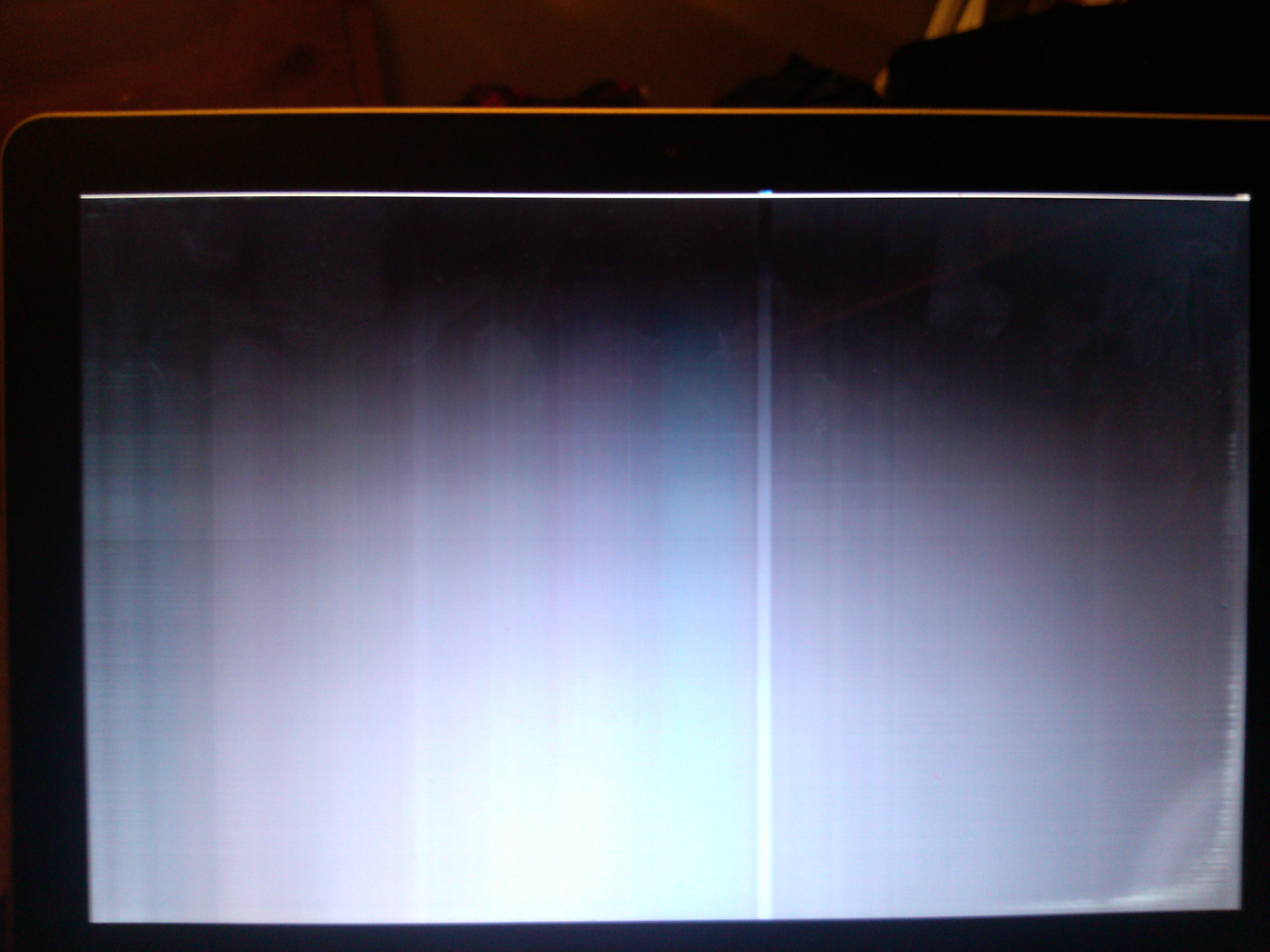

I've got the same problem. If I apply force to the left of the "Macbook" writing, the lines disappear.
I know that the problem is almost never the LVDS cable and I've already been told to replace the panel. But I don't like to throw away things that have the potential of being easily fixed.
Do any of you guys know where exactly the problem lies? It seems to be connected to the LVDS cable connector on the screen panel itself. Is it a failing solder point that's potentially fixable?
The lines on my screen aren't as bad as on OP's one. Here's a picture, but it's gradually getting worse.
