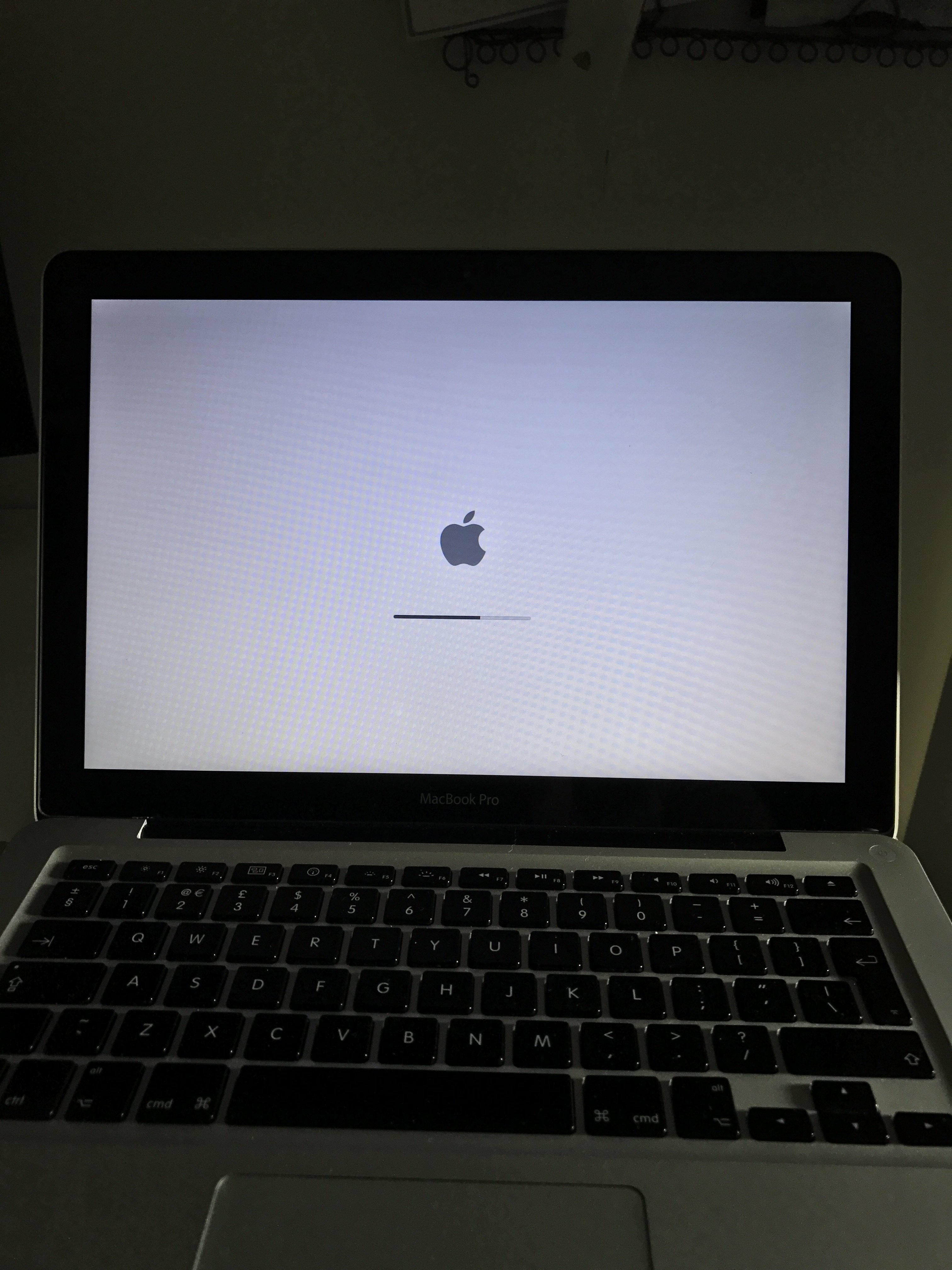

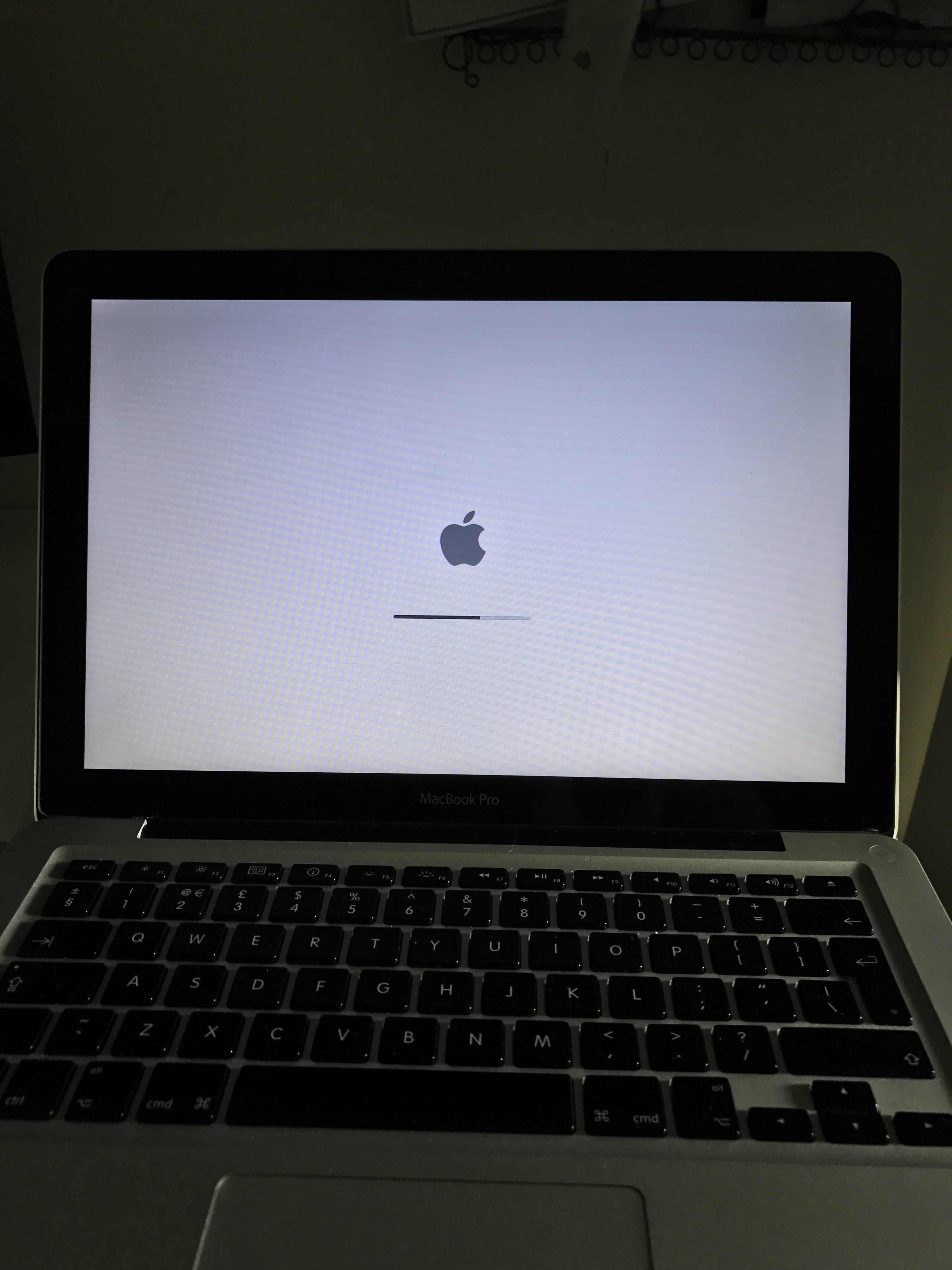

CoastalOR - Thanks for the response, I managed to get an El Capitan boot image onto a USB from my main Macbook, but now during the install it, it freezes out around 60% of the way through! (Screenshot attached) Could this purely be related to the image i've downloaded?
Appreciate the guidance,
Ben
Tell me more on how you created the USB installer. Normally the installer is created using the "Install OS X El Capitan" app using createinstallmedia in Terminal or the DiskMaker X app. I'm not familiar with using a "boot image". I suspect a problem with the creation of the USB installer or the downloaded "image".

I previously ran into this problem with certain SSDs in 2008-2010 MacBooks. It seems the SSD controller is incompatible with the nVidia Nforce chipsets in the 2008-2010 MacBooks. The 2011 and later have Intel chipsets.
If you have access to a different SSD or later machine, you can probably pinpoint the issue.
Here's a post I started, there are some good links from other members about the issue,
https://forums.macrumors.com/threads/corsair-force-le-ssd-incompatible-in-some-mbp-models.1988942/

Sorry, purely meant the OS by boot image, work wordage. To create the image I used the DiskMaker X app, although I couldn't find this in the App Store, only Mac OS Sierra?
Cheers for this, i'm trying to use a Crucial SSD which they did state was compatible, but will do some digging.

Another quick update, managed to get hold of El Capitan from my Purchased items, tried installing this but again stalled at the same point. Left overnight and was still stuck in the same spot. I've got a keyboard coming for my Mac Mini early next week, so i'm going to try the same installer and see what results I get to help determine the issue.
FYI - This time I created it using createinstallmedia
