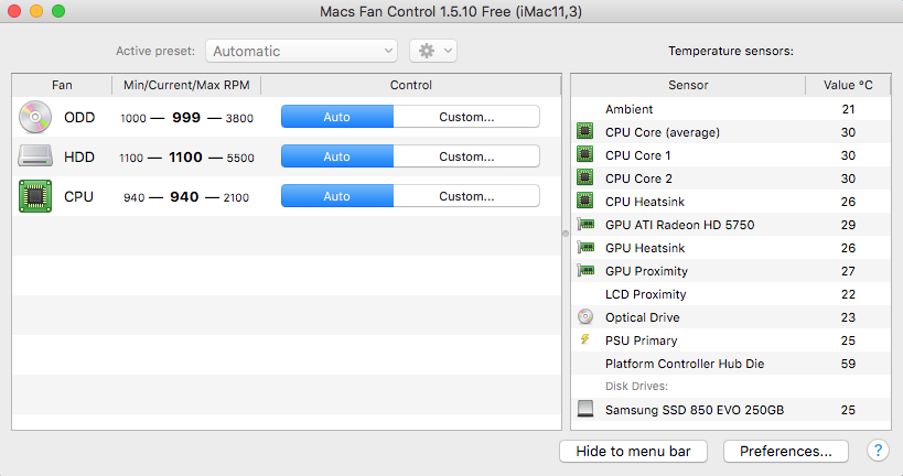

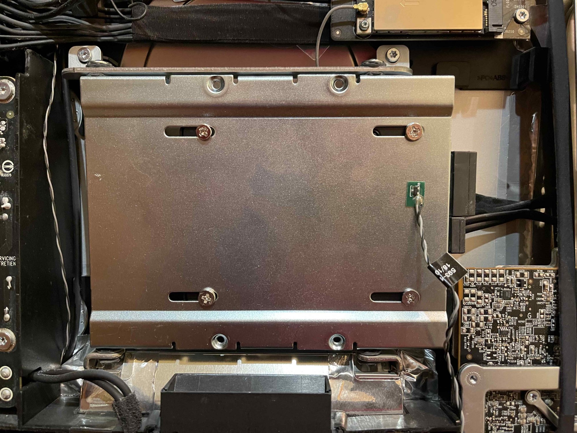

This is my 2010 i7 iMac, but it's the same idea.
The optical drive temperature sensor cable is in place of the previous hard drive temperature sensor cable. Note that I have attached the sensor end onto the 2.5" to 3.5" adapter bracket. (Technically it should be attached to the SSD itself, but I did it this way because it doesn't really matter that much, and this allows me to remove the SSD in the future if necessary, while keeping the cable in place.)
I am not using Macs Fan Control, but I installed it temporarily just to confirm that the SSD temperature reading (bottom right) was working, using the optical drive temperature sensor cable. I promptly uninstalled this app after taking the screen grab. Note that the fan control is on 'Auto' (ie. no fan speed intervention from this app) but the HDD fan is running at minimum speed in line with the low temperature reading.

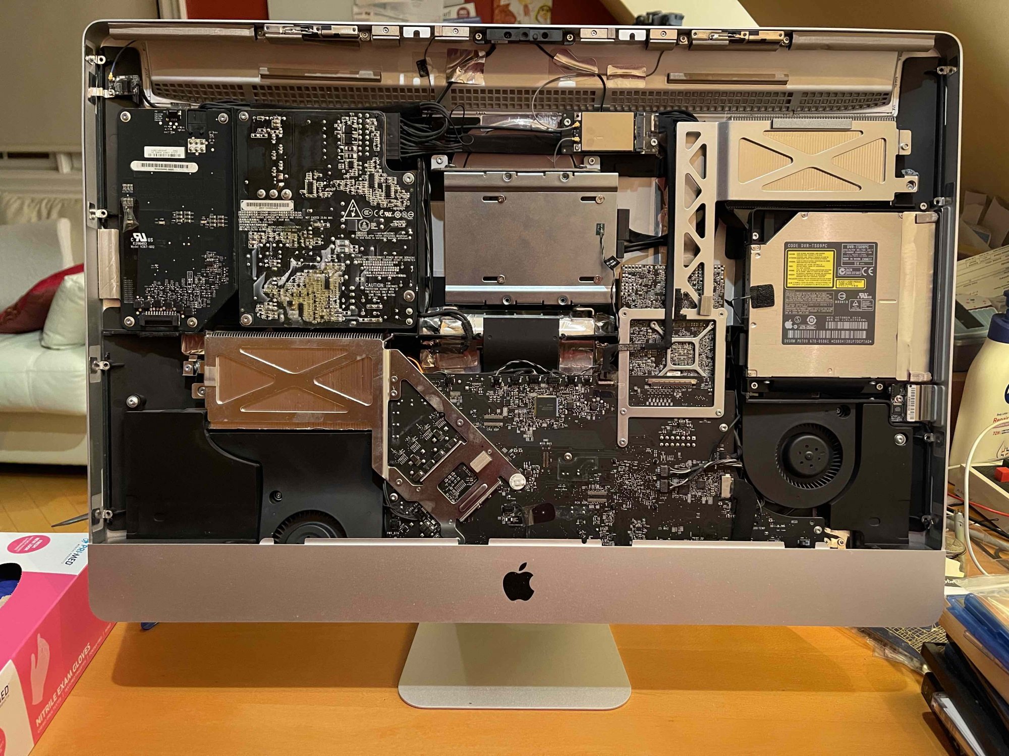

I have an Core2Duo 27" Late 2009 that is now mainly used as an external monitor. Put a small cheap SSD in the Optical Drive bay, as that does not require disconnecting the LCD panel, just lift up the top of the panel and put some chop sticks or similar to keep it lifted while you do the quick swap. Even with the ancient Core2Duo processor, it is still usable also as a basic web browsing computer. Though for that I have a loaded Mac mini 2018 with a 38" wide screen.

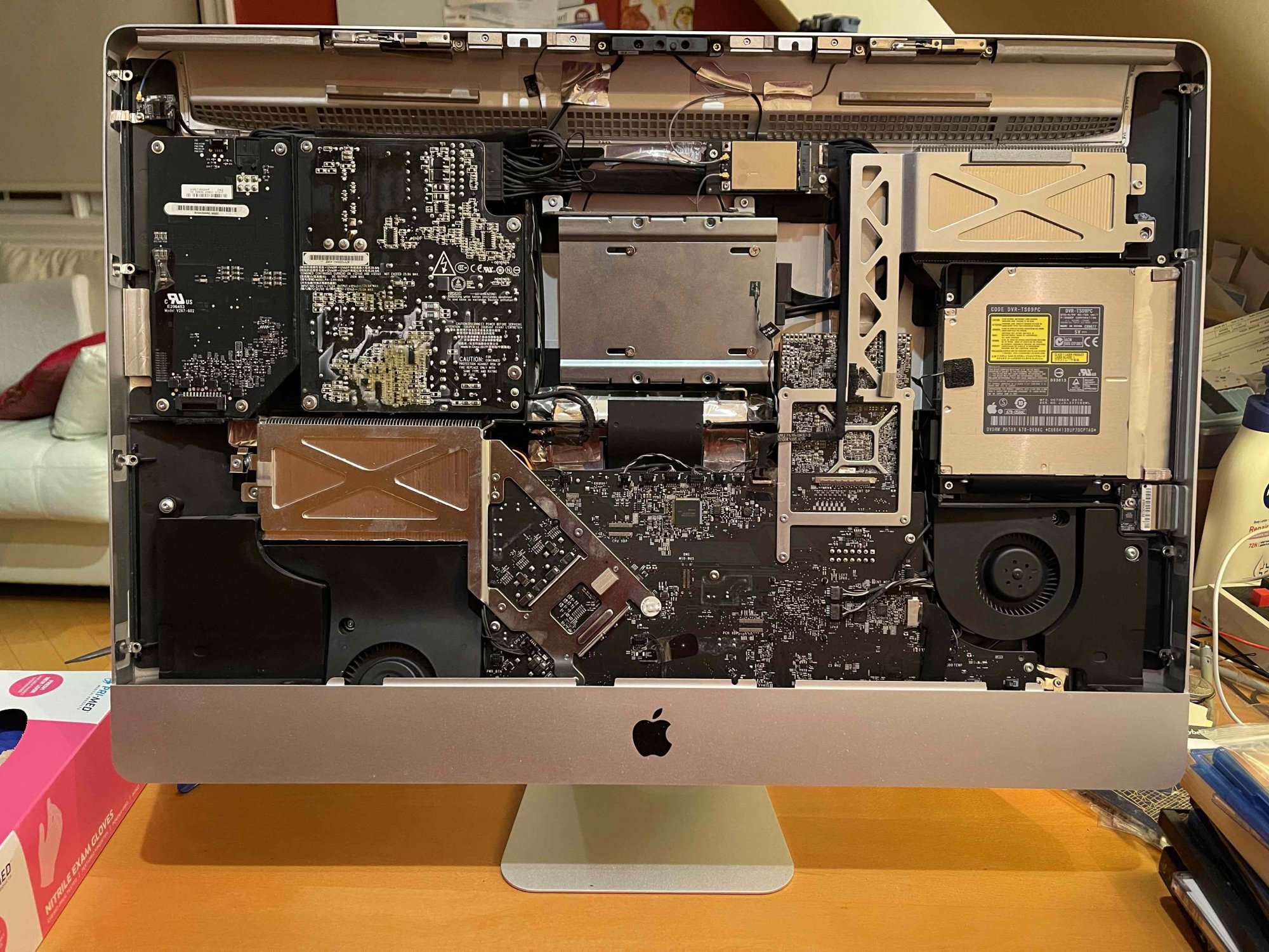

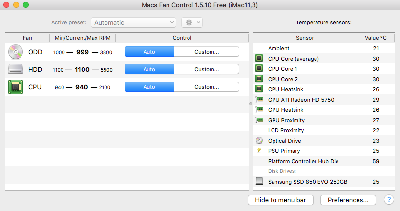

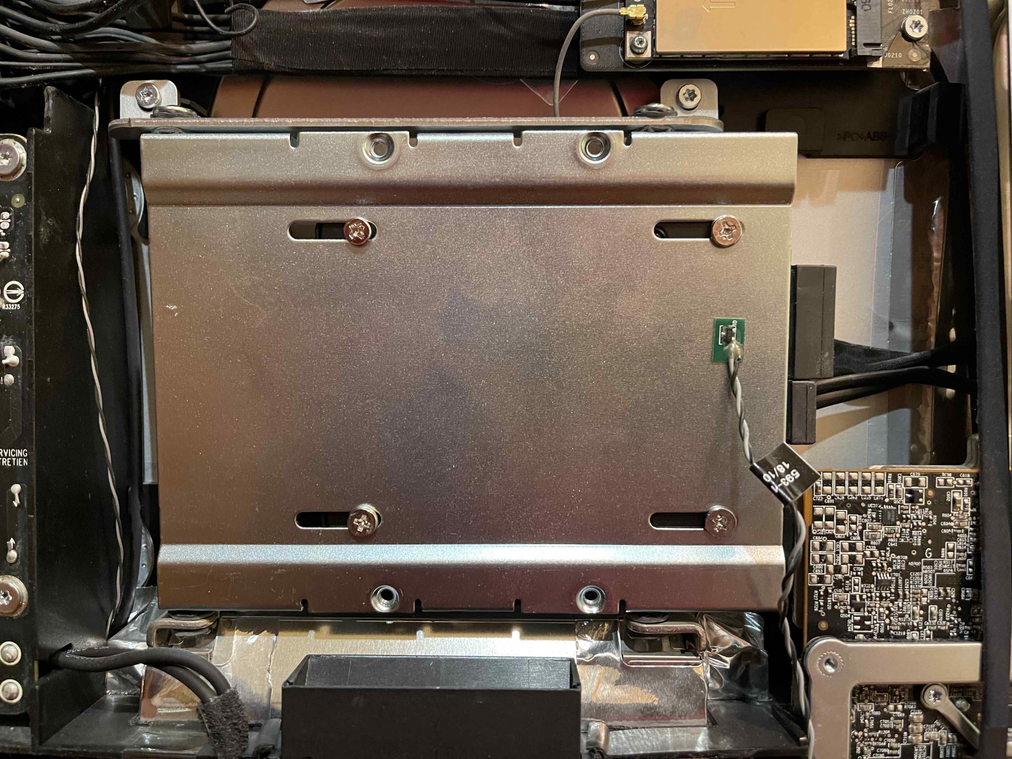

I've seen someone on YouTube replace the hard drive with an SSD without removing the LCD panel. Same idea as you. He wedged a box in there to keep the LCD lifted while he did the work.
I thought about doing this but it was too awkward and my screwdrivers were too long to fit properly, so I removed the LCD panel.
