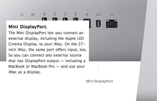

Hi, I own a late 2009 Apple iMac and have had two additional monitors connected but for the past year have had an issue with the display link software on the adapter which has meant I've lost the use of one of my monitors for over 12 months.
My iMac has one single Thunderbolt port (old port). Is there any adapter that I can add to the iMac to enable me to add a 2nd port which in turn I can then get an adapter to connect the 3rd monitor??
Any help or advice would be gratefully appreciated.
Did they have Thunderbolt ports back then?
I’m sure mine only had FireWire and MiniDisplayport options (in addition to the usual USB, Ethernet, etc.).
