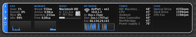

Here are the iStats of my iMac.
Even after turning off my iMac all night long, the fan speed will be very high after I boot up.
I have another iMac (same model) that is always quiet. WTF?

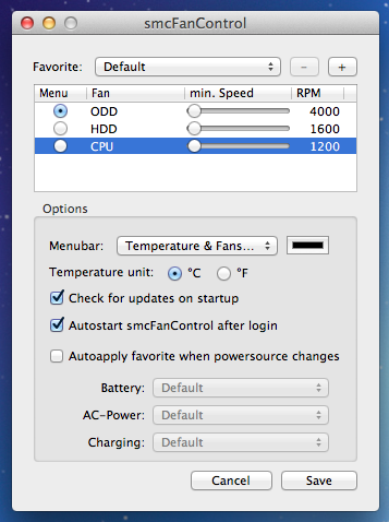

I tried using smcFanControl but it does nothing.
Yes I have tried SMC reset. No luck. Even when I put it in sleep mode, my fan stays on. 🙁

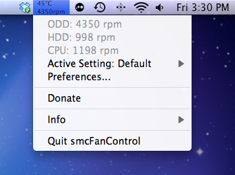

It seems to be my Optical Drive Fan that is running at 4,348 rpm.
That is what it says in smcFanControl v2.3

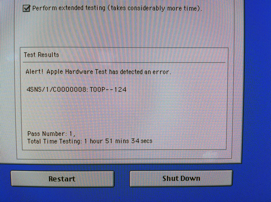

I was able to get into AHT mode using the Snow Leopard Application install DVD. The extended test was taking way too long. I will do it tonight before I go to bed and post up the results in the morning.
Update:
I got a temperature sensor error after completing the AHT.
4SNS/1/C0000008: T00P--124
My iMac is out of warranty. What can I expect to pay to have it fixed by Apple?
Could I just purchase the sensor and replace it myself?
If you feel comfortable to open up your iMac, then yes, it's doable. You need to remove glass and LCD. Sensor is bundled with cable AFAIK (ask seller before buying to be sure), for 21.5" you need part number 922-9214, for 27" it would be 922-9229. It costs few dozen bucks.
Is there software that I can use to adjust the fan speed for the optical disk drive?
I keep reading that smcFanControl is the best program but the minimum fan speed for my ODD is 4,000rpm? WTF?

So at this point, my only option is to install software to slow down this fan. The only problem is I cant find anything that has control over the ODD fan.
I'm afraid that no software is able to control this fan when its sensor gives wrong info to the logic board (i.e. fan is working in kinda "emergency mode").

There are a LOT of different things that can cause the fans to go full blast, but it ultimately boils down to the system either thinking that something is overheating or the system not knowing the temperature and running the fans to be safe.
From the OP's iStat picture, it was clear that the optical drive temperature sensor was acting up, since it wasn't in the list of temperature sensors. Granted, it could still be the logic board itself not seeing the sensor correctly.
