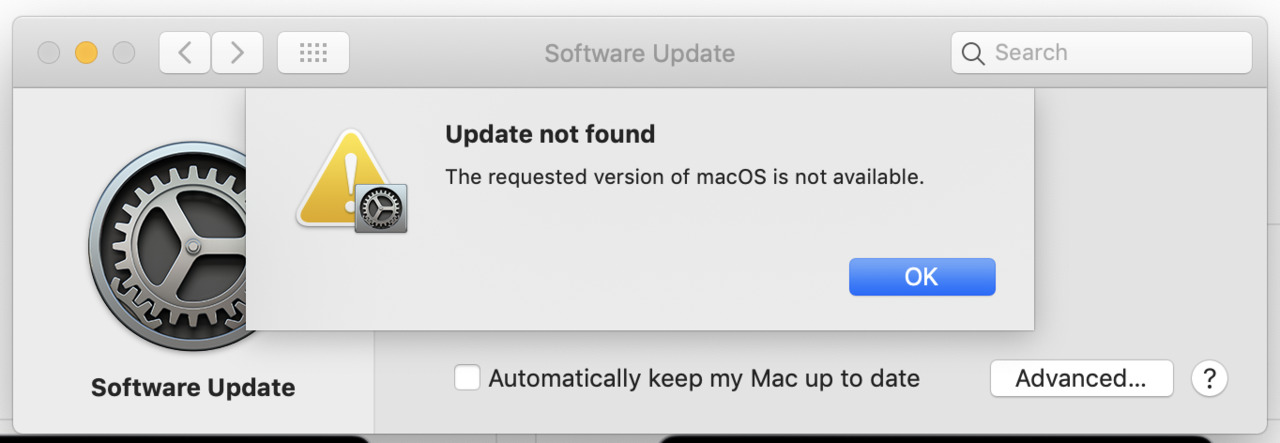

This sounds like fantastic info, and I was super excited to try it, except that I can't even seem to get Low Sierra to download.. I get this
tumblr_pshb08BjcS1qzpf9do1_1280.pnj
If you can't get a copy of the version of the OS you need from Apple's official channels...
Well... all I can tell you is...
... There are OTHER WAYS to get ahold of it... 😉

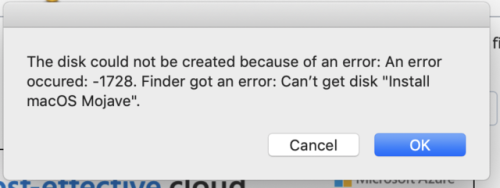

UPDATE: Well I was able to secure a copy of Mac OS Sierra installer, but now I'm unable to get disk maker x to work.. Getting an error every time, and it's not an error that's even listed in the FAQ on the diskmaker website..

I moved the installer app into the Applications folder once I received it. Despite not coming through.. (Ahem) the appropriate channels, it IS the official Apple installer and its like 5.**GB. It was received from a reputable source.
"I moved the installer app into the Applications folder once I received it. Despite not coming through.. (Ahem) the appropriate channels, it IS the official Apple installer and its like 5.**GB. It was received from a reputable source."
ok, understood.
You're trying to create this on the 2019 iMac, right?
Is it running APFS?
I'm wondering if DiskMaker X is having problems because of this.
One other thing to check (you probably did already):
Are you using the correct version of DiskMaker X?
I believe the version that works with Sierra is properly linked in my post above.
If that doesn't work, just for the heck of it, I'd try LATER versions and see if they worked.
If that doesn't work, I'd try to use the terminal to create the flashdrive.
Instructions for doing that are available on the net.
Another thing to check:
What format is the USB flashdrive in BEFORE you address it with DiskMaker?
I would first erase it to Mac OS extended with journaling enabled, GUID partition format.
Hope this helps.
