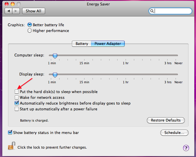

I recently installed an OWC 240GB SSD (340A13F0 firmware) in my Late 2008 Unibody MacbookPro and was having similar issues. The computer would not wake from trackpad press (had to use the spacebar or enter key) and when it did wake, the wifi icon in the menu bar would freak out and search for for home wifi network but not find anything. Any applications clicked would not launch and hitting the Apple icon in the menubar did nothing.
Unchecking the "Put the hard disk to sleep" mode has seemed to resolve the problem for me. Obviously this works because the hard drive never shuts off and thus the computer never goes into hibernation mode. Like others here, I'd like a better solution but this seems to do the trick.
System Preferences > Energy Saver > Uncheck "Put the hard disk to sleep when possible".
