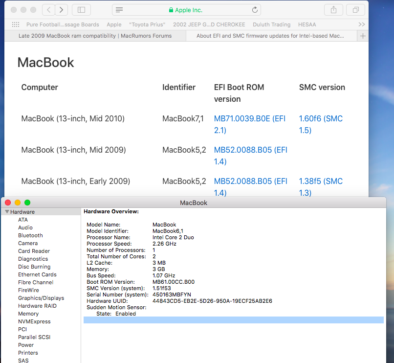

There seems to be no updates listed for this MacBook

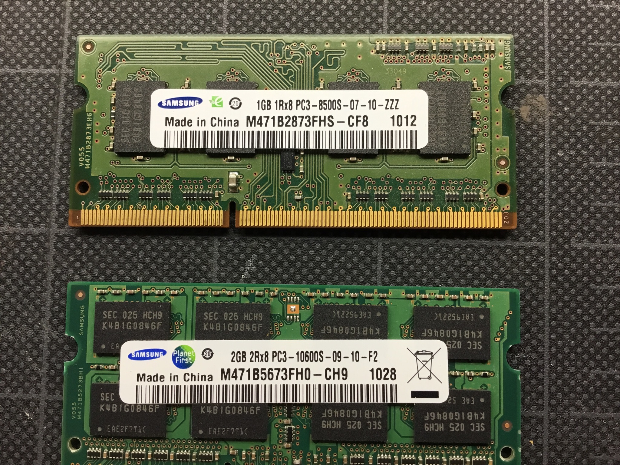

The ram pictured in the op is not the ram I’m using. That is a photo of the ram I had the opportunity to buy.
It would help to know what RAM you're using.

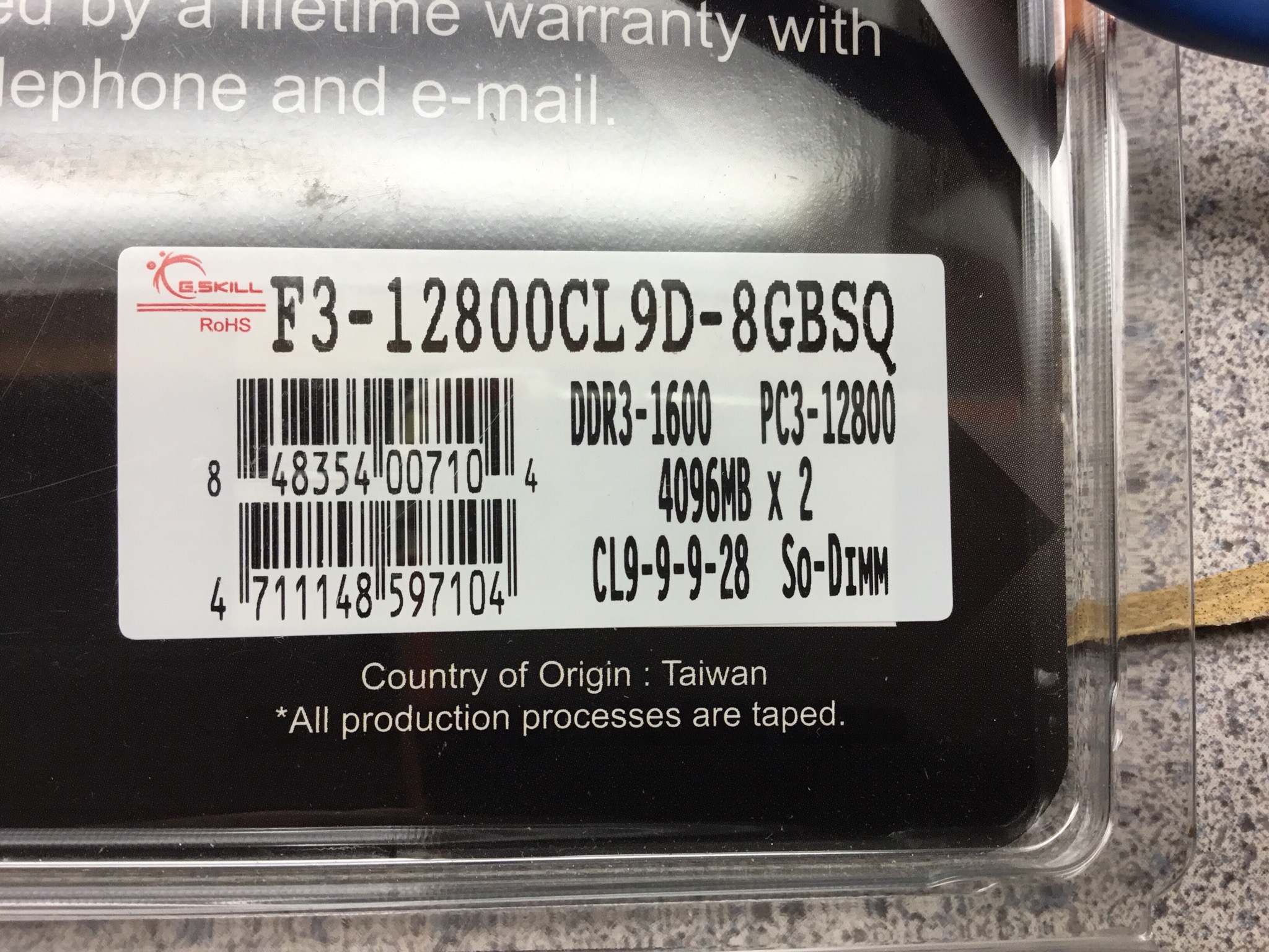

Here is a photo of the currently installed ram. 2gb+1gb. I have also attached a photo of the type of ram I’m using in my Thinkpad L412. That ram is also a no go in the MacBook.

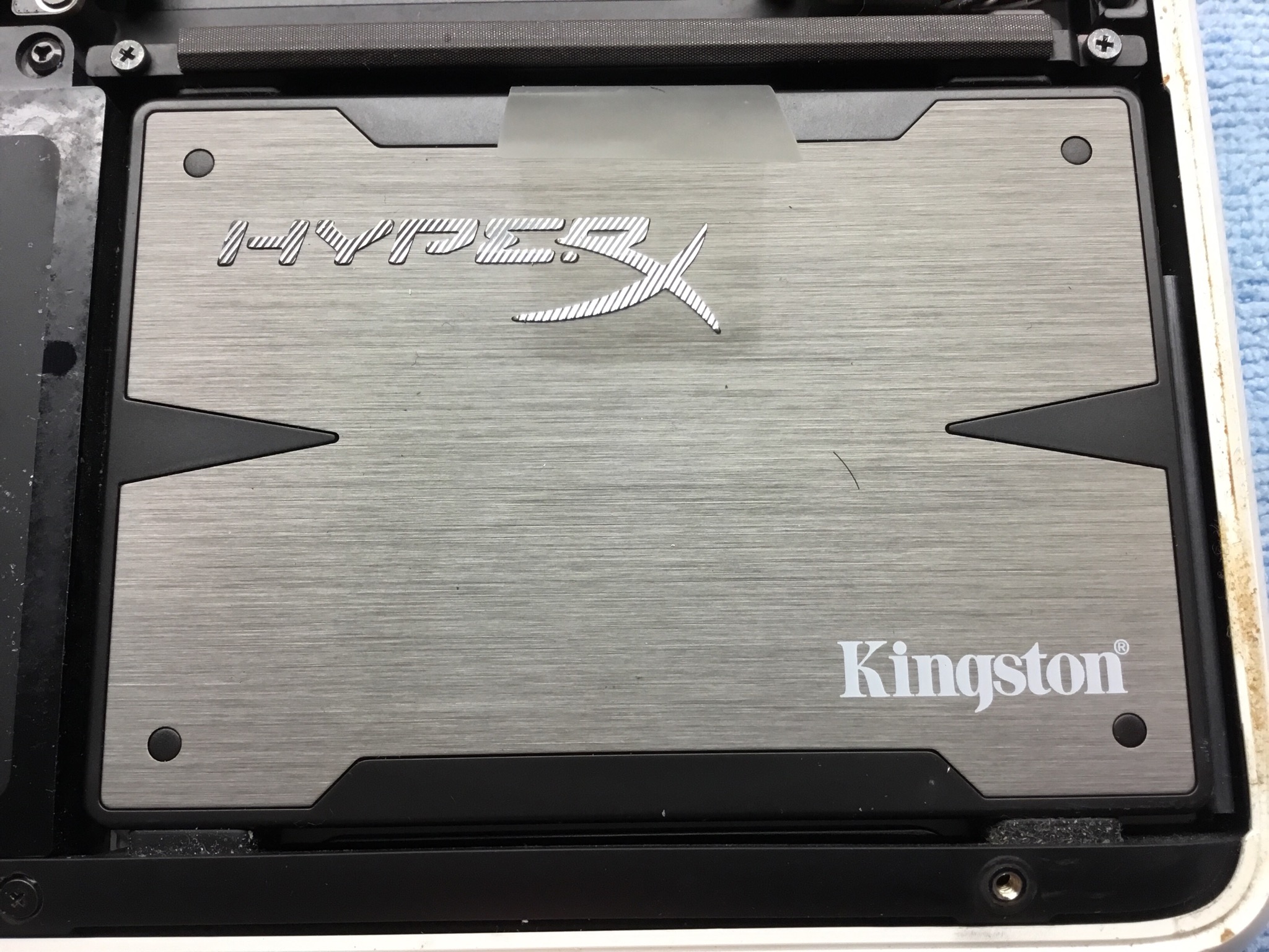

Including a photo of my ssd. This works just fine.
Fast RAM should clock down for a slower speed memory bus, but that does not always work, or does not work reliably - which is kind-of the point for installed memory. It's much better when you don't have to think about the memory!
That g-skill RAM (from your ThinkPad?) is a step or two faster than what you should expect to work in your 2009 MacBook.
If you want to upgrade, then get memory that you can expect will be compatible. One level up from factory specs will probably work. Faster memory is less likely, and that's what you are running into now. Look for: PC-8500, 1066 Mhz, or PC-10800, 1333 Mhz, DDR3 SO-DIMMs
DON'T get the low voltage (with the L designation). DO go to Crucial and get the stuff that works (assuming you want this to work 😀 )
OWC has the right ones, too... https://eshop.macsales.com/item/OWC/8566DDR3S8GP/
The only RAM in those pictures that is appropriate for the MacBook Pro is the 1 GB RAM.

Don't forget the CAS timings. The 2 GB and 2 x 4 GB RAM pictured have the wrong CAS timings. Too slow. Required is CL7. Those are CL9 from what I can tell. They might be able to run fine at PC3-8500 CL7, but if a RAM stick isn't configured as such, the RAM may not won't work in a Mac.
He's lucky that the 2 GB RAM works. I wonder if it would work by itself though, not paired with the 1 GB RAM. (The 1 GB stick appears to have the right specs.)
